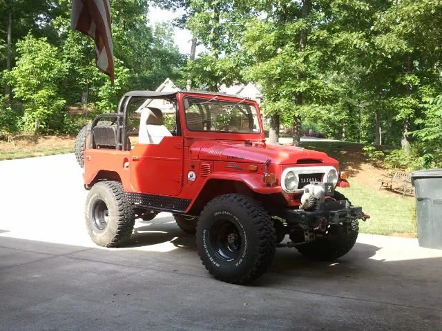

I didn't get to mess with the skid plate today but I made some progress on the other truck - and cut the grass.
Sent from my thing with Woody's junk.
what did you do?
New passenger front tire is what the pic is of. IT'S SO CLEAN LOOKING (tire)
