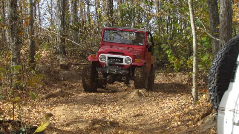

It was good meeting you and wheeling together. Hopefully you didn't do any damage with the skid plate.
I didn't. It was just banging on the U-Joint. The Maul fixed it. I really need to get that IPOR one straight.
