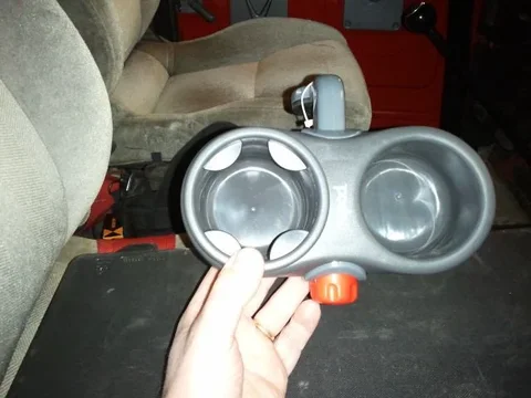

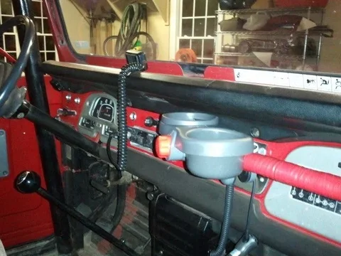

Picked this up at Bed, Bath and Beyond while shopping for a new comforter with the wife.
It was $13 and will clamp to about any horizontal surface. :beer:
:D:D:D:D:D:D:D:D
this is one time with lying on mud is ok... :flipoff2: what you do on your "own time" is none of our business......... :D:D
