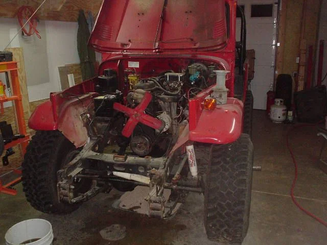

Well, I think you guys might appreciate this because you know me and as of yet have not seen my 40 and may think I only come to the meetings to drink hundreds of beers. I have been working on the rig as much as I can with the crazy work hours but it is getting there.
I bought this '71 40 with a 4 speed and a 4 inch lift running 35"s about a year ago in Knoxville off E-Bay and know a lot more then I did then...enough to know I was not hosed or taken but paid too much.
I got it home and discovered the oil leaks in the engine were not just that. I never bothered to check the compression becasue I started it one day and it blew oil all over the wall.

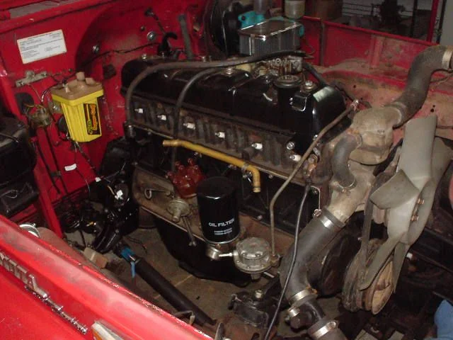

So I cleaned all the oil off and found a rebuilt 2F from a friend for about $700 and jumped on it.

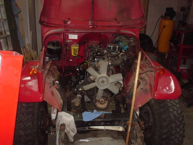

After some work I got the F out with a little help

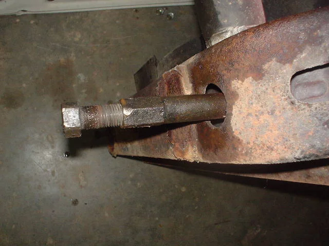

First I had to drain the radiator, however and discovered this was left by the PO (staged after it was removed BTW):

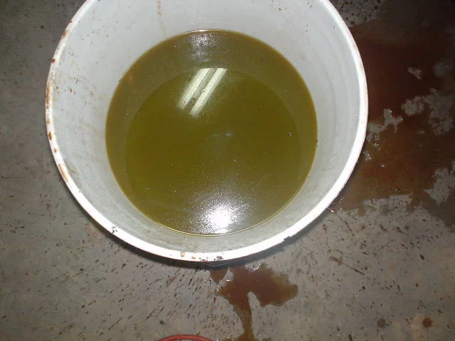

Once the bolt was out and I dug around in the hole a bit I got a bucket of this (probably explains the over heating):

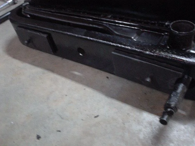

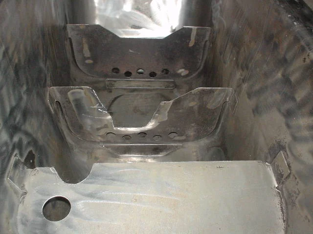

I modified an F oil pan to replace the one the 2F had been resting on for over a year:

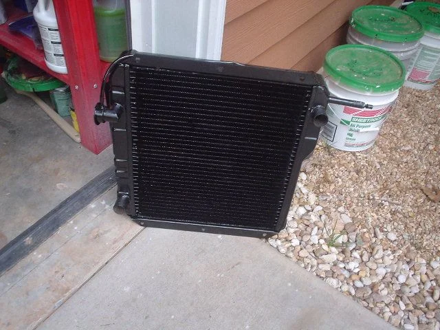

and I got my radiator cleaned and repaired as needed for $35 here in Rome.

And right now the "new" motor is in and the tranny/Xfer case are attached.
Here is a pick of the moor after I had put on my new improved oil pan:
Followed Poser's instructiond for puting on the side gaskeet and oil pan gasket in the 40 section and it worked great...well I will know for sure once I try to start it!

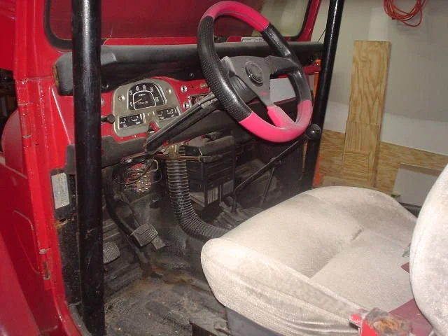

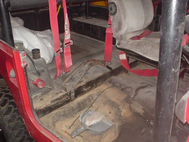

Here are a couple random interior pics:
Not sure what those seats are out of and not sure I like the mounts either. PO welded them out of square tube and diamond plate. I got some free stock '78 seats on the board and they are stored in VA at the folks house right now. Not sure If I am going to save those for :princess: 40 or not.

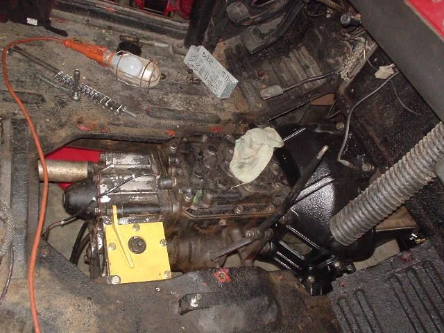

So, as promised, pics of the "new" 2F installed and a semi-clean XMSN and XFER case.
Note Poser's XFER case saver. All the cool kids have 'em:bounce2:

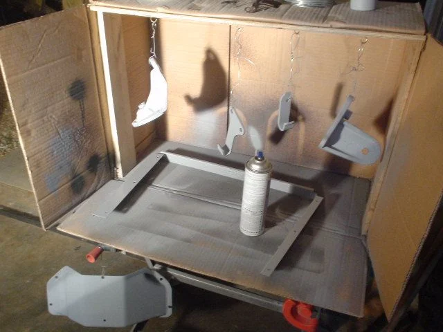

i think i'm most impressed by this make-shift spray booth. :D

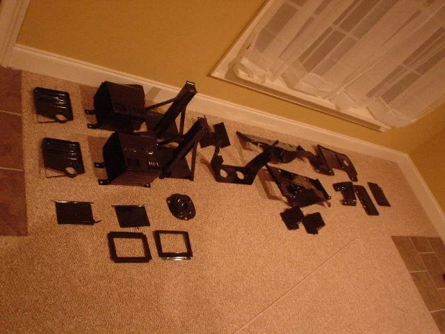

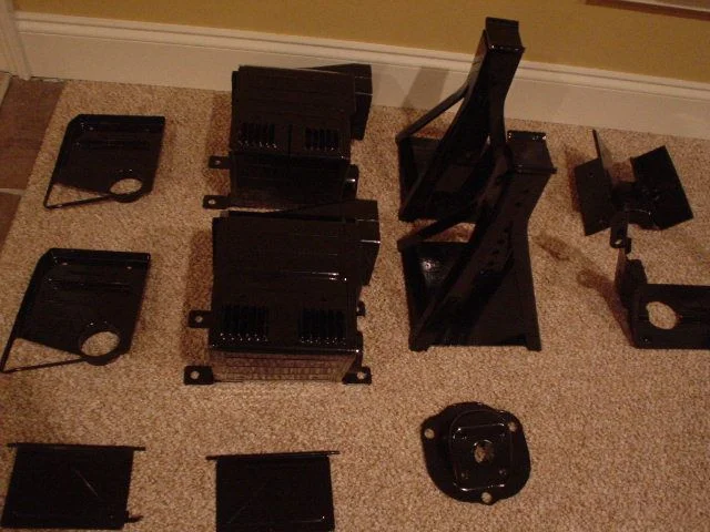

I was able to slide by Sean's place and pick up the powder coating he got done for me at what I would consider to be a very reasonible price (since most places would have charged me for each peice what I ended up paying for the whole kit-and-kaboodle!)
Let the drooling begin:

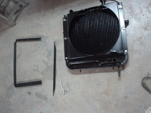

The other thing I did was get the radiator back in place.
I bolted it all back together with new hardware on the floor:
If you notice, the shroud is upside down and I had to take it apart and turn it over. LOL!

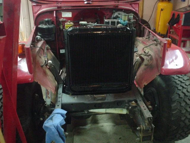

So here it is back on the truck. I was unable to get it all together becasue I discovered I did not have any 5mm washers or split washers.

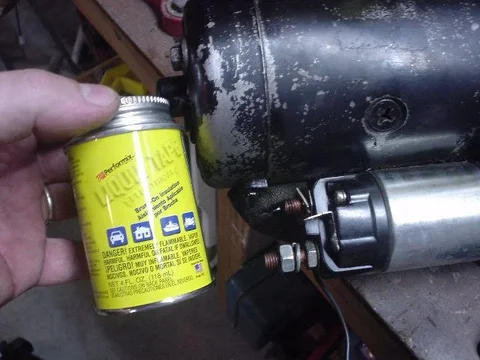

The other thing I did was hang the starter back in. Now, I discovered that the large wire going from the starter to the solenoid was no longer insulated due to oil and heat and I stripped off what was left, cleaned it with brake cleaner and the painted it with liquid electrical tape:
It was a good solution I think.
