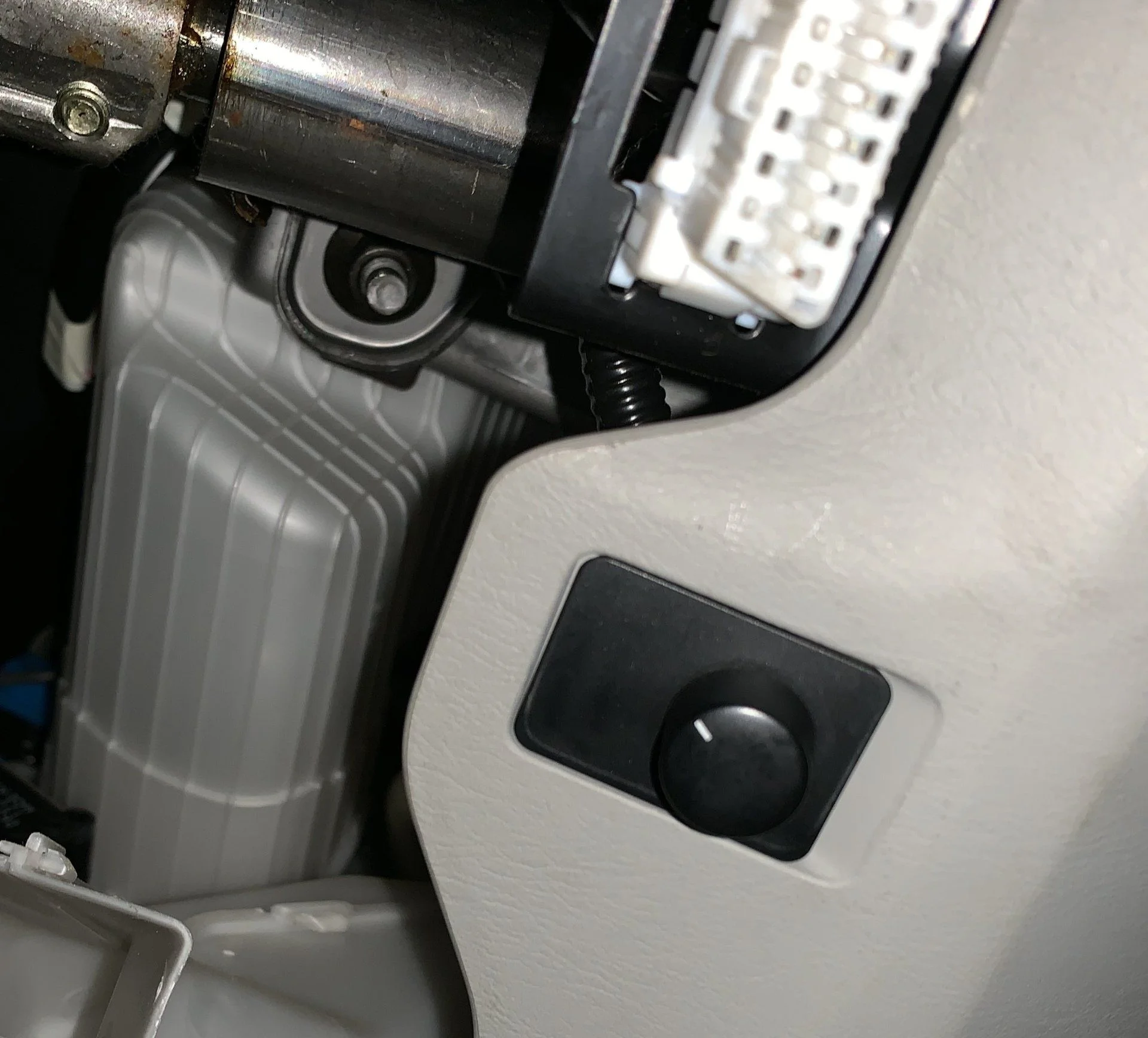

Also, saw this knob next to OBD port. What is it?

Quick googling reports that the knob controls the lock beep.
