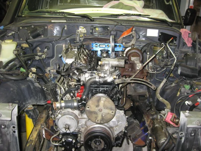

Here are a few shots of my install. Some of the measurements you may be able to figure out from the related parts, ie engine mounts, etc.
Hope these help.

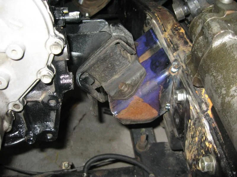

OK, here are some measurements:
The rectangular steel tubes I used is 3'X6"X3/16" with 43 degree cuts. The long point to long point top measurement is 5.5" for both sides.
The valve cover to firewall flange/stiffener is about 2.5". It is hard to see and measure with the heater hoses and intake pipe in place.
Engine to frame dimensions:
Inside frame to oil pan flange in front of stock engine mount:
Drivers side - 8"
Pass side - 8.625"
Let me know if you need more measurements.
Doug

Doug, got a silly question for you. The two bolt holes on the factory motor mounts, are they in line with each other or is one hole lower than the other? When I marked them on the frame mounts to drill holes, they didn't line up. Just wondering.:)
Thanks,
Ryan
I don't recall, but I will check my other engine tomorrow.
Depending on how the motor is positioned, many times the engine is placed parallel to frame rails. Stock 60 are not straight in the frame and off the one side too. If this is the case, it would explain the hole layout.
When I did mine, I scribed the motor mount holes then removed the engine to drill and finish welding the frame mounts in.
How did you locate the trans mount? Did you use the stock trans mount?
Doug

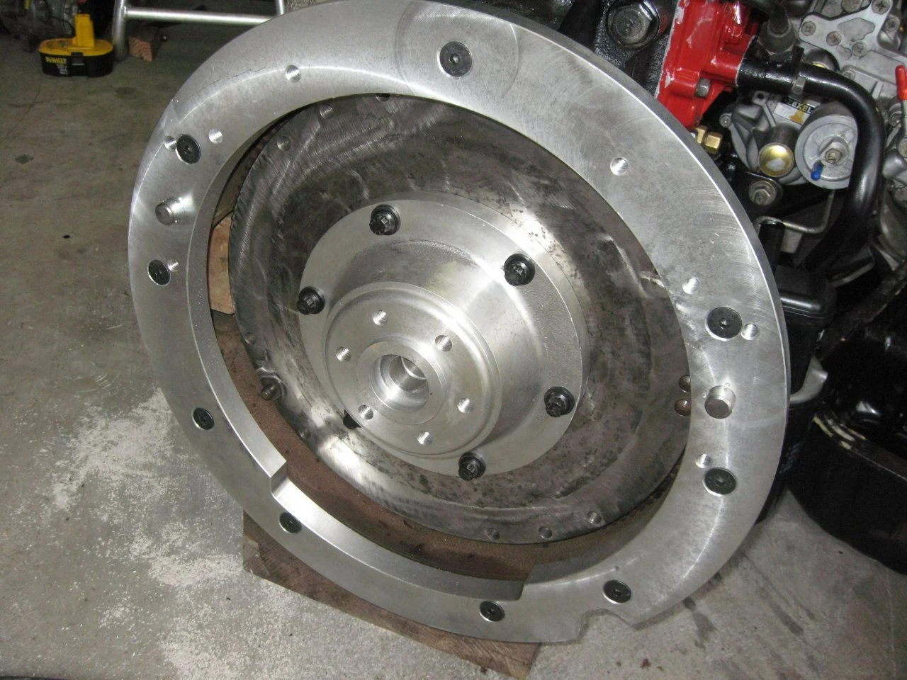

Great job Doug! Both on your Toyuzu and will all the information posted here on Mud. Thank you for taking the time to make all these posts. I am in the process of making my 60 a Toyuzu! 4bd1t and Nv4500 purchased and mated together. Getting ready to remove the 2f and get my 4 in lift on the truck. I'm sure I will still have question even will all the information posted here and on 4btswaps.

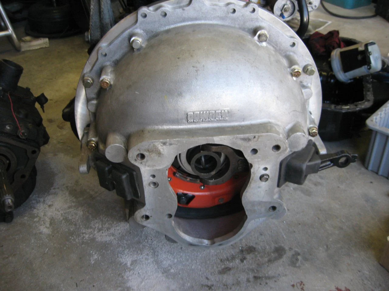

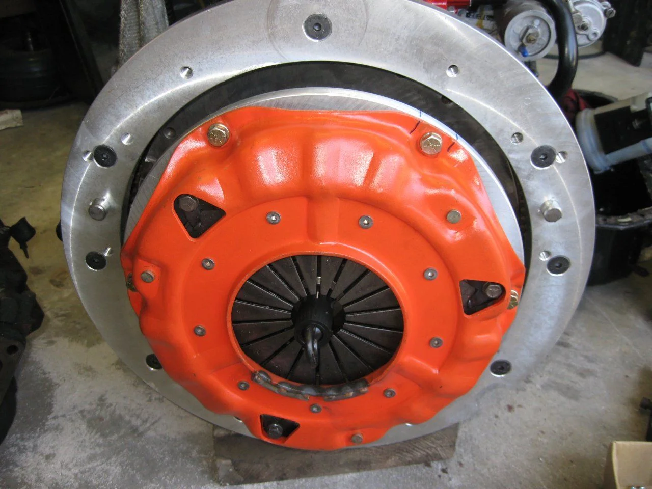

Here is how the bell housing and dual flywheels looks.
Let me know if this helps

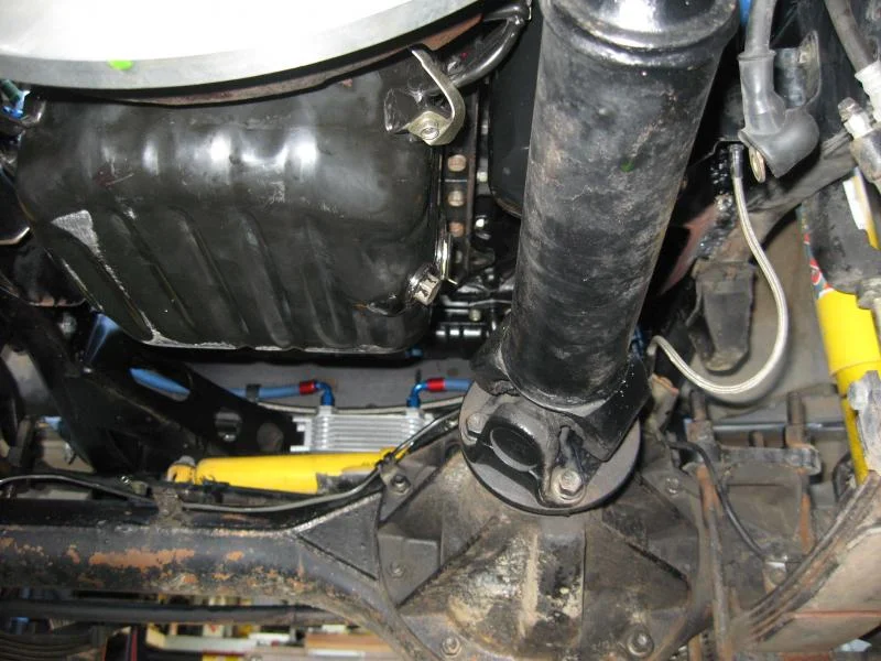

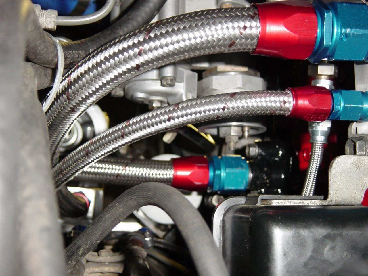

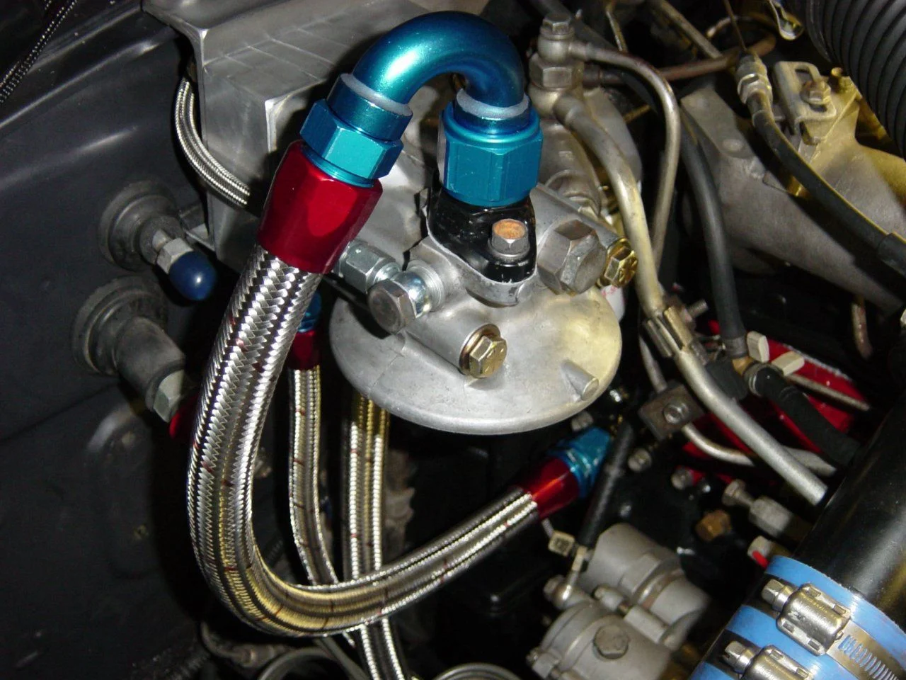

Doug, did you have all of your oil lines specialy made? Are they really braided or slip on covers? Getting close on finishing my project up.
They are real SS braided lines, I bought the hose and fittings and made them up.
I used Earl's as they have a store close by. It's easy to do, just use tape and a cut off wheel to cut the hose. I use a drill bit that fits tightly inside the hose to guide the inner ferule. I have about $120 in all the hose and fittings. I did all the engine oil lines and PS pressure line with same hose and fittings.
These are bullet proof lines that should last for years, and if required, can be removed and replaced easily.
ope this helps.

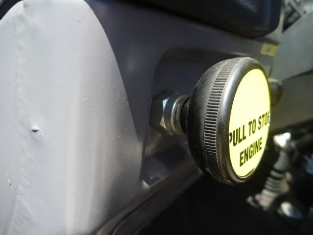

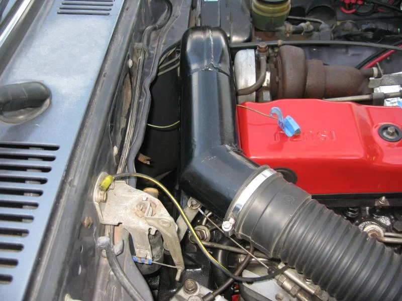

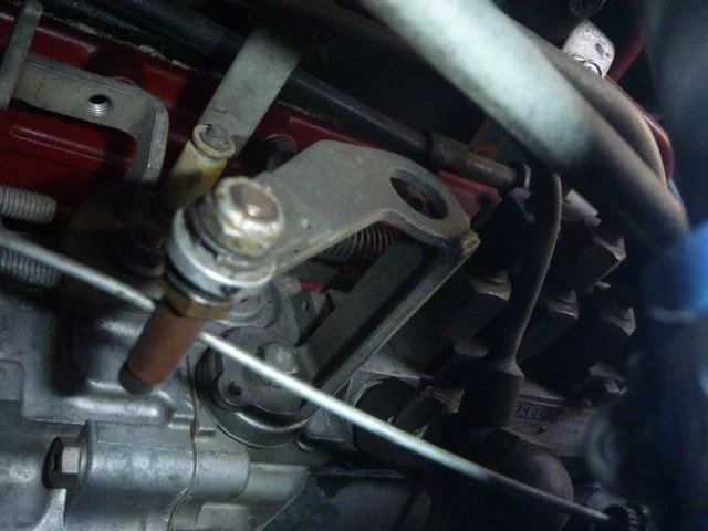

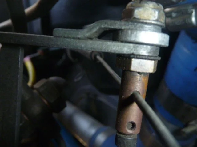

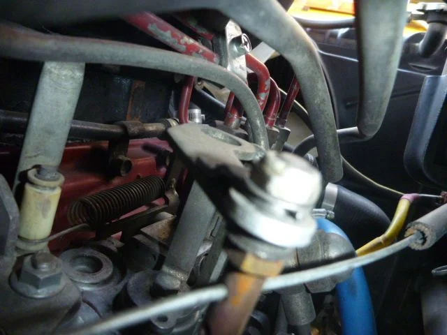

Here is how I made my manual IP pump shut off cable to stop the engine.
On the manual shut off. I used a PTO cable I bought on line for about $20-25.00. I installed the cable in the old choke location on the dash and ran the cable through the stock choke cable hole in the firewall.
The cable routes in front of the radiator on mine, but I have an inter-cooler that mounts between my rad and AC condenser, and my rad is spaceed back from stock about 5 inches. You may have to route yours differently.
The cable is connected to the shut off arm with a Morse cable end - threaded stud mount wire cable end. These are available at marine supplies - West Marine, etc, or on line - search for Morse cable fittings.

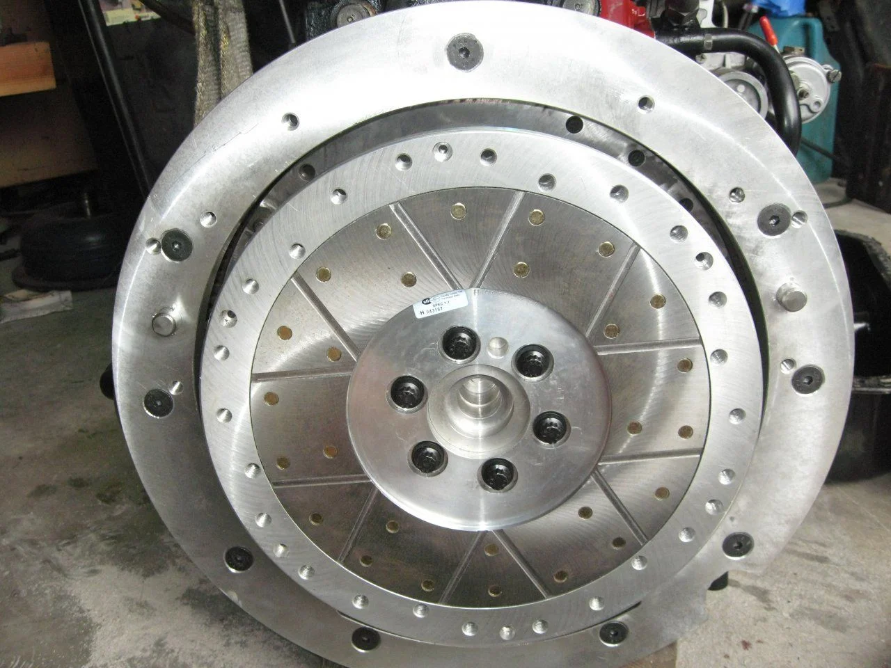

I am making a couple of changes this time to the flywheel. My set up runs 2 flywheels to allow the use of the H55 and keep all the driveline stock and in the stock location. It uses a Downey "Chevota" bell housing mated to an IDS adapter ring on the back of the Isuzu to make it a Chevy bolt pattern.
What I have now is the manual Isuzu flywheel with ring gear that the stock 4BD2 starter turns to start. To this is an aluminum adapter (IDS) that bolts to the flywheel that the second flywheel is bolted to. This second flywheel is what the clutch operates on. It all works well, but I have discovered that these engines like more flywheel weight, and for the second flywheel, I had used an aluminum flywheel. Did not know at the time that extra weight was a good thing!
This time, I am using the cast iron Isuzu automatic transmission flywheel, a new steel adapter that locates on and bolts directly to the crank. Then I have a forged steel Hayes 33 pound flywheel. This will add about 28 pounds to the rotating mass, which is very good.
I have a new 12" Chevota pressure plate and disc, plus a new stock throw out bearing.
The machine shop is going to balance the crank, piston assy's, rods, both flywheel's and adapter, plus the clutch as one unit. These are pretty smooth engines to start, so I'll see what happens when its all balanced.
