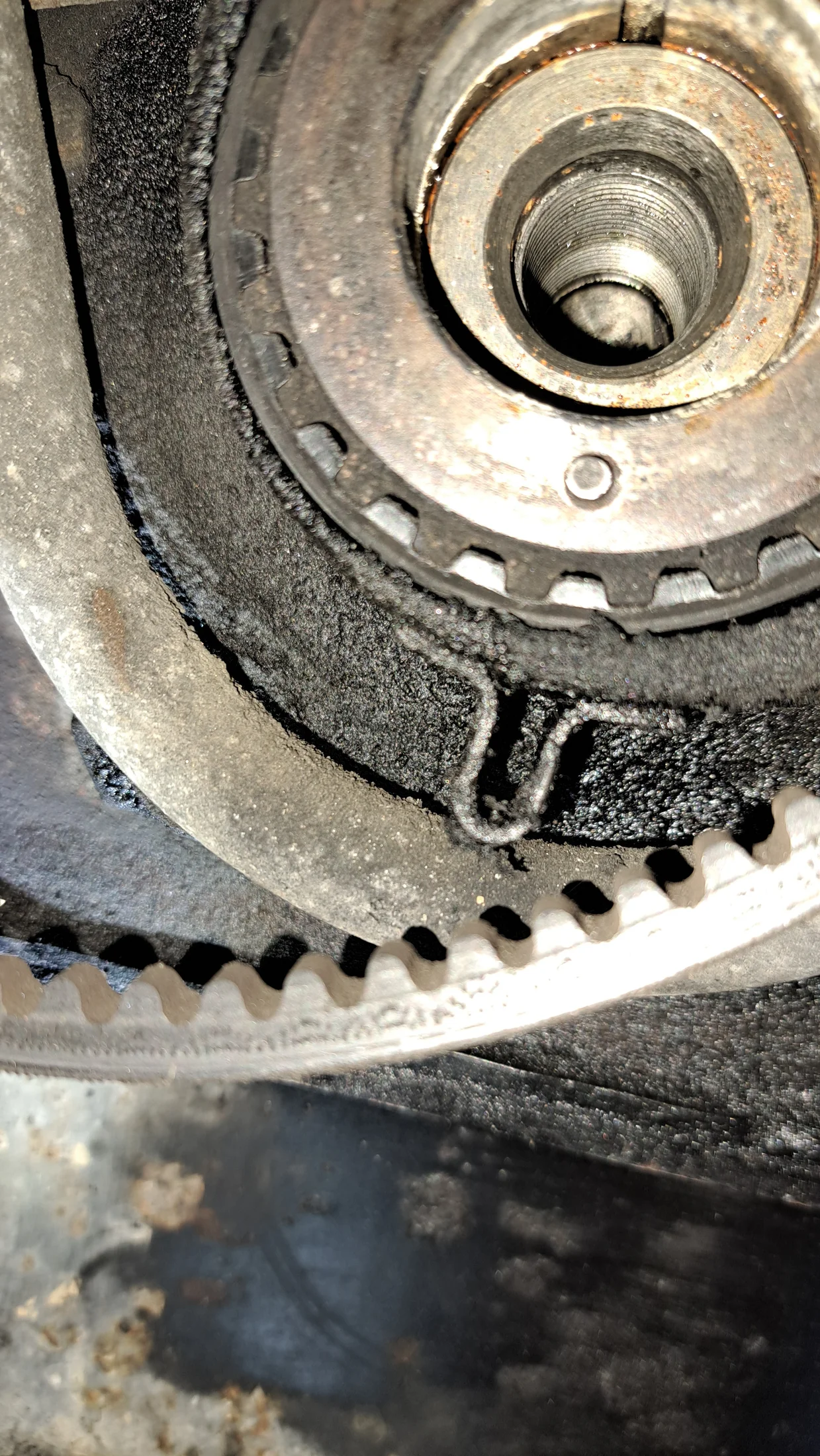

So, my first timing wrestling with the 1HD-T crankshaft pulley / harmonic balancer bolt. It's kicking my ass.
I tried bumping the starter; disconnect fuel cutoff solenoid, long breaker bar. Starter doesn't have the guts to break it lose.
I then proceeded to snap my SST #09330-00021 in half doing it the way the factory manual recommended.
Thoughts? Suggestions?

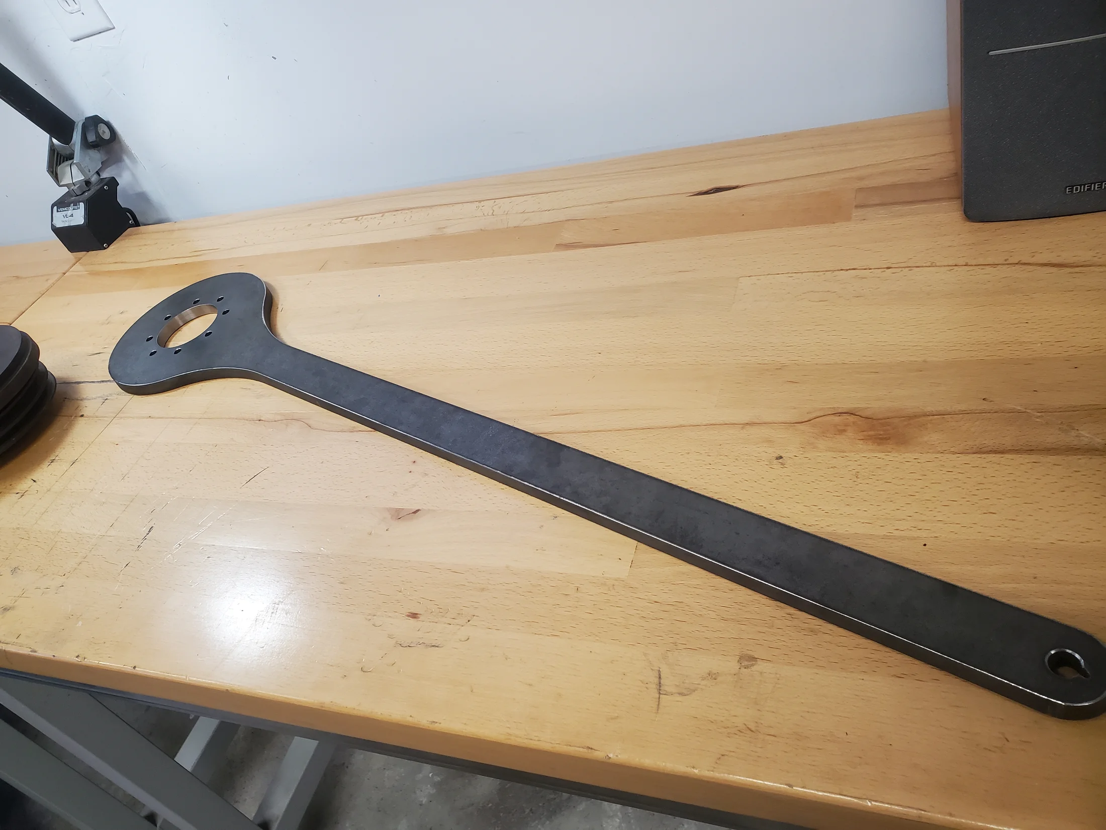

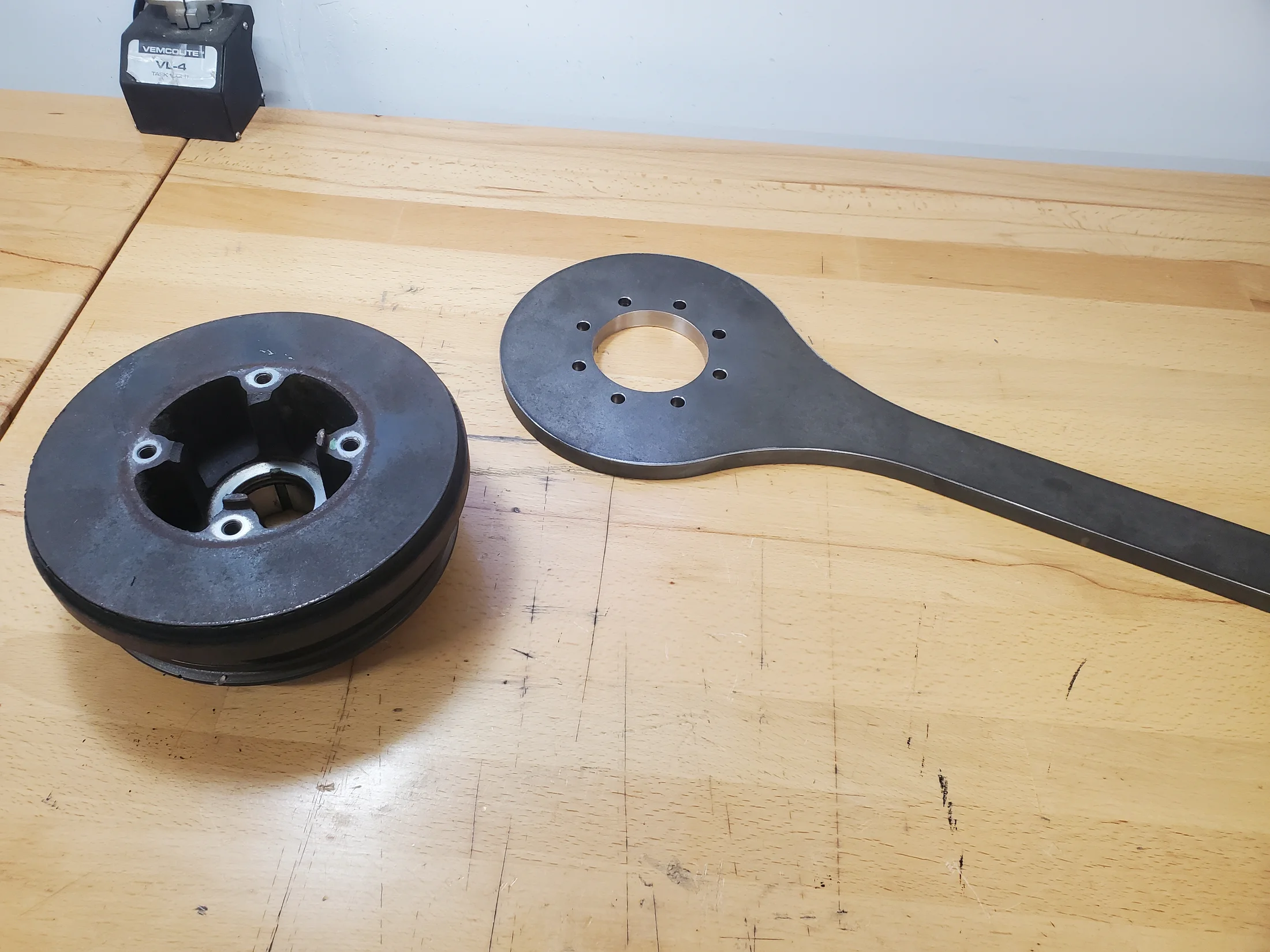

Someone on here made a plate to help with getting that HB bolt off. I bought the plate and will probably tackle this job when the water pump and timing belt need to be done again. I don’t remember whom made/sold the plate.
The big advantage of having the plate/SST is that you save a lot of time in disassembly/assembly. The plate "tool" is thin enough to fit in between your front steering damper/support, and brace against the frame rails on either side.
I have now parted with the last of my Hilux with the 3L engine, but with those engines you must remove the harmonic balancer and crankshaft bolt when performing timing belt/water pump routine maintenance. The SST was more than up to the task, and I have removed and re-torqued many of them. That being said, we are talking about 173ft/lb for the 3L engine vs. 365 ft/lbs on a 1HD-T. I was surprised that the factory service tool was the same stainless-steel arm, with a different attachment for the pulley.
I will post a picture of the tool when I pick it up from the machine shop, and report back on how it does with re-torquing. On all the 3L crank bolts, I used Loctite 242, I plan to do the same with 1HD-T. I may invest in a longer 1/2 breaker bar, I think a 4ft bar will fit under the truck.

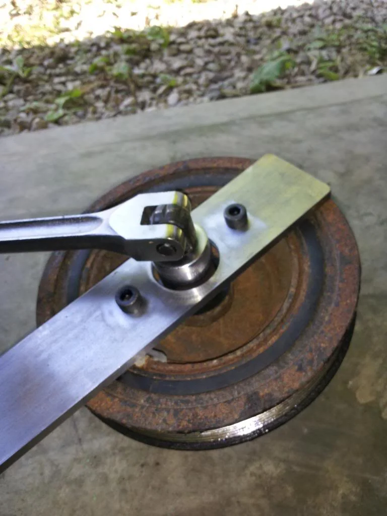

I made a tool kind of like this (not my picture, but right idea). I made it four feet long. I have a four foot breaker bar too that is 1/2" drive. Easy Peasy.
