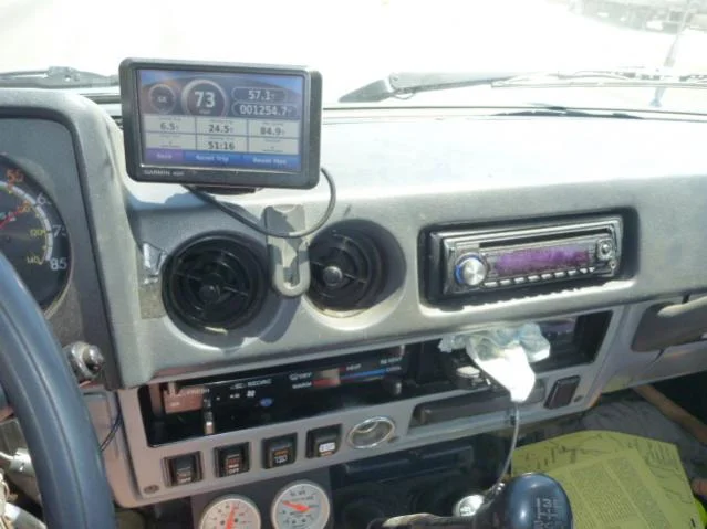

Did you do anything to your stock speedometer to make it give you an accurate speed for the H55f with 33s?

PS - Mitch, my speedo is off by about 12%. Look at the picture below to see the difference. The stock speedo is reading about 63 and GPS reads 73 mph. I just deal with it. I normally cruise at 65 mph corrected which is just over 55 on the stock speedo.

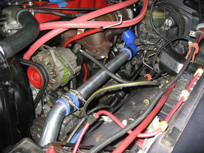

Few Questions
With out multi quoting a bunch of your postings, got a few questions for you Doug.
Post 82: What is the line coming out of the turbo housing, EGT?
Post 114: In the third picture, is that big line a #12 ?
Post 119: In the third picture, where did you get the fitting that
you brazed on there and what size is it?
Post 130: Do your fuel lines run from your gas tank to the fuel
water seperator that you have and then to your stock
fuel filter?
Post 234: The banjo fitting that you are showing in picture one,
what size is it and then did you clamp the stainless
steel hose to the end that goes to the steel line in
post 235 the last picture?
Sorry for so many questions and all, getting ready to buy some AN fittings to tig weld onto the pieces that use to go to the top of the oil filter assembly and up to the side of the case. That's why I was asking if they were #12's or not. Will email you the other questions that I had for you. Thanks to you and Longbow (Don), I have gotten soooooo much info for putting my diesel engine back together. I have also gotten a ton of info from Dazed (Mitch) from watching his build and following his do's and dont's.
Thanks, Ryan
Yes, EGT probe. On my new turbo, I had to move the probe to the exhaust manifold.
Yes, #12
Fitting is from Earls Supply (I have a main store nearby), I forget the tube size, but the hose size is #3. I bought an undersized tube size and enlarged the hole to fit the metric steel line size.
fuel filter?
Yes, basically stock lines to the added filter assy. sthen plumbed to the stock fuel filter.
That filtting connects to the steel IP fuel line you referenced in my post 119. #3 AN fittings on both ends of SS braided line.
Thanks, Ryan
No problem and glad to help. I answered the email also.
Doug

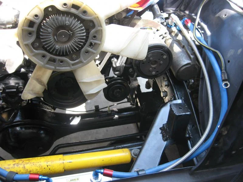

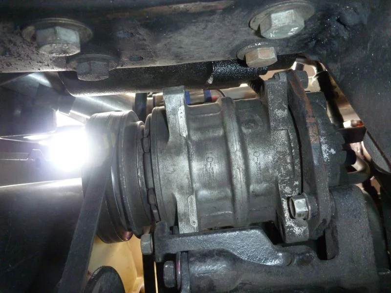

Motor Mounts
Thought that I would come back over to your post and ask questions about the mounts, instead of asking on Dazed's thread. I looked at page 2 post 27 at your motor mounts. It appears that both mounts are the same length, would that be a correct statement? Trying to get a few things finished up on my motor before attempting to place it in the frame rails. Also, do you have any stock pictures of the A/C mounted before you modified your mount? Can't figure out how that sucker goes back on there. It was not on there when I bought the motor. Got a new belt for it also and not sure also how to set the tension. I have no mount bolts or anything.
Thanks Doug
The motor mount fame brackets are real close to the same length. The drivers side was the tightest fit on my swap and the steering box was the issue. I did the ac mount modification you mentioned and added a 1/2" steel spacer between the steering box and frame also. Works great.
These are the best shots I have of the AC compressor, if you want something specific let me know.
Hope these help.
