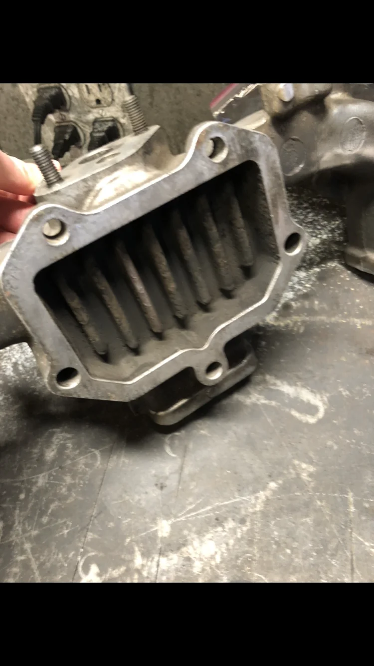

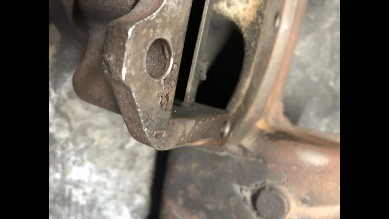

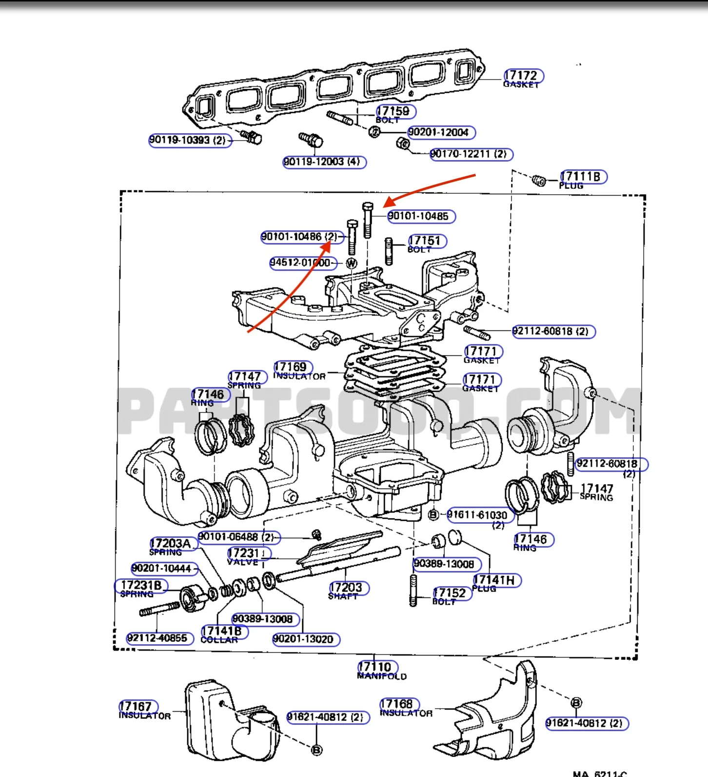

Any advice on throwing on the manifold? I'm trying to get it on there WITHOUT a vaccum leak the first couple tries if possible.....
I might pracice with my s***ty gasket before I use the remflex I was recommended to buy, I'm assuming once put on you get one try at it as it flattens or am I wrong? I also might but globs of red RTV to mate the two manifolds in between the gaskets and insulator as there are some gaps on the surfaces. Curious people's thoughts
Dan
The remflex gaskets will take up those gaps. Don’t use rtv on the remflex.

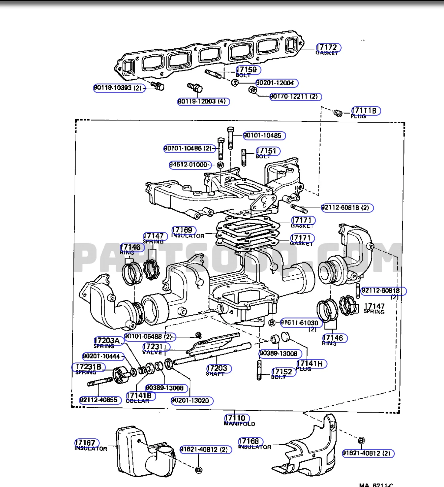

As far as mounting the intake and exhaust manifolds goes, you can put them together off the truck, but keep the bolts that hold them together loose enough to move the two halves around. Then you can get the thing temporarily mounted to the engine. Having the two loose will help you get everything aligned. Before you torque it to the engine torque the halves together and then torque it to the engine. Then connect the exhaust from there.
K thanks. Should I use rtv for in between the manifolds? Both sides of gaskets and insulator??
No rtv for normal install. If you have gaps between the 2 manifolds that the gasket doesn’t fill: fix it properly or look why. Warped? Cracked? Need to clean off baked on old gasket still?
If your engine is out, I usually loosely bolt the intake and exhaust together so it can still move a little, then snug the assembly to the head with no gasket, tighten the intake to exhaust bolts. Then take it off and install with the gasket. Mind the remflex torque spec: don’t just gorilla it on there.

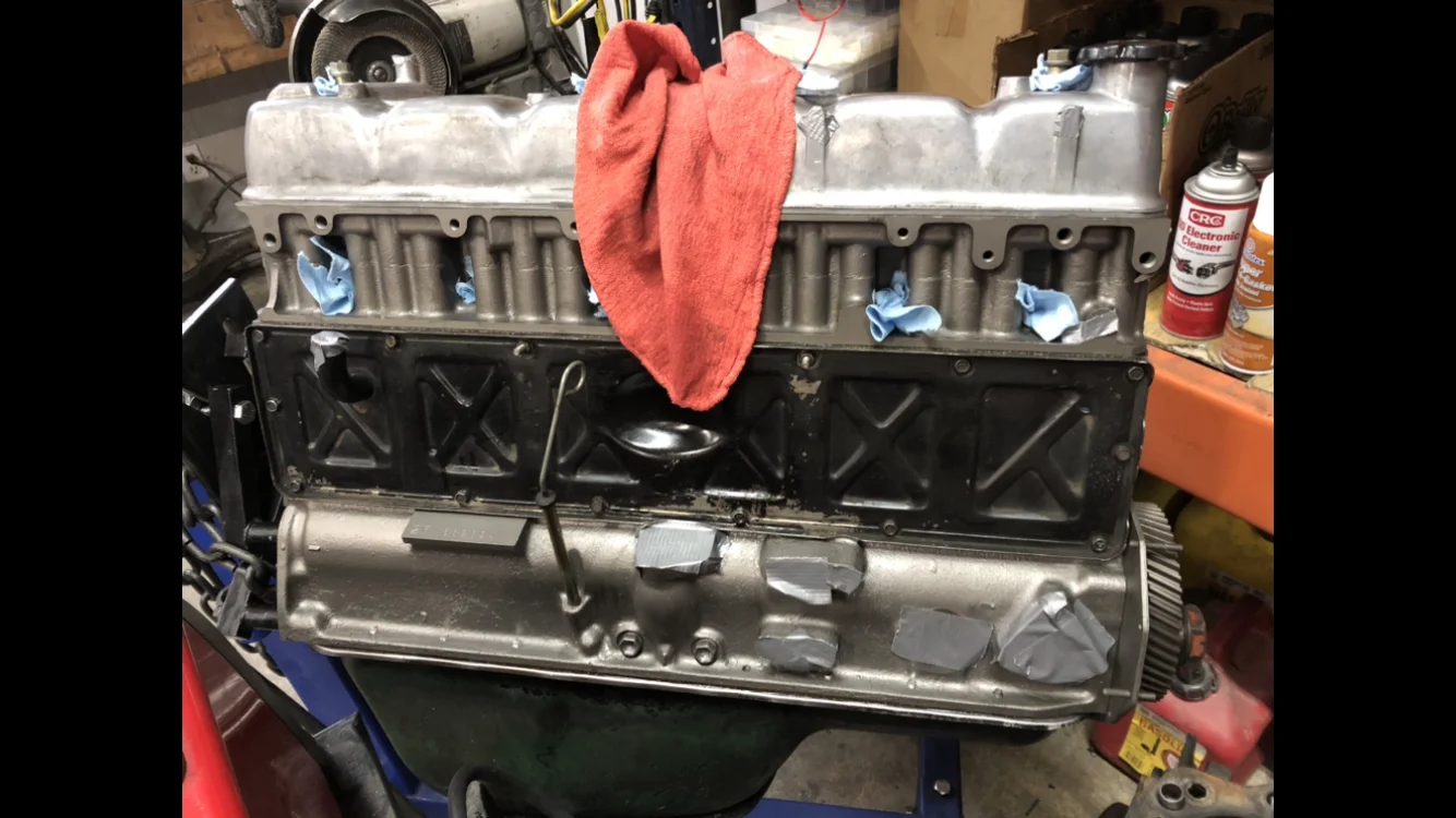

Having issues turning the crank to get to TDC
The fuel pump has been installed, and I think that's creating the friction. Should I uninstall and reinstall?
Also, Is it bad I rotated the crank the wrong way a few weeks ago? I don't think that could be part of my problem.
Thanks
Dan
The fuel pump should be installed with a spacer. Does yours have one?
Is your cam and timing chain installed? If everything is installed correctly it should not matter forward or reverse by hand

The 1985 2F-3F FSM has a pretty complete set of torque specs. There are torque call-outs in the service specifications section and standard bolt torque specs for fasteners that don't have a torque call-out in the back of the FSM too.
Also, do I get one shot with the gaskets? once down they're pressed right?
That's the best practice. You can sometimes get away with mocking up and not torquing a gasket fully. Remflex are supposed to be good in that regard, but I don't know from first-hand experience with Remflex.
The 2F intake & exhaust manifolds are tricky because they use the same studs in a couple locations, so they need to be the same height, and pretty flat to seal correctly/apply even torque.
Thanks
Dan
The engine should turn over smoothly. There will be some resistance, but it should be relatively even (without spark plugs in). Remove parts you added since last verifying it turned over well, inspect (correct parts, no damage), verify it turns over without parts installed, re-apply assembly lube if necessary, reinstall, retry turning-over. Best practice is to only turn engine in direction it normally spins, but I've done it on occasion and haven't broken anything yet.
No timing chain in a 2F. Just cam gear and crank gear.
Are the spark plugs installed in the head? If so, then removing them allows air to evacuate the cylinders making it easier to turn over.
Do you have a tool for grabbing the ring gear on the flywheel? That’s how I turn my engine over.

Those tools are handy, but I think his engine is still on a stand without the ring gear attached. In that case he should be able to use the crank bolt. When I am adjusting valves, I rotate the engine via the V-belts by turning the nut that holds on the alternator pulley. I first remove all the spark plugs. and my engine is "worn in". Having the spark plugs removed does make it easier to spin and makes it easier to stop right at TDC on the compression stroke. With the plug installed the engine has a tendency to "roll off" TDC because of the compression pushing the piston back down.
Can’t put it at TDC without the flywheel in place. Well, you could, but how would you know without the indexing bb and bellhousing needle for reference?
