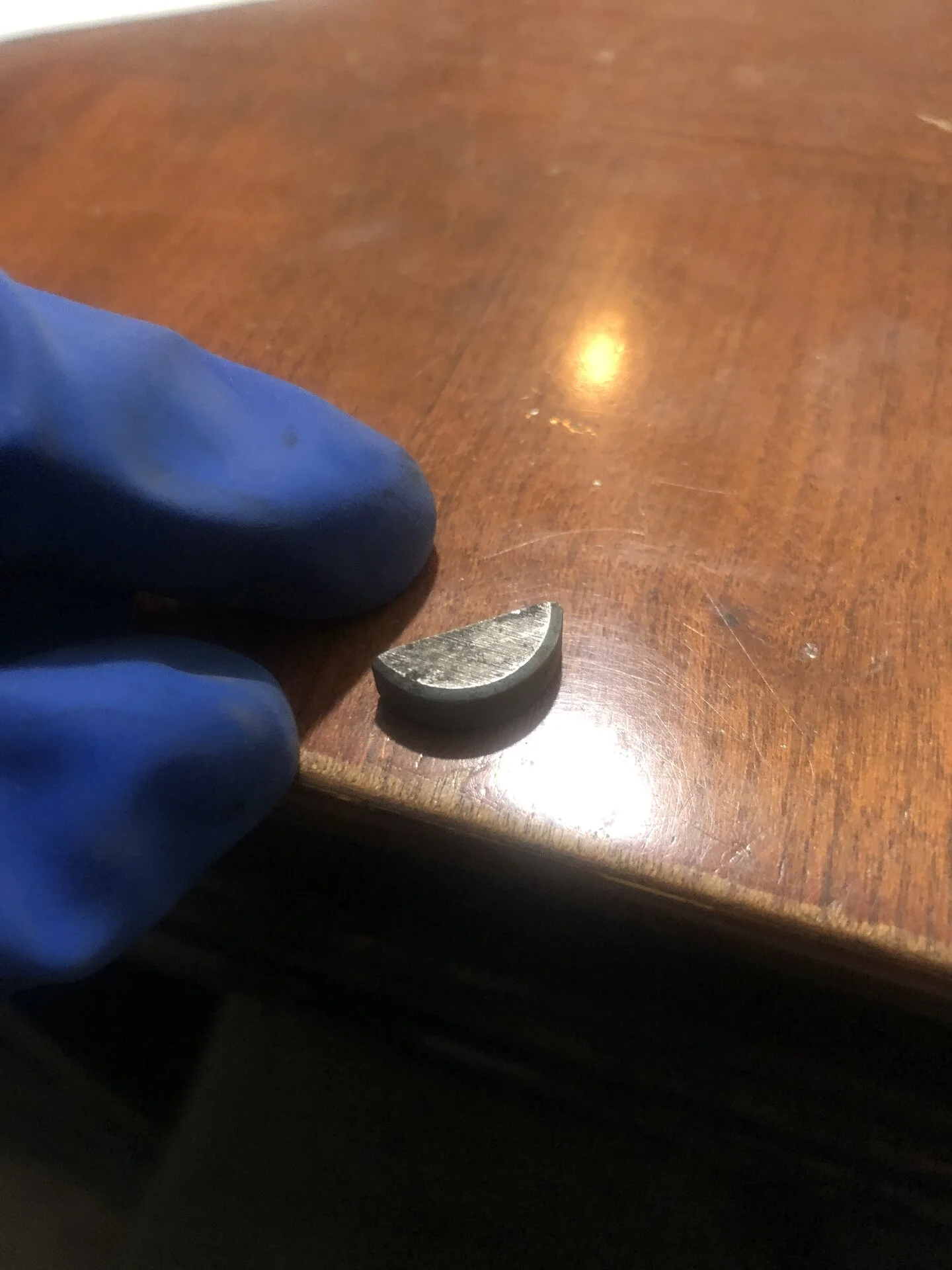

Just dropped the rebuilt motor in. It was turning when we had it out.
Tried turning from the crank nut and nothing.
This piece fell out when we tried rocking it in 2nd to move it. (See attached)

Beehanger

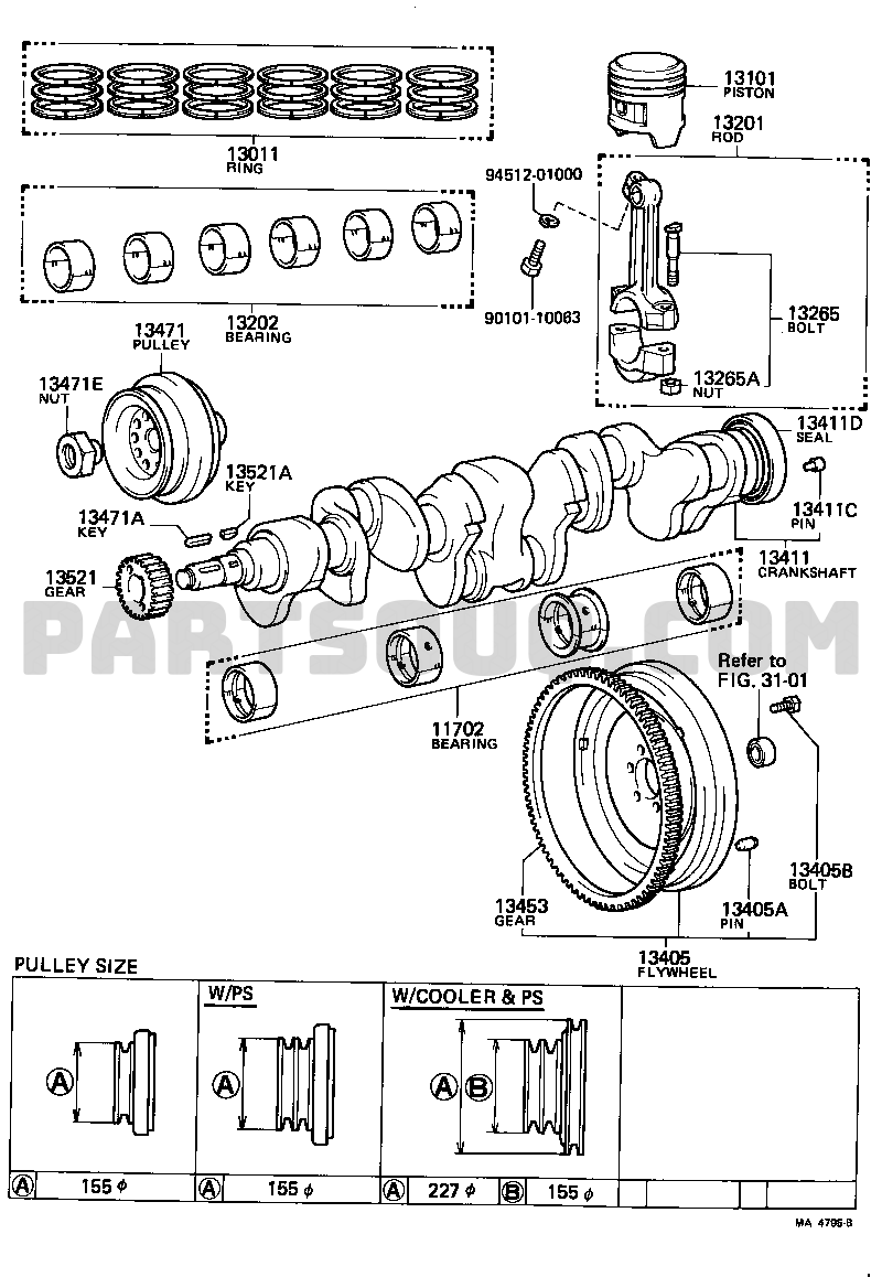

Did you remove the timing gear from the crank? That might be the key for the timing gear. Key fits in a slot in crank and in a slot on the timing gear to properly position the timing gear. Part no. 13521A
That’s what I thought! But the
That’s what I thought! But the timing cover and pulley are all on there… how in the hell could it have come out?
My engines been hard to crank over, but did it successfully a second ago for a second, but no more than a quarter turn.
Wondering if these keys fell out and are jamming something

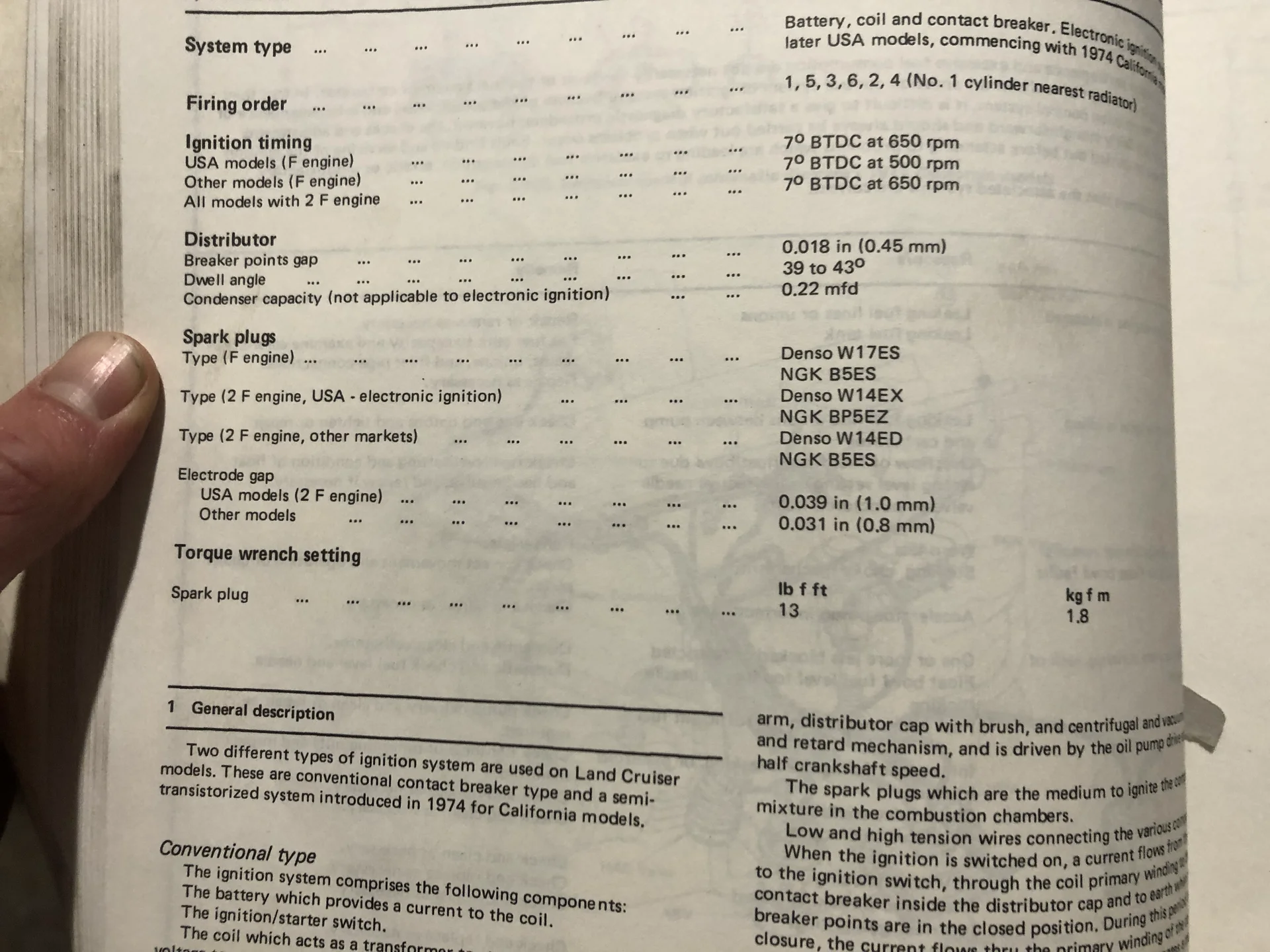

As I grow more bananas, I'm circling back ont he sparkplug question. Ihave my gap set to .039, not .031. this is what the haynes manual says...
Anyone want to weigh in here?
.031” is spec I believe. If you are running a super powerful ignition you can probably up the gap a bit though. With the standard ignition and a bigger gap on the plug you will get a bigger spark that can aid in ignition * however* the cost is a shorter spark duration. With better leads and a more powerful coil you can’t spark a bigger gap and maintain the same spark duration.
Well put sir.
Well put sir.
Ill real her back to .31, was set at .39. MOTHERFUCKER
