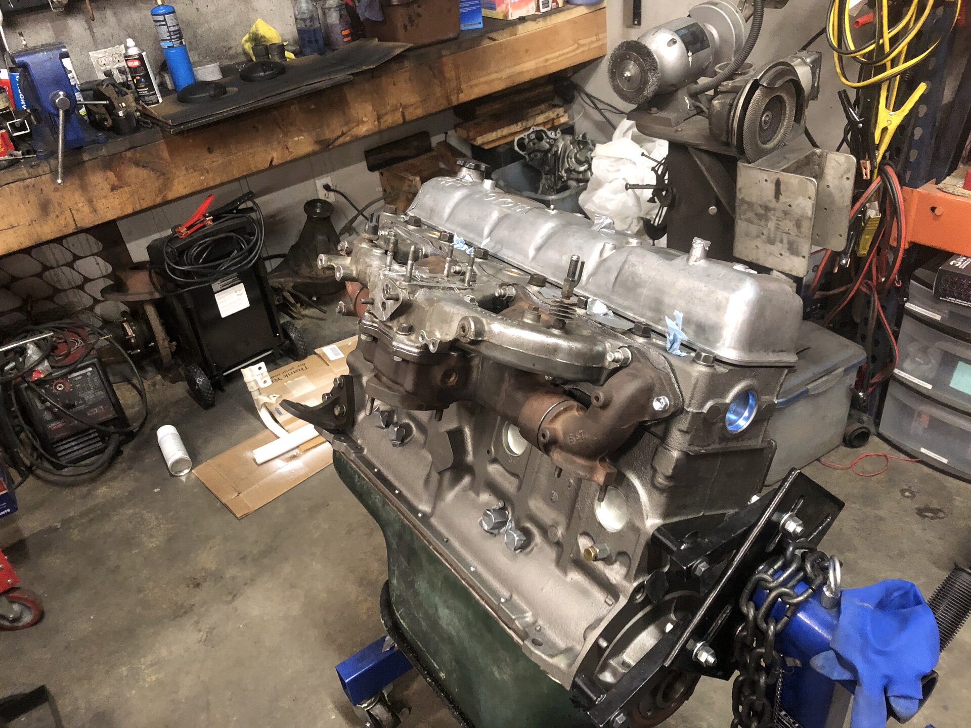

I’m going off the picture posted earlier in this thread. The engine on a stand with the timing gears exposed.
Gotcha. Other than setting the cam/crank timing when installing the cam or installing the dizzy, what other reason is there to put the engine at TDC? Adjusting valves… what else?
Planning on adjusting the valves, wanted no doubt I was TDC.

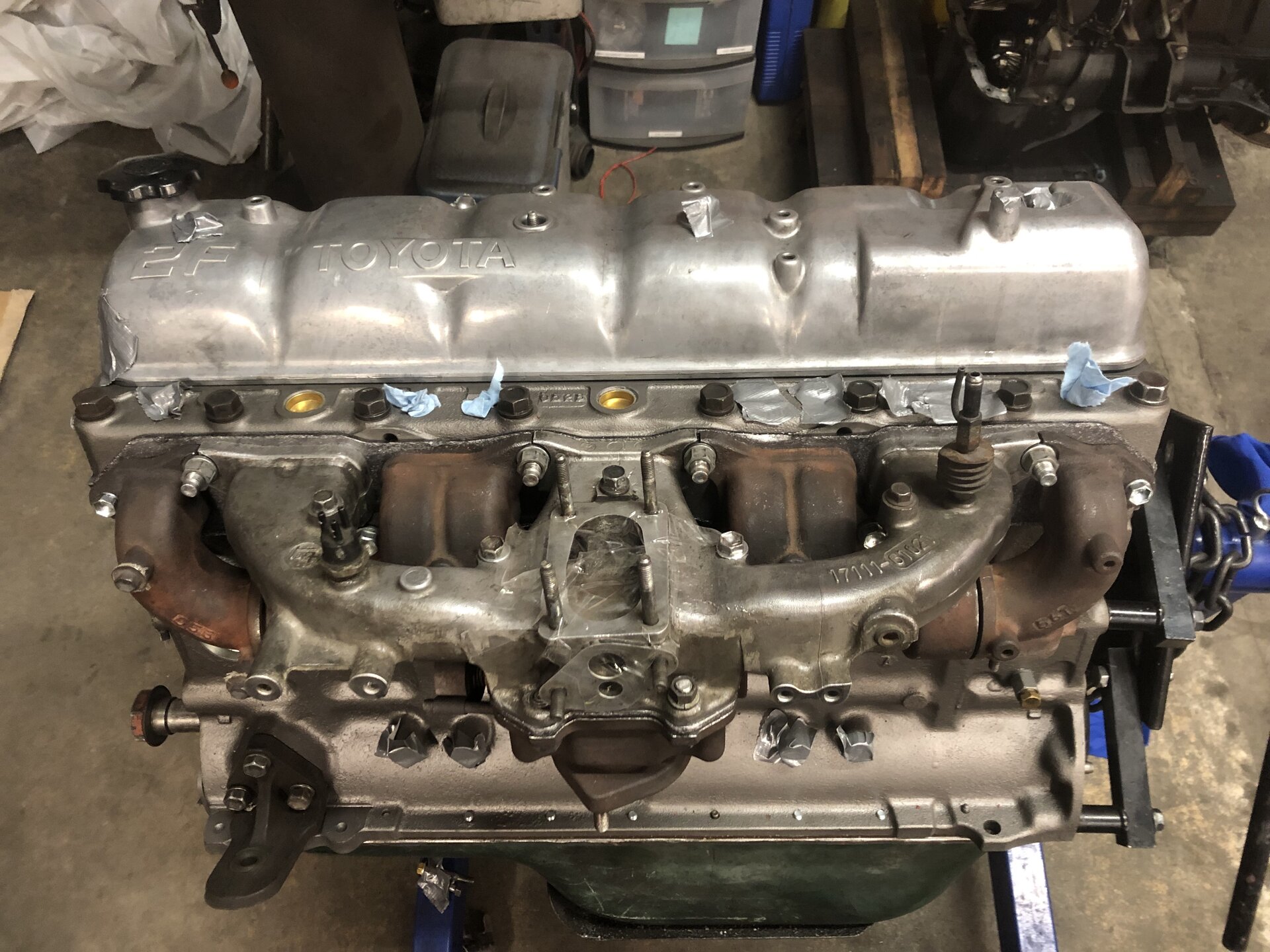

Had a huge win tonight! A buddy and I put our heads together, after 2 evenings of some outside guidance and first had trial and error, we torqued the manifold on with the remflex gaskets. Torqued to spec per the box. On to timing cover install and valve adjustments tomorrow!

The green marks on the gears are lined up and the oil nozzle is staked.

Is your block and head raw? As in, uncoated cast iron?

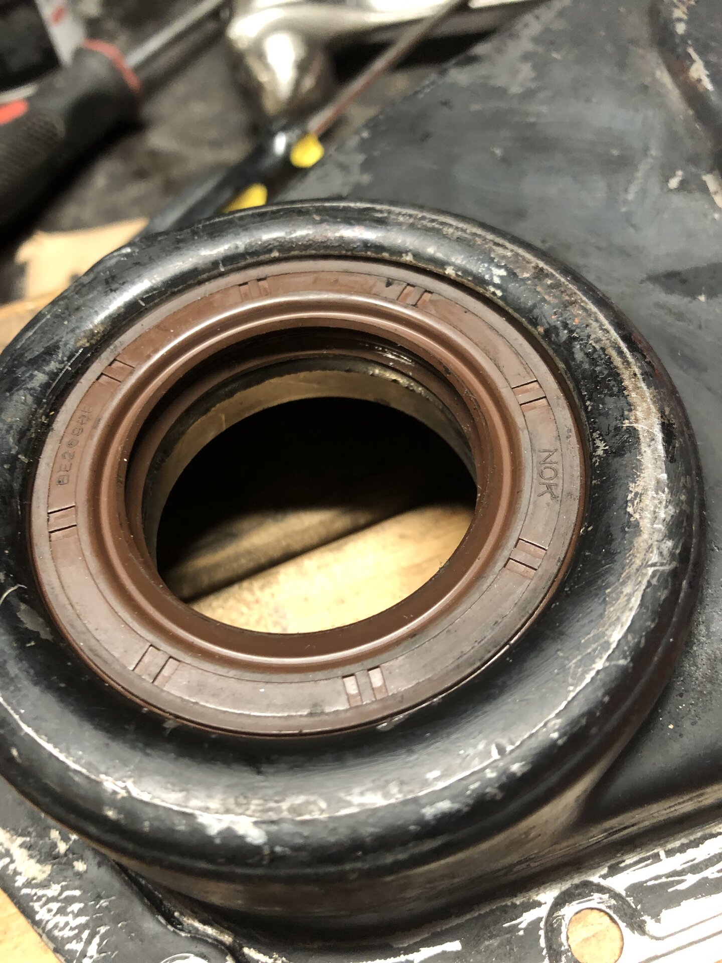

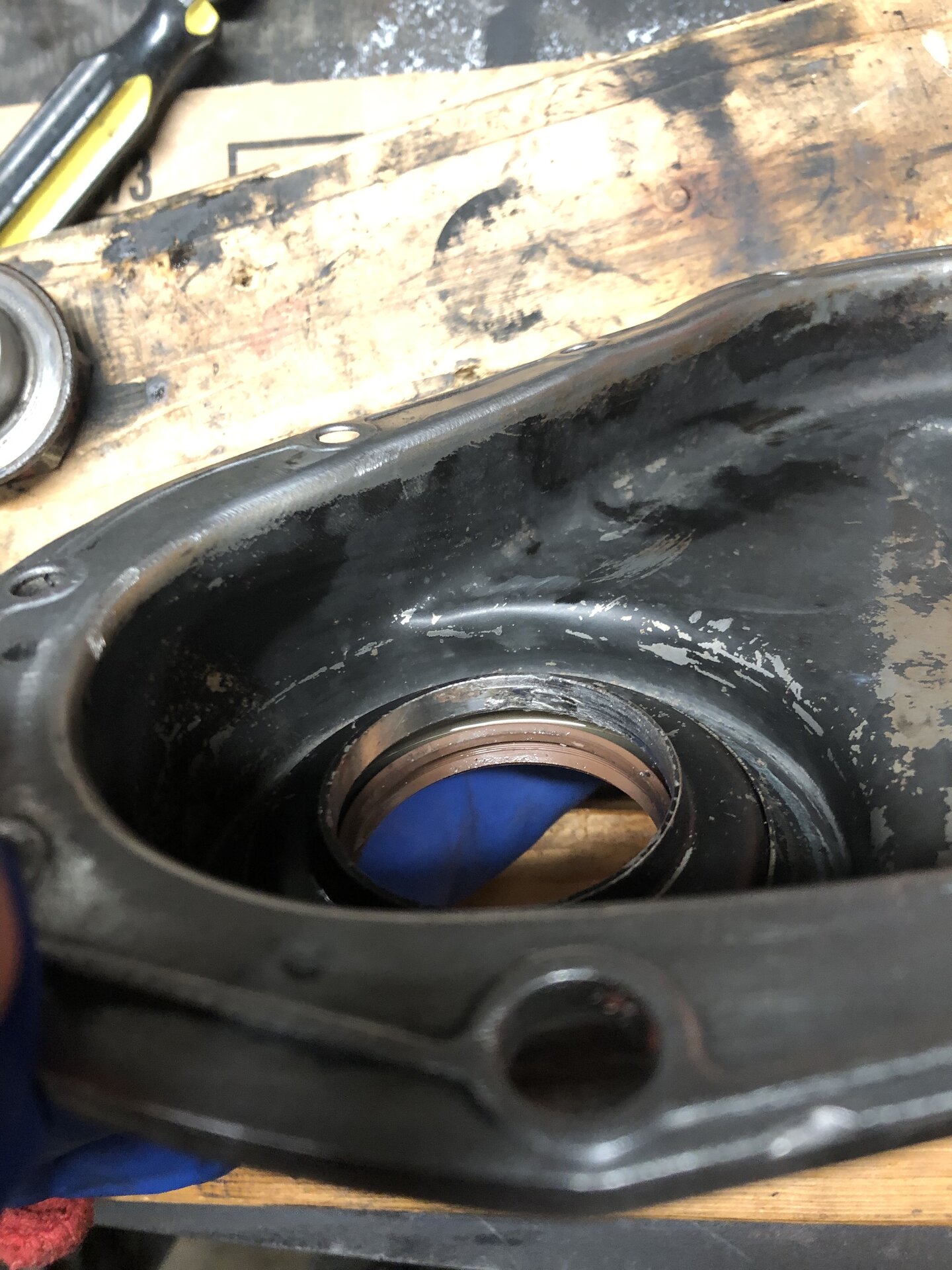

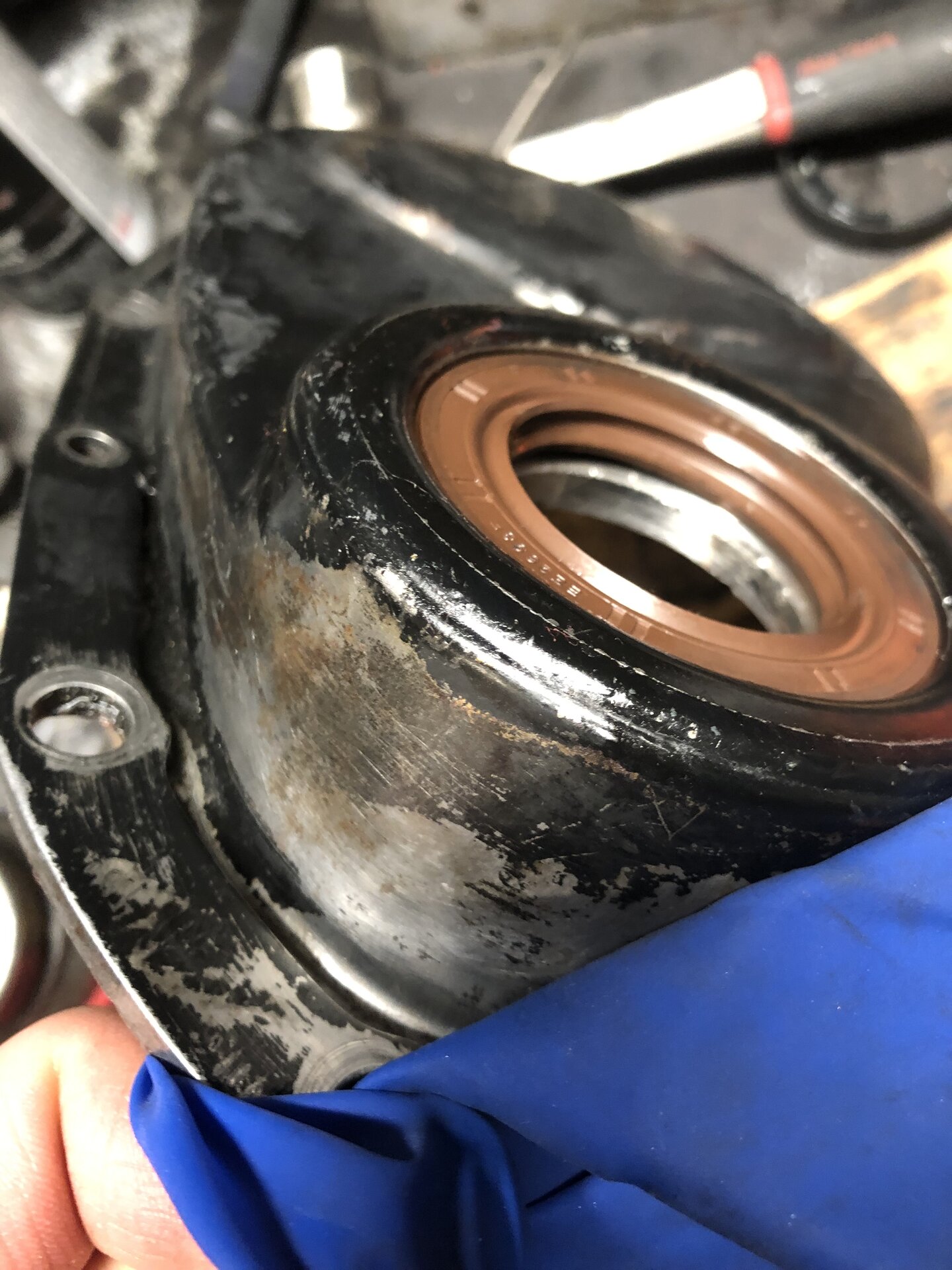

How do I know when I’m done snacking the timing cover seal in? Used a mallet and an oversized socket. I think I might have overdone it, it looks like it’s further in than the old one. I think I can could the steel ring towards the exterior, then I hit it in further.
Is there a way to tell? A trick I’m missing?
The seal works around the machined part of the harmonic balancer/crank pulley. The 2F engine manual is not too specific: "Drive in the oil seal until it is about even with the timing gear cover". If you are using a new harmonic balancer, you should be OK. If reusing your old one, check for scoring/wear on the sealing surface. If there is a worn spot, you may want to position the seal to avoid it. If it is too bad, you could use a speedi-sleeve.

That seal looks just about right to me. Make sure you put a light coat of engine oil on the mating lip before you install the HB. Installing the balancer into a dry seal can rip it.
Take your time doing this part and make sure you don’t over tighten those small timing cover bolts. They are measured in INCH POUNDS. Not foot pounds. Make sure the timing cover is flat before you install it. You may have to use some pliers or a mallet against a flat surface to carefully hammer it back to being flat. If it’s not flat you could have leaks around that cork gasket.
Also, don’t use too much RTV on the bottom where the FSM calls for it. There is an oil return galley right there where the two 14mm bolts thread in. If you get too much RTV squeezing out you can clog up that hole. It just takes a thin film on the gasket to do the job.

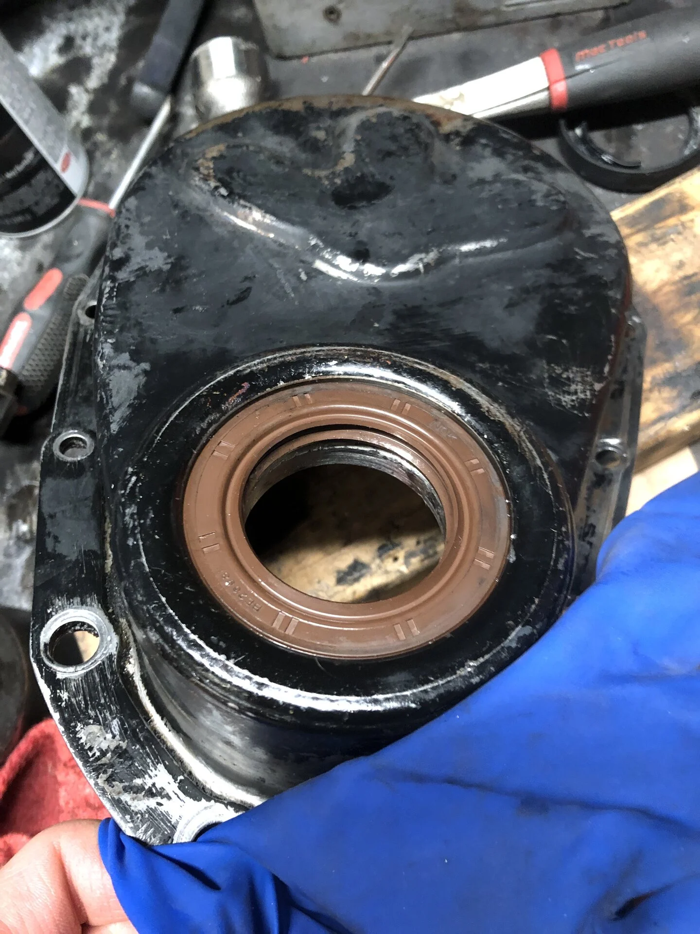

Took a prep day Friday, and a late night tonight but got it done. Seated the lubricated seal and drove it in, no puller here for it so just went for it. Timing bolts tightened to torque spec for the 40 series manual, but these bolts were 10 and 14mm…. Not 6 and 10. If I need to change the torque specs up higher let me know, but did 60inch pounds for the 10mm and 12 foot pounds for the bottom 2 14mms, and finally 120 foot pounds for the crank pulley.
I have backup gasket if it leaks right away but……

Looks pretty good from that photo. Generally with the cork gaskets you want to stop torquing when you start to see the gasket bulge a little bit. If you tighten too much past that it will split the cork.

Also, I think you defiantly have raw cast iron there. I’d think about painting it before you drop it in.
