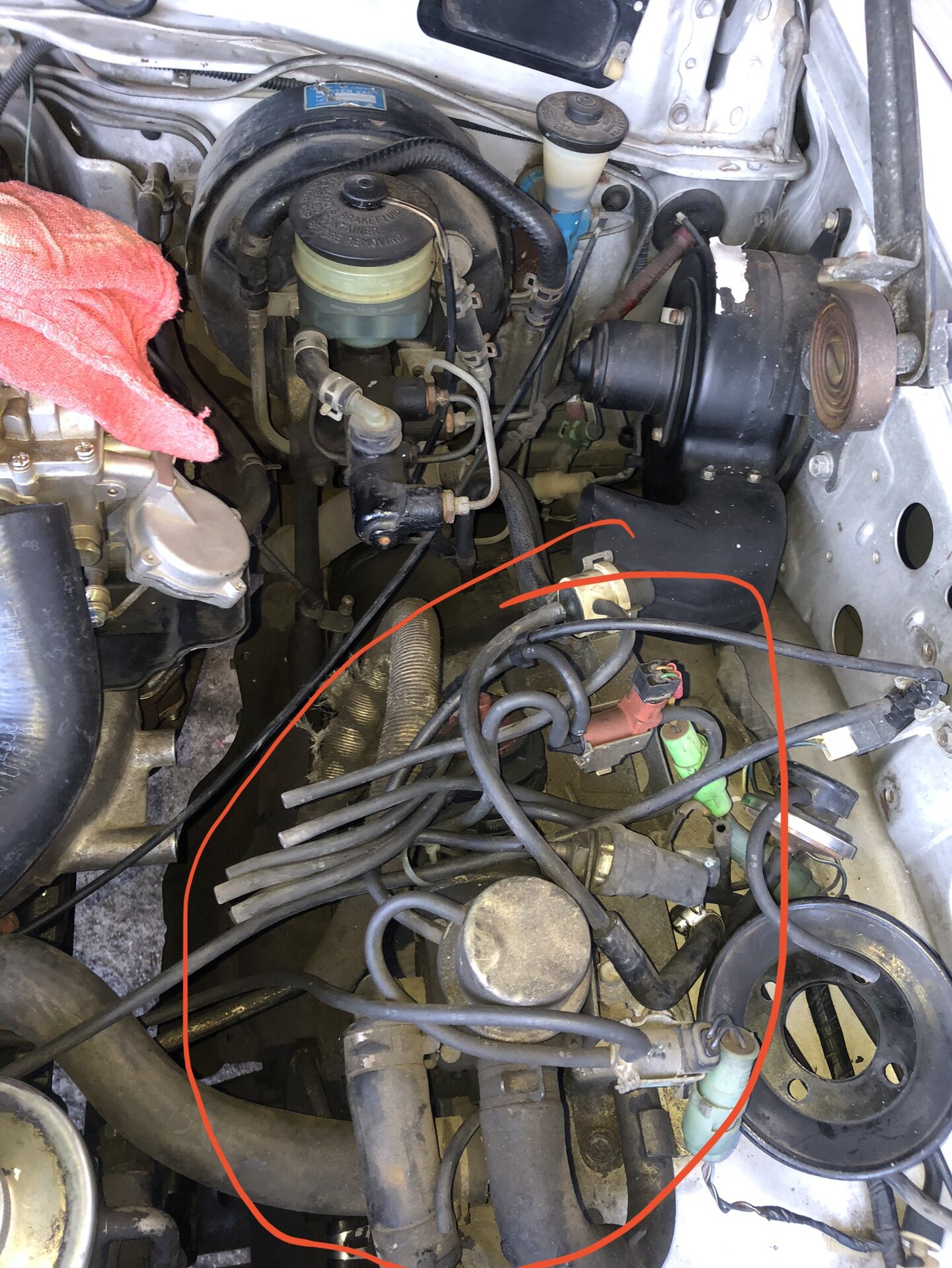

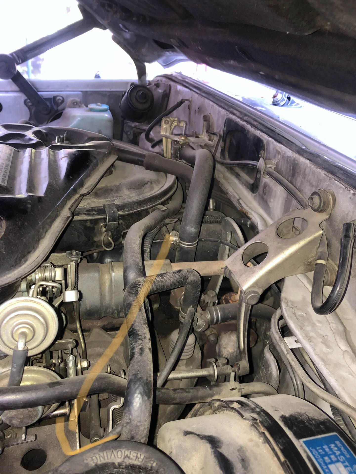

Another question: I’m desmogging my and trying to pull all the equipment I don’t need. I’m circling a few items I’m unsure about if people can weigh in.

The first picture you posted is of your ignition coil. The truck is useless without it.
The second picture shows some of the emissions equipment. You can delete all of it, however, doing so improperly can give you all kinds of issues.

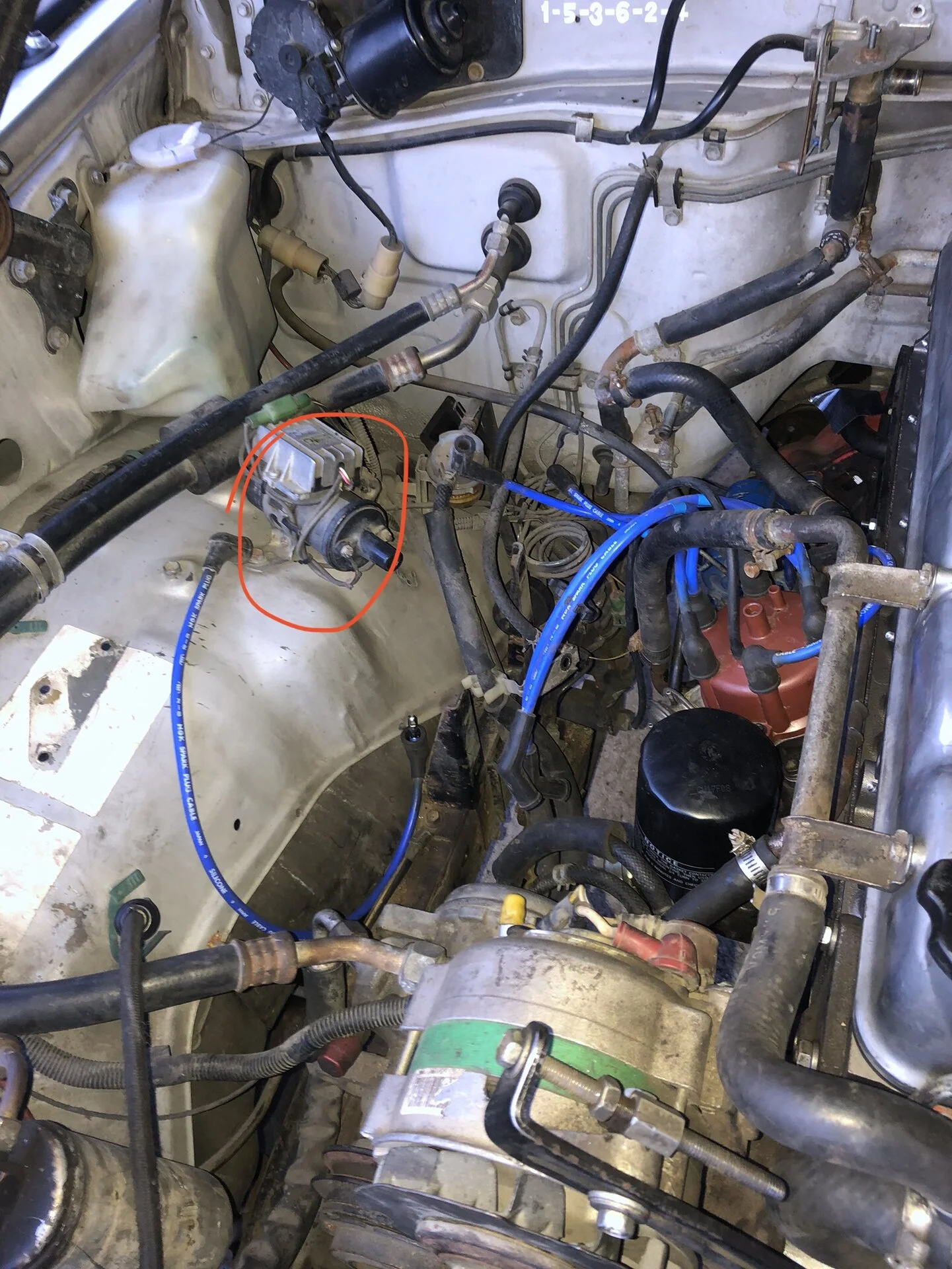

Anyone know where I can find some photos of a desmogged example from these guides?
For instance, the place of the HAC seems to change as it isn't deleted.

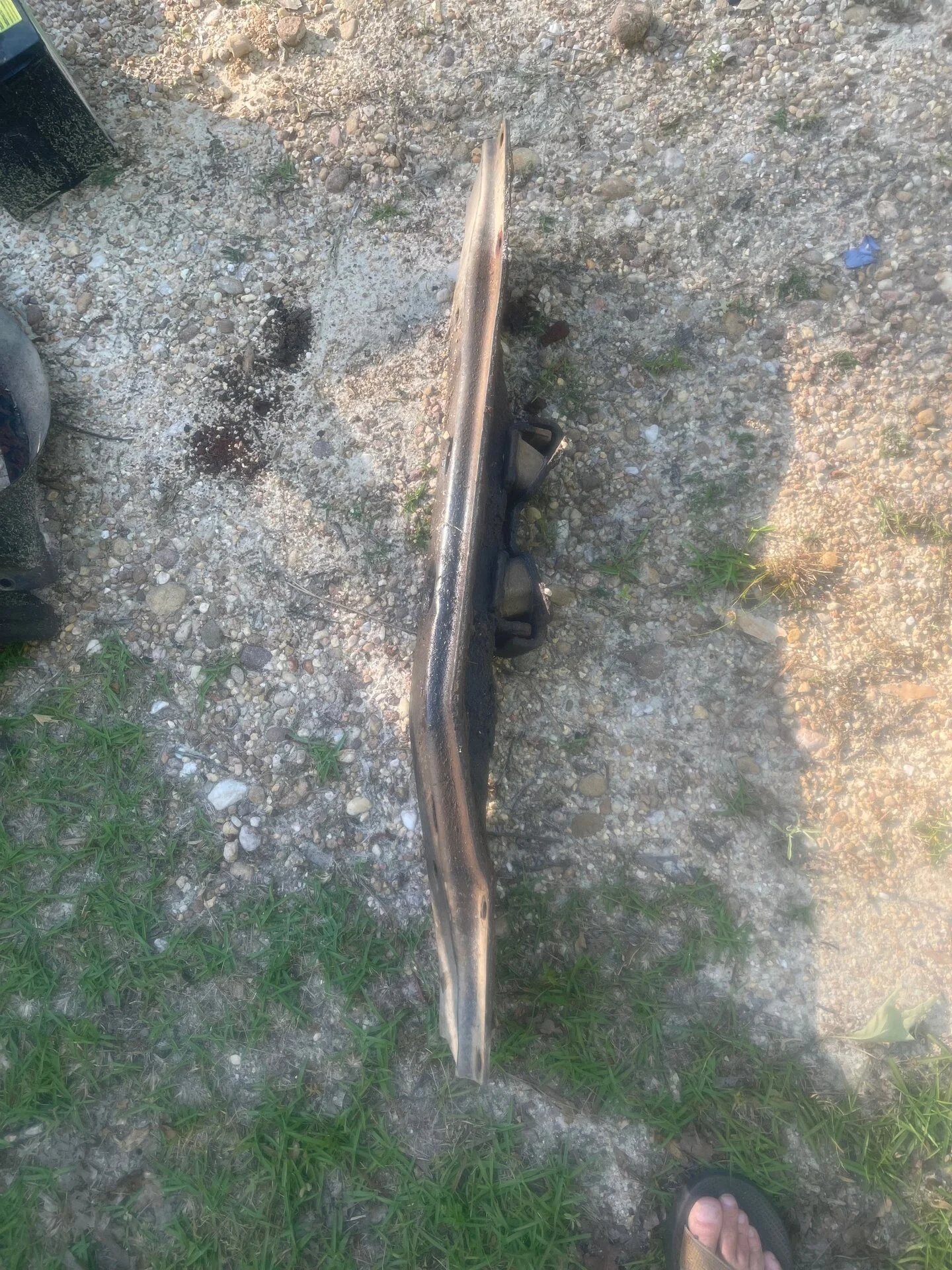

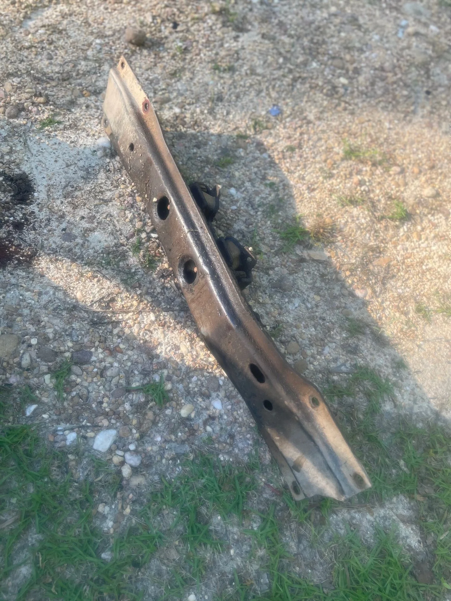

Anyone know where I can find this sort? Missing a few things final assembly!
Coolant resevoir(s)
Carburetor mount for linkages (see photo)
Is there a way to get these temporarily,?
I lost the carb part an there’s nothing for throttle to mount to. Anyone have a part number or a way I can jerry rig this for a week?
