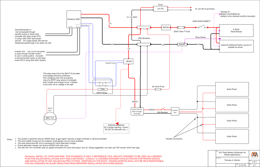

I roll with both, Champion Dual fuel 3k generator (never had a drop of gas, I’ve only used LPG) and 400w solar w/Tesla battery (both can start my AC w/o “quick start capacitor” but I’m going to add one anyway) but my solar is more expensive than my generator. As I’m sure is known, solar is about storage, batteries aint cheap, I found converting to a 24v system using a Tesla battery doubled my capacity in less space than the existing type 34 size batteries at half the cost of new 12v LiPo.

Also, very interested to hear more about your tesla battery setup. Batteries are expensive as hell I've come to realize.

Lots of options for take out batteries from Nissan Leaf, Chevy Bolt, Teslas...I chose Tesla for many reasons but mostly because I didn’t have to invent the wheel, many others have done so making easy to follow builds on Youtube/etc. It’s about knowing needs, calculating loads and building a system around that considering space limits.

There's a company right here in NC that sells Tesla batteries with converter boards and bms systems :D
BMS for tesla battery:

233 Ah for $1300 in 23kg is about as good as it gets in price/weight.
In comparison from Battle Born:
Approx $2K for LiFeP04 100Ah x 2 set up. 100ah/14kg comparison as well
Oh sheet - just saw those 24V not 12V - so wow.

Where I got mine, nice guy, excuse to visit BudBuilt too...
It would take 4 Battleborns and still not same spec as 1 Tesla battery module, 50% of space and weight...
