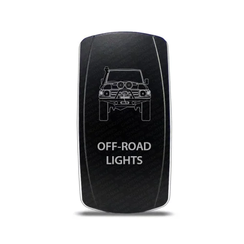

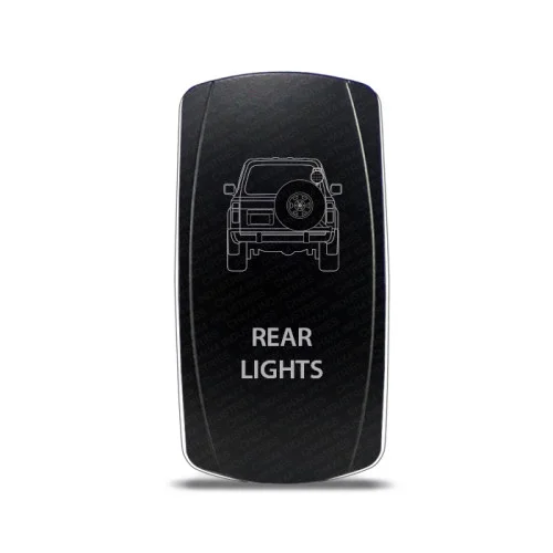

Seriously, though. Great set of 80 specific at cruiserheads
http://your4x4store.com/
tried to make a link with all 40,70,80,100 series landcruiser switches.
http://your4x4store.com/?s=rocker+land&post_type=product
