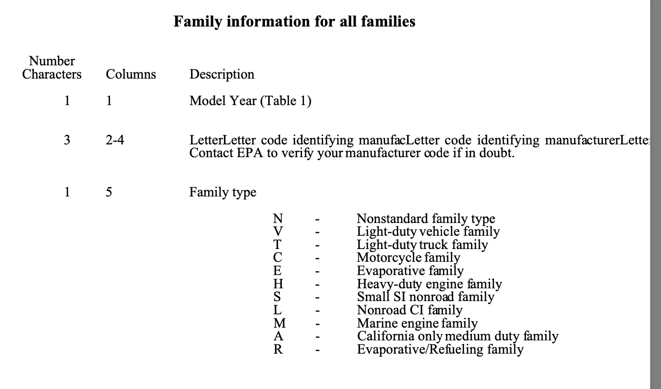

Alright, got home and couldn't find my label on my FJ60. But I did dig up a few interesting things for anyone following along at home, minutiae and such below. If you want to skip ahead past the tables, feel free to do that for info specific to my situation.
  • Some google-fu found me to On-Road New Vehicle & Engine Certification Program, which appears to be the official CARB list of permitted engine families/test groups and their parameters ("executive orders"). From reading through this site I built the table below, which I believe is how CARB sees it (and aligns with the decals from the library above). Some of the forms even have copies of the decals in them on the last page. For posterity: this page may disappear soon per a note near the bottom.

  • Pre-81 is fine to mix with pre-81 since they all have the same engine family, no problems. After that, the EPA changed their engine test family nomenclature which makes things more confusing. (I think they also changed it again in the mid-90s but that's outside the scope today ☺️)
