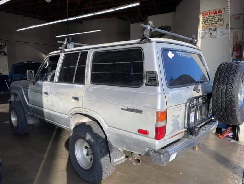

I already have a deposit down and the vehicle is basically mine, will go see it Tuesday, but he talked to his rust specialist today and some of the body rust (nothing too bad) and clear coat she thinks should be fixed (sanded, rust protector, repainted OEM body restored before it sees Idaho winter. Underside is just surface rust looks solid but might have them put something over that too. I’ve heard mixed things on putting something over it, a guy told me if the surface or paint over cracks it could provide a bad environment for rust. So it may be a purchase trip and leave it down there for them to work on it for another month before I fly back down. Will post what they quote me. Buying for 15k instead of 20k because he wanted me to have extra money to beautify (the trucks been in his family while) so maybe this is where that money goes. Not sure how much else he wants to restore and how much that may run me, like I said clean rig all around but how updated do I want this thing to just be my daily? And how much should I leave for myself to figure out in the months years to come (I’m a newbie with no garage yet). I know from the entire research process this things a great rig and deal (can email photos to anyone) but I can’t spend much more than 20/22k right now. Is there such a thing as semi restored and what would the entail lol

I’m holding off on the full body paint restore, rust coating of underside, and suspension for now. Talked to him and it’s surface rust, gunna enjoy the vehicle for a couple years before I do the pretty girl stuff. I am still thinking about what I can do for the body rust on the roof etc (any pointers on surface upkeep/elimination I can do in the winter until he takes the rust off himself and full repaint etc in a couple years Picking her up Tuesday to drive back, he’s checking suspension and alignment for safety before then. Already did compression etc

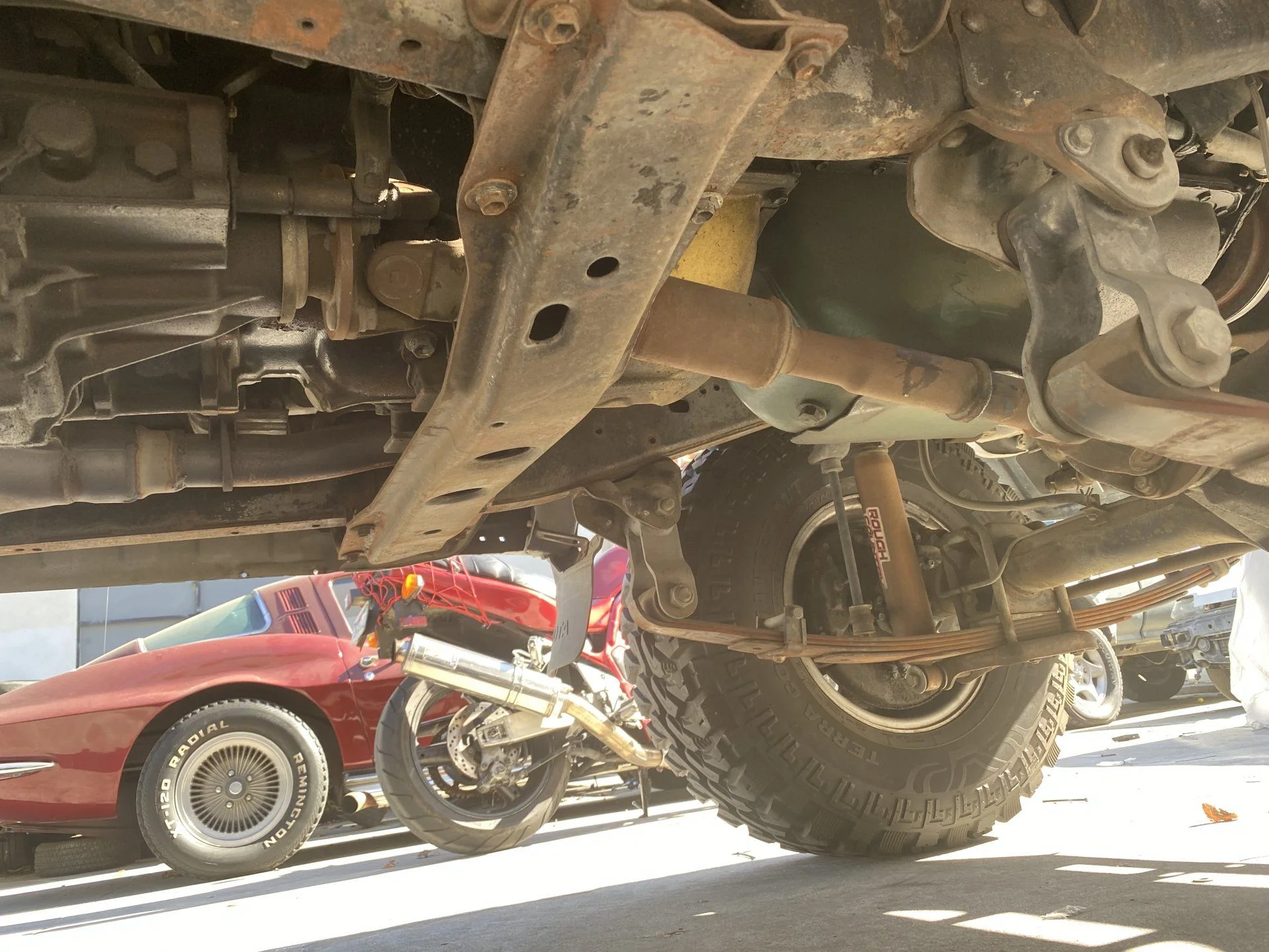

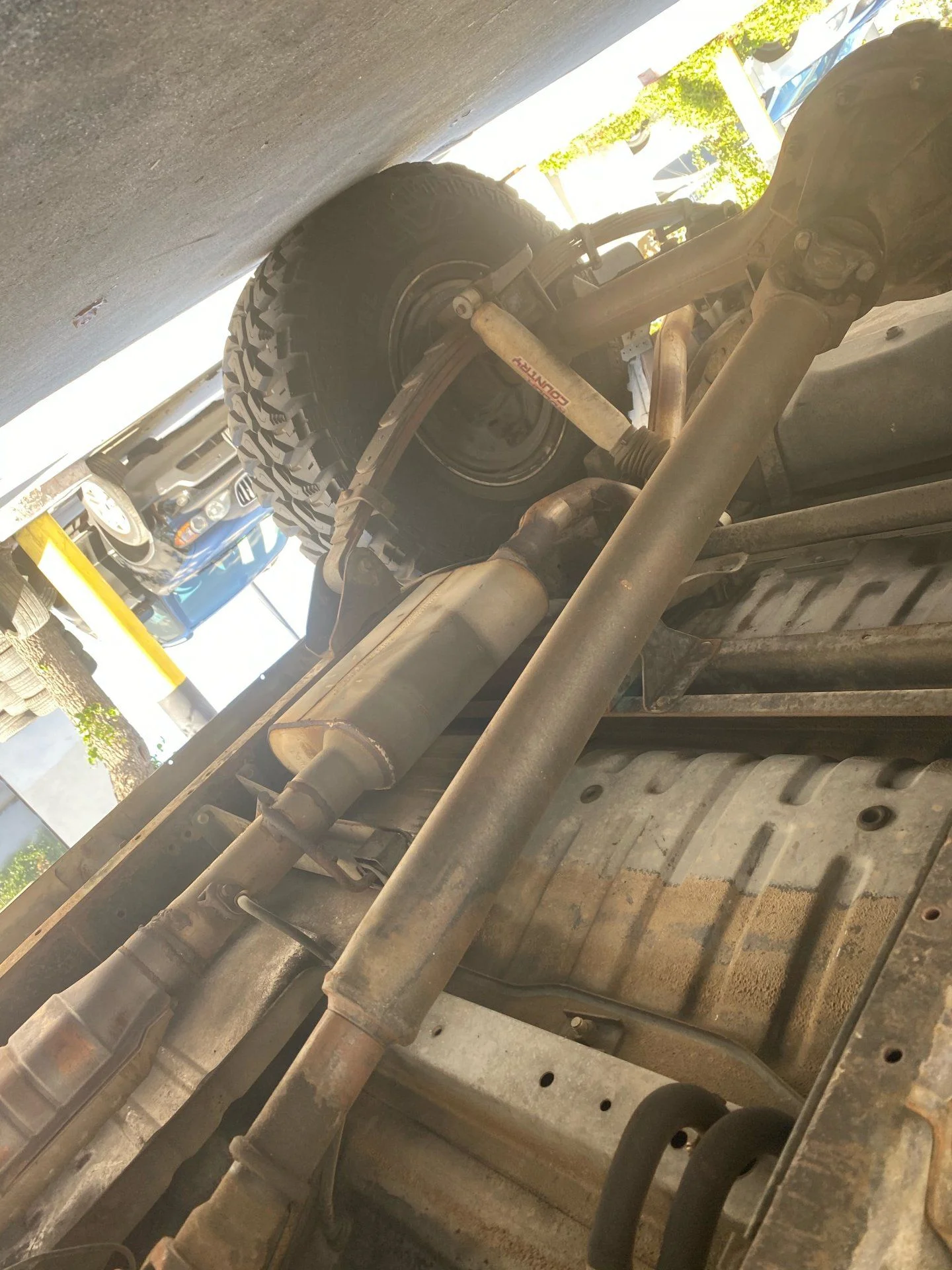

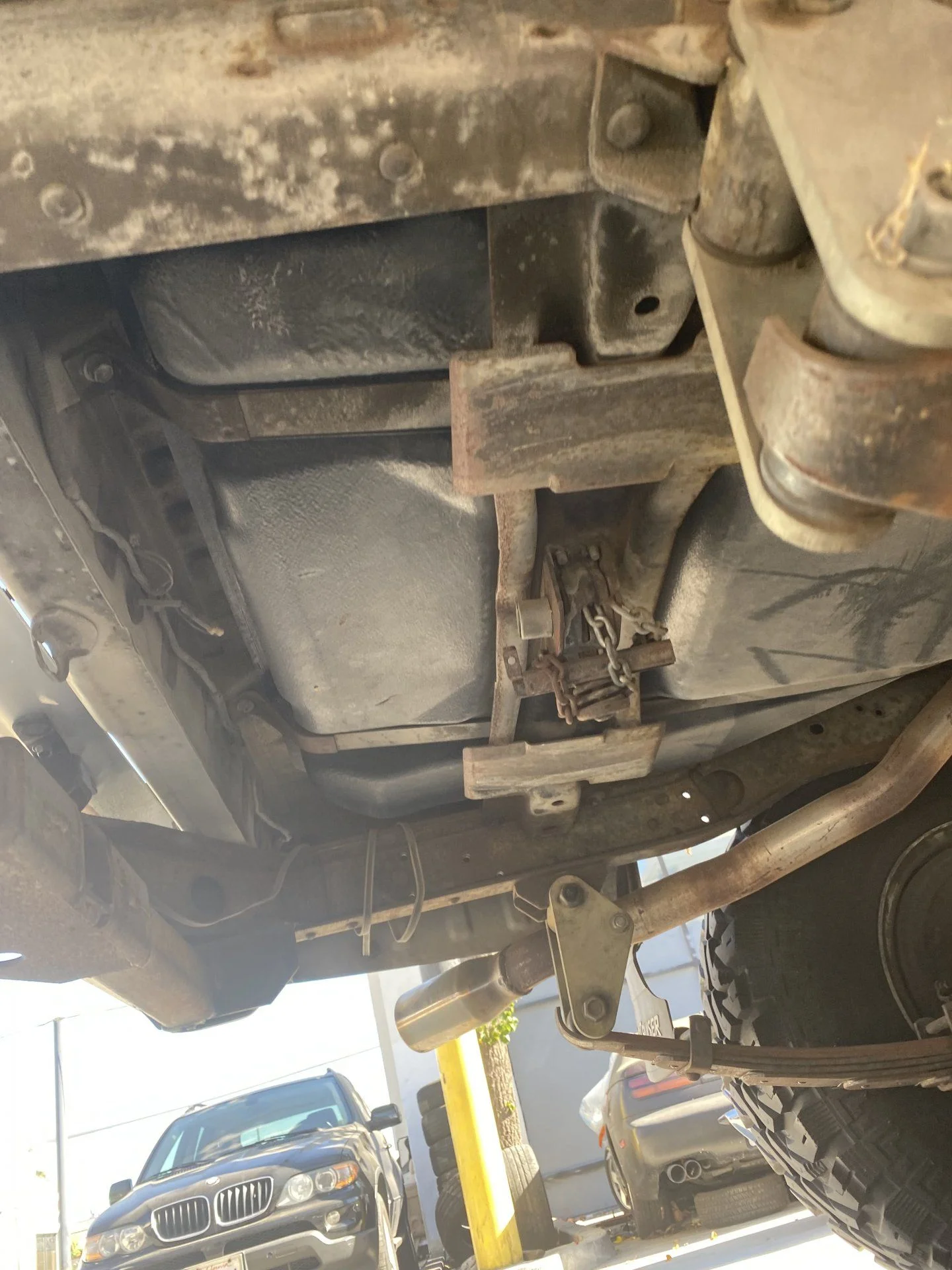

What kind of tire carrier is that? Looks like maybe a shackle reversal was done up front.
What's a shackle reversal? and not sure, might pull off the tire carrier if I can.

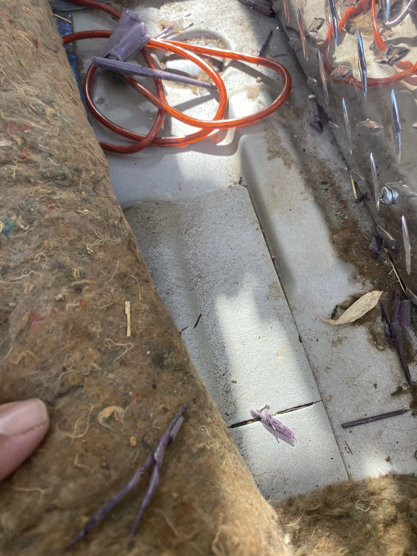

You'll want to fix that roof rust and likely need to replace the gutter caulking before you leave California.
Could I DIY that or drop it off at a shop within a week of when I get it into Idaho? I am parking it outside... :/

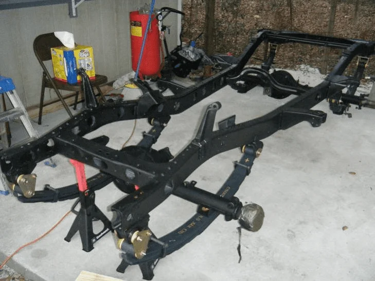

The fixed end and shackle end of the spring are reversed such that the shackle goes where the fixed end should be and the fixed end goes where the shackle normally is. The stock fixed position of a front spring on an FJ60 is behind the front axle. Yours has the shackles there. I think this change requires the springs to be flipped around front end of the spring to the back of the truck as well. I am not totally sure why you would do this. I think maybe because of where the normally fixed spring mount is positioned on the frame, adding a shackle here provides a bit of lift to the suspension. It may do other things in terms of orienting the axle under the truck by causing the tire to move rearwards when the spring is compressed instead of forwards, which may have some handling benefits, I am not really sure.
Stock, shackles in front of the axle:
Your truck, shackles behind the axle:
Perhaps others can join in and elaborate on the pros and cons of a shackle reversal setup is. I personally don't see what the advantage is other than it being a cheap way to lift a truck (which I am not totally sure it does). I cannot see the front of the frame in that shot so a bit of guesswork here. HTH.
