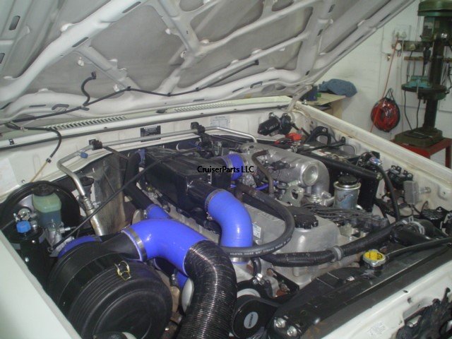

I stared at the kit for three weeks and the first problem I noticed was there seemed to be no room for the intercooler's heat exchanger and oil cooler (for the centrifugal supercharger). I can't figure out if their pic is of a Cruiser with no A/C or what. Too stubborn to call them and ask.

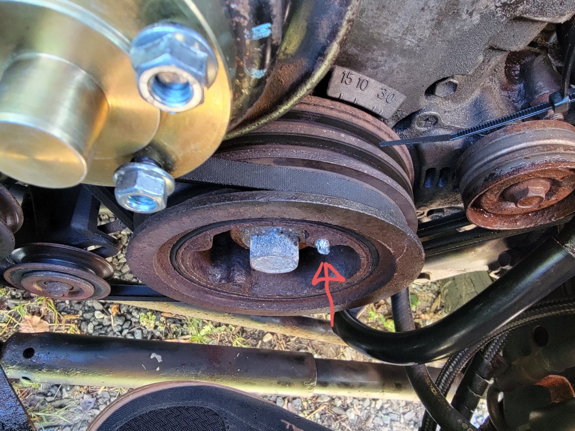

Decided since I had the radiator out and had easy access that I'd go ahead and bolt the pulley for the SC to the crank pulley. Couple of bolts, no problem. Funny enough the crank pulley only has two holes which I found strange (anyone feel free to enlighten me about this). Still haven't decided if it's necessary to drill and tap two more holes. Anyways I ran the tap through the two holes to clean out the rust and detritus of 25 years. Then as a test fit just snagged up the bolts, and the second one snapped.... seriously. I wasn't torquing hard, just snug...
This sucks....
The bolt was so defective that when I got the extractor in it, it wouldn't come out in one piece. Seriously soft. I am not going to trust any hardware supplied with the kit now. Got a chunk of it out but eventually had to very carefully drill out the remains and clean chunks out by flushing the hole with WD-40, my wife's tweezers (don't tell her, please), and running the tap through a few more times.
Finally clean! (Took all morning).
Seriously reviewing my life choices right now...
Pic of the pulley as it sits. Have ordered a new transmission cooler core from summit racing which by my math should barely fit with the new cores (as long as I delete the stock center support) and hopefully cool as well as stock.

One of the photos on their site shows it installed on a non-distributor motor. The US never got this and wonder if it will bring some challenges.
Post more photos of the setup and best of luck!
As far as the non-distributor motor, the throttle body appears to be in the same place which is good, and could've been a major hurdle. The only thing that concerns me is hooking into my stock intake, but my hoses look completely different from those pictured (which is a good thing), so I'll know when I get there I guess.

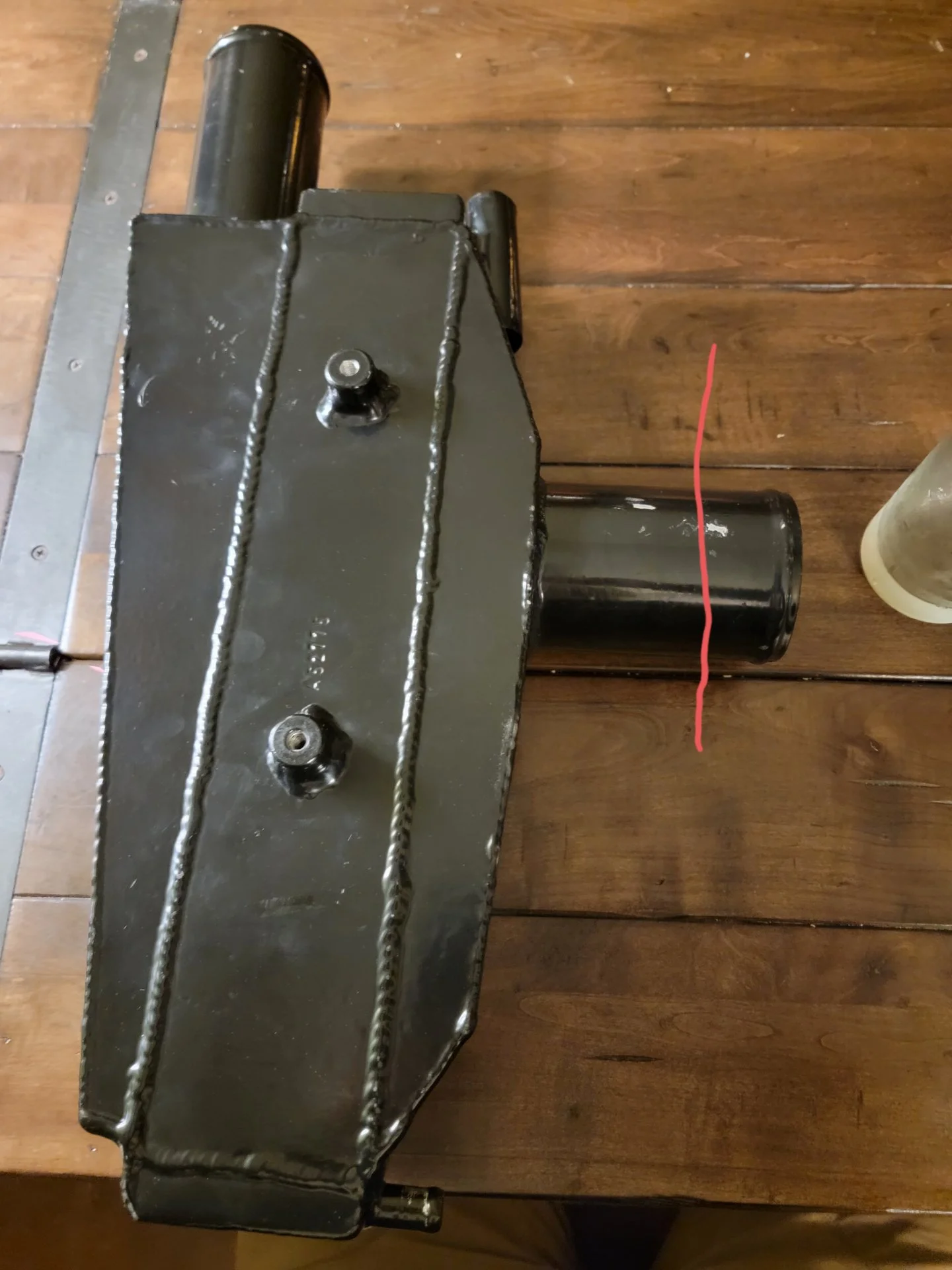

Largest of these is that the intercooler heat exchanger absolutely will not fit. I give up. No way. I thought it would fit if I deleted the center support (which the trans cooler is mounted on). I've seen pics of 80s with this deleted for full span intercoolers, but I neglected to take into account the hood closure mechanism. Not going to start pinning my hood for a questionable install, so I'm done with that. Strapped the original transmission cooler back in and was going to press on without intercooler for an initial test but I realized that the cooler I bought to replace the original transmission cooler will fit quite nicely and will suffice at least temporarily as a small heat exchanger for the intercooler. Fitting will now be easy, or so I thought....

At this point there's no way I recommend this kit for anyone with a US spec 80. It's not made for this vehicle, missing a few necessary (but easy to come by) pieces, and just plain not very well made (heat exchanger size, bracket fit and finish, etc).

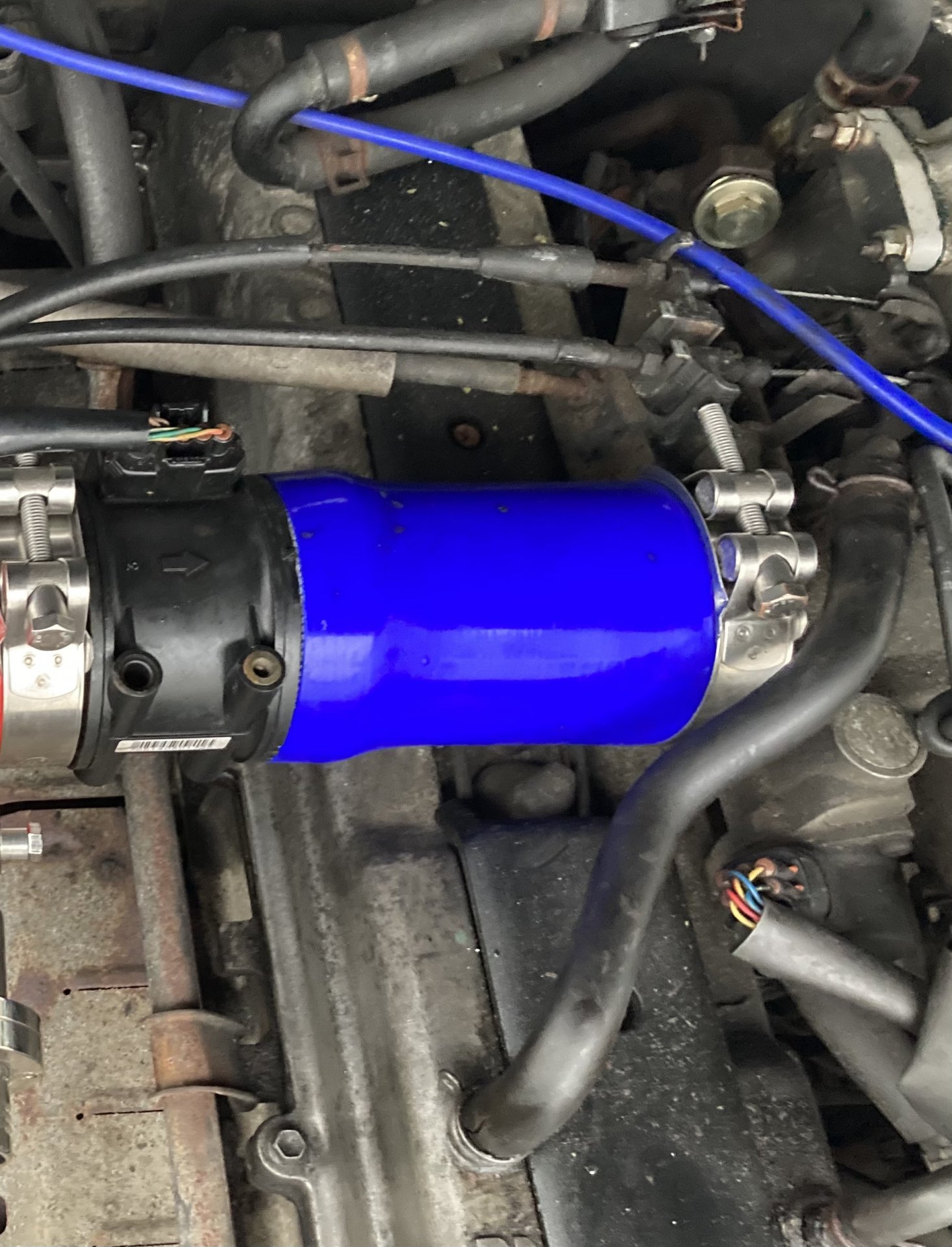

3. A 3” silicon sleeve will fit the MAF. This pic shows a 5mm thick, nylon reinforced hose. I had to chamfer the inner diameter, warm it in boiling water to soften it and apply some lube (soap) to assemble. I need to fit the clamp.

Amazon really came through. Have a silicone 3.25 to 3 inch reducer arrived today (apparently this is a common problem). 3/4 to 1/2 inch barbs on the way (probably could've gotten at the hardware store but while I was loading up Amazon...) Bosch wiring harness already arrived. Plan on tying it into the switched power source in the hood fuse box and add a fuse there. I seem to remember there was at least one blank slot left.

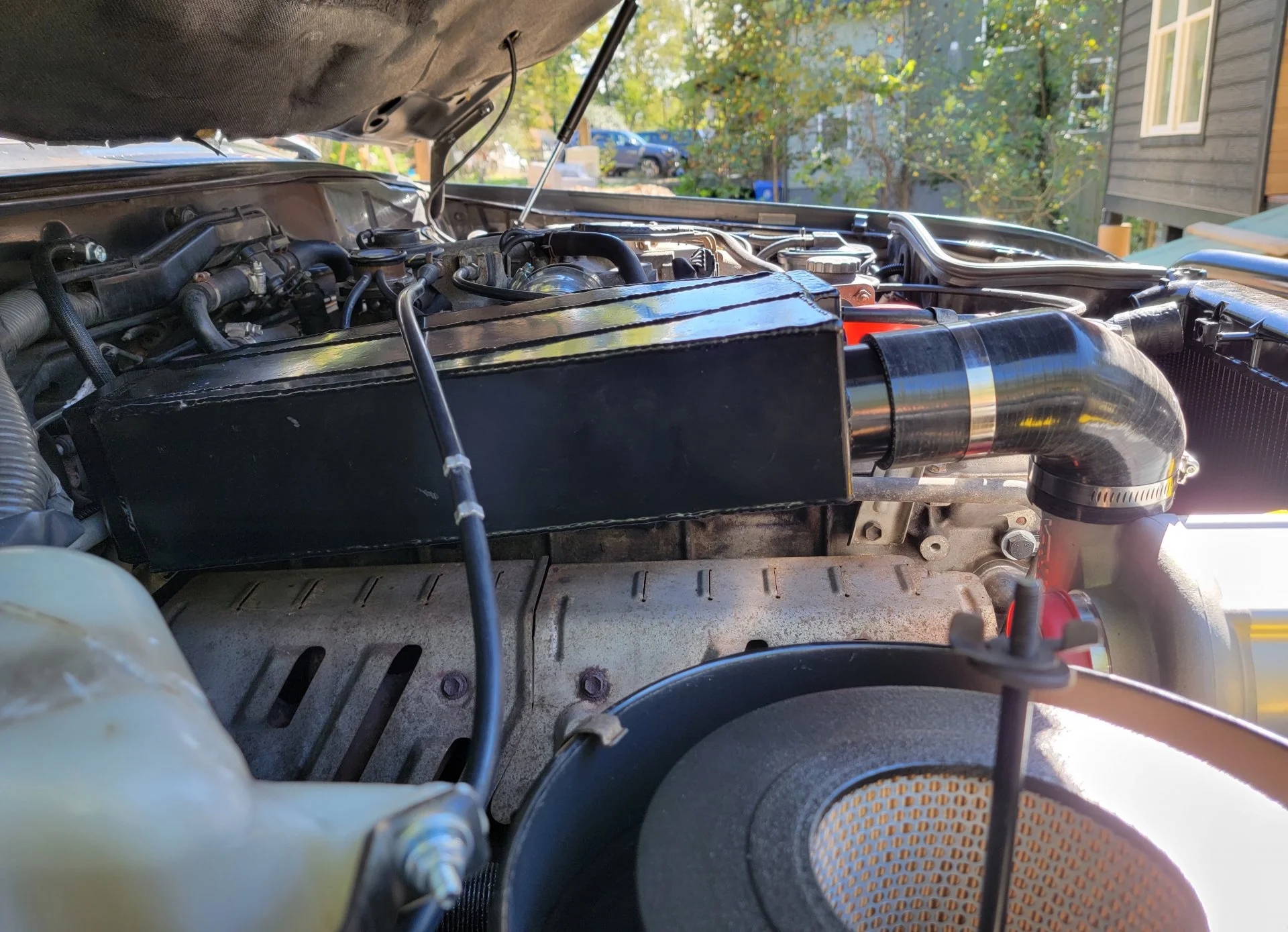

Revisited the wonky intercooler mounting and realized that I was using the wrong bracket. Found the nice beefy correct bracket and realized that the intake is actually in the same place in both this version and the distributor-less models.... with one tiny exception. The throttle body seems to be about an inch or two further towards the passenger side in mine. This means I either will have to put spacers on the mount for the intercooler (which will interfere with the heater line) or cut off two inches from the supplied intercooler which leaves me with no lip for the hose. Gotta do some research and see how important that is for a good seal...
in the picture with the MAF sensor that vent pipe needs to be plumbed in pre-compressor otherwise you will pressurize the block and oil with start spraying out of your dip stick .
With that hose routed correctly oil vapor will now enter the system pre-compressor as it should but with the MAF sensor post vent it will get contaminated by the oil vapor and stop working in short order. So the MAF sensor needs to go pre-vent in the system.
what you need to do is face the air cleaner toward the rear of the truck, put the MAF sensor back in it's place and come out of it with a 180* U pipe above the exhaust manifold and facing toward the intake of the charger. Now you will need a section of 3" pipe that has a hose barb on it for the vent.
For now I'd skip the intercooler completely and just focus on getting the engine to run.
