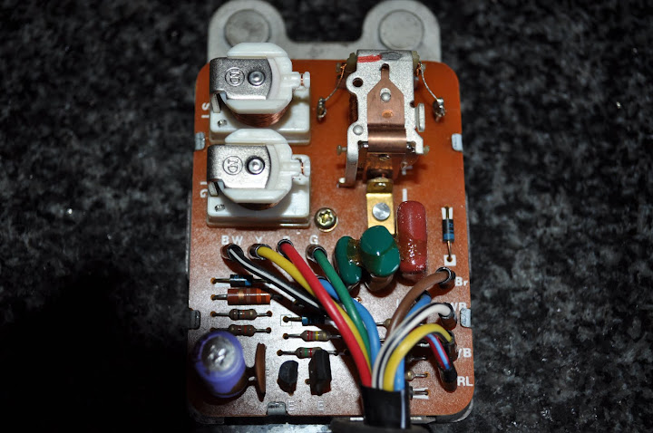

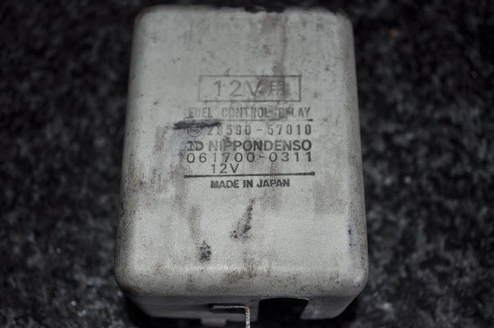

I started with this test IH8MUD.com - View Single Post - EDIC Relay Oil Pressure Timer Repair first and there was no clicking of any kind at all .
Then I did the resistance test as suggested by Tom. I used a digital multimeter and these are the results. (I do not claim to understand them :hillbilly:)
Resistance:
S - M = 0,00 which then changes to 0,L(default reading when switching on the meter )
ST - E = 10,25 k ohms
With + voltage to ST and IG and - to E:
Resistance
S-M = 0,00
0,I - M = O,L
In order to rule out FCM failure(and to satisfy Tom:D) I put some + voltage to the FCM,s M terminal and moved the edic arm back to the original "Stop" position. Before doing this I moved it to the drive position and made sure that the connecting rod was 100% positioned between the marks. I did adjust the lenth of the rod by about 2mm. So the FCM motor operates as it should .
Disconnecting the starter solenoid in order to avoid cranking the engine also showed no movement on the arm.

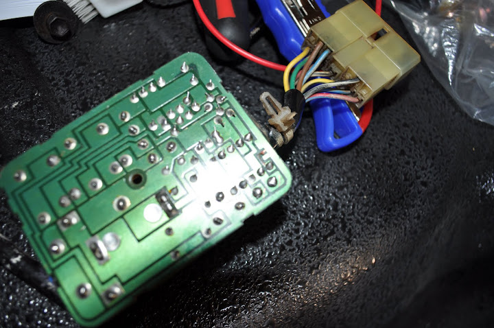

The only possible "fault" that I could find was this broken line(on the circut board) in the bottom right corner which I will try to solder and then test again but I( am not holding my breath.
I will order a new FCR tomorrow :confused:
Solder a wire jumper across that pcb trace tmarx, using just solder is not strong enough in such a case (although I can't really make out which bit you are talking about).
edit: the trace that runs around the board is earth.
