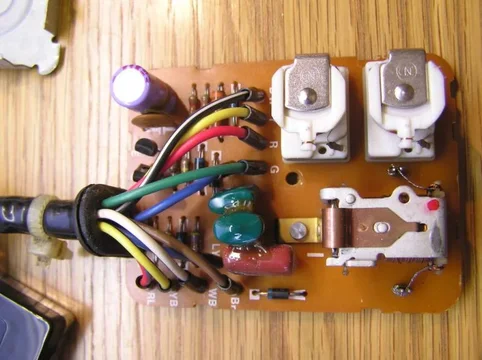

:hhmm: I might as well throw this question in here.

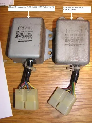

Has anybody any ideas about whether there are any internal/operational differences between these two FCRs:
All the photos are from Tofudebeest .........I stole them from this thread of his:
https://forum.ih8mud.com/diesel-tec...8260-oil-pressure-switch-edic-relay-what.html
Apparently he was sold the 28590-57010 FCR as a replacement for his damaged 28590-56090 FCR. (I understand he never got the 57010 to work either - and that he thought the reason for this might lie elsewhere.)
My guess is that the only difference is the mounting bracket. (One is attached to the side and the other is attached to the top.)
As he points out in his thread - the connectors are identical.
Even if this post generates no replies/ideas ..... I think it is still worthwhile putting the images here to show the different mounting tabs. ;)

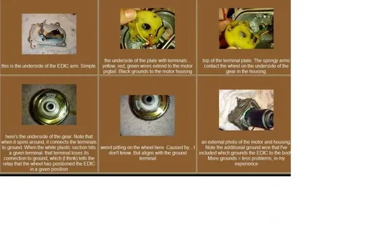

So here is some info he posted about the 28590-56090 FCR and the related FCM:
Google Image Result for http://www.sandcruiser.com/07pics/edic/p8240420.jpg
:beer: to Sandcruiser
(No need at all to dismantle this later model FCM myself now. :))

It is more than that Tom. Now Toy have come back to tell me that they can only supply me with 28590-57010 in mid Jan 2010:crybaby: . However they do have stock of 28590-56090. I am tempted to order it but are we sure that they only differ i.r.o the housings ?
Well I'd hate to be responsible for you wasting your time and money Theo. So I'm not going to put my neck on the line and say I'm sure.
But, it looks to me that if you were to grab that image off Sandcruiser's site showing the muddy internals of his 28590-56090 FCR, rotate it 90 degrees and place it alongside the image you posted of the internals of your 28590-57010 FCR ( post #22) - they'd be identical!
Tell you what - I'll do this tomorrow when I'm back on my home computer and post the result (unless someone beats me to it meanwhile). Then we can check if all the wires and components are identical between the two. (I believe that Tofudebeest has shown us already that the connectors are identical.)

Meanwhile - here are the 56090 (left) and 57010 (right) alongside each other. If I was a betting man I'd say they must be operationally-identical:
