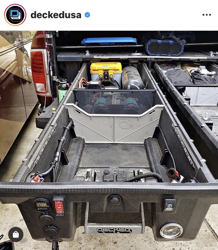

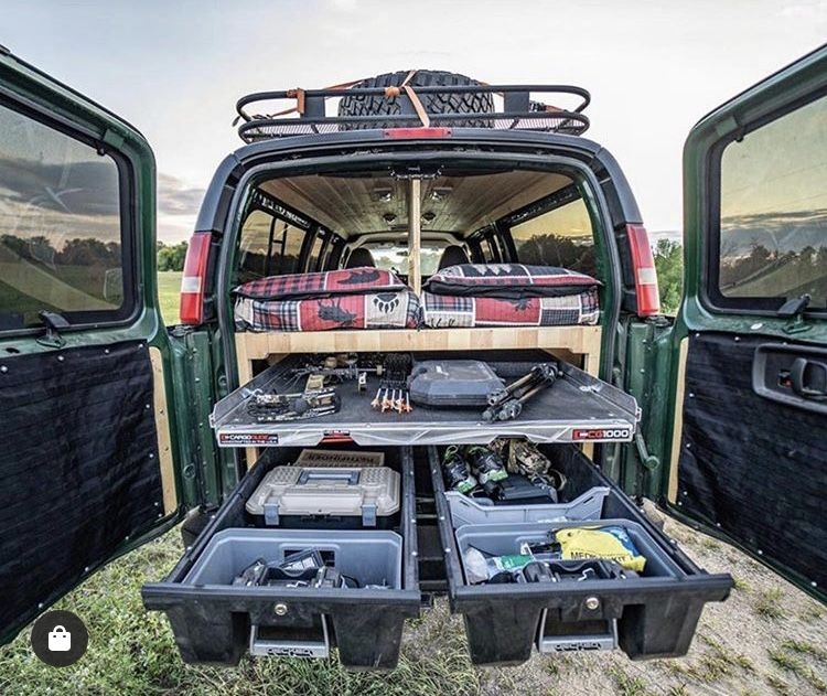

Checked out a few drawer storage systems. There’s the manufactured drawers made out of metal or composite. There’s also some smaller companies or DIY guys making them out of wood. Lots of things to think about and take into consideration. Weight, durability, and layout come first to my mind.

I’ve heard/read now several people who think the “Decked” systems waste space. I’m not familiar at all with them or seen any in life to make any real observations. I think it’s just the idea that gets the ball rolling as far as what to come up with if choosing to go DIY. Kinda like their simplistic slider system which may be easier from a maintenance point of view, but can see how you lose some space with their drawer shape.

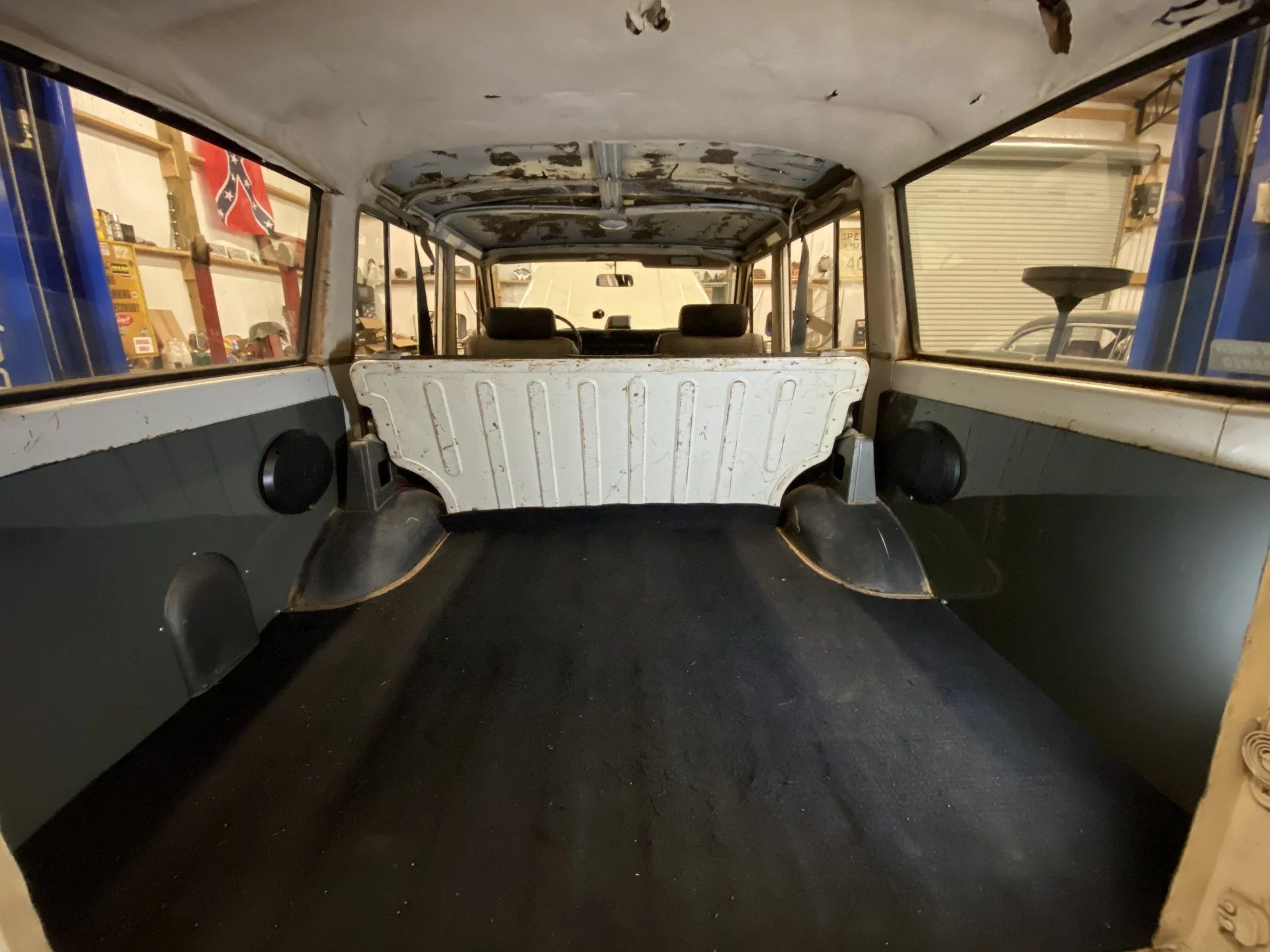

It’s roughly 43” - 44” from the seat backing to the tailgate opening and almost right at 41” between the wheel-wells. The wing areas behind the wheel-wells to the tailgate are roughly 9” x 28”. Common ammo boxes measure out 7-1/2”H x 12-1/4”L x 6-1/4”W. If that was your “thing”, you could fit a couple of these in the “wing” spaces. So maybe a platform height of 8”.(?)🤔
Raised platform fastened to the floor, hinged “wings” behind the wheel wells that can flip up to access stored boxes or whatever (access platform fasteners). Drawers below.
