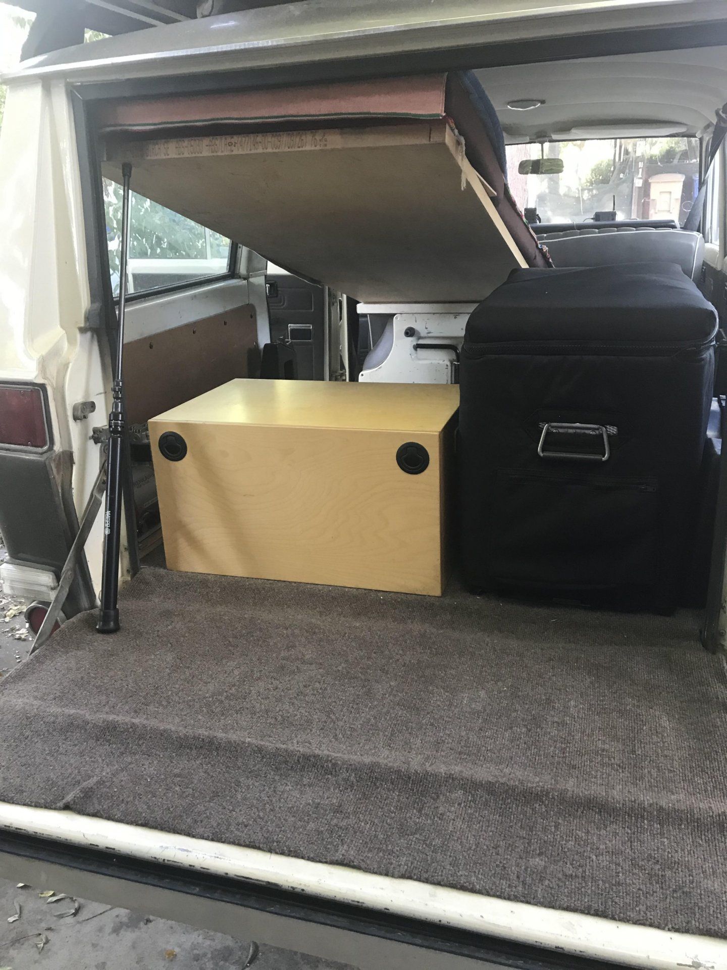

Other materials to consider,
- deck material: hollow core birch 1 3/8" doors come in many widths, cut to length easily and easy to cap the end if needed. A 3/4" sheet (4'x8') of ply is 75 lbs. The equivalent amount of surface area using hollow core doors is half that. And hollow core doors don't flex under weight. Birch holds varnish better then Masonite. My bed platform is 6' long and only supported an each end.
For me: in order of design importance;
1- the cook box (or drawer) in conjunction with the refer (cooler). They are by far the most used and frequently accessed components (other then the steering wheel). Accessing food and drink happens a min of 3 times a day (drink probably more🍻) Quick and easy access(set up), and pack up.
2- accommodations whether interior or exterior is the next consideration. Easy access and set up
This cook box has a 1 burner stove in it
3- now the rubex cube puzzle:
Cook box with 1 burner stove in side

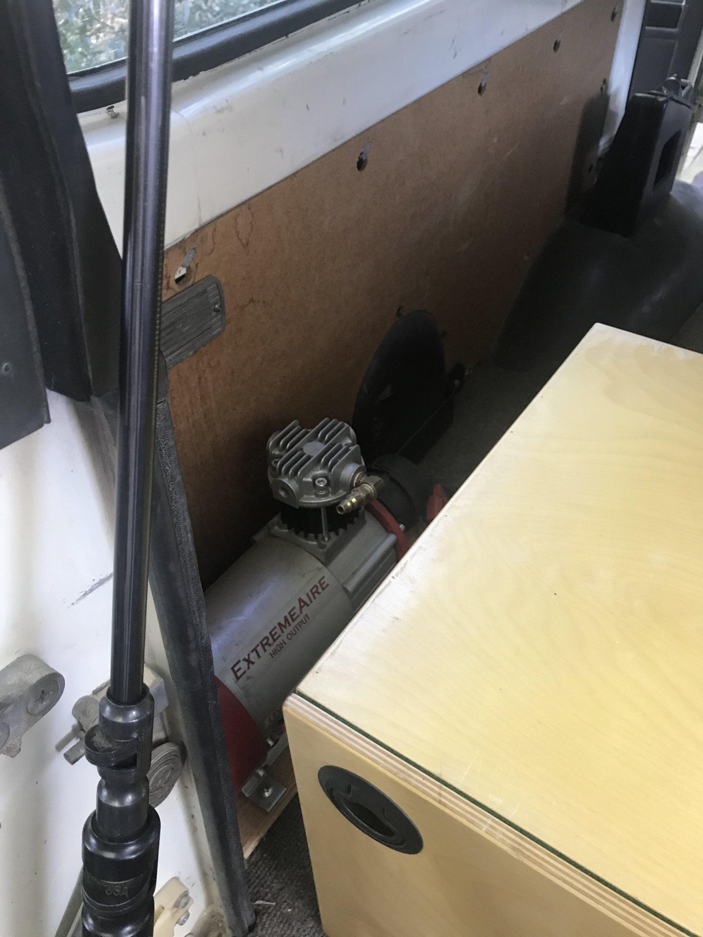

Second 18.000 btu 1 burner stove, solar controllers on cargo panel

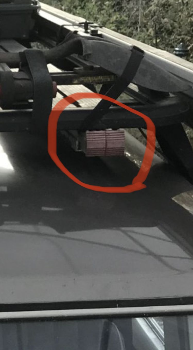

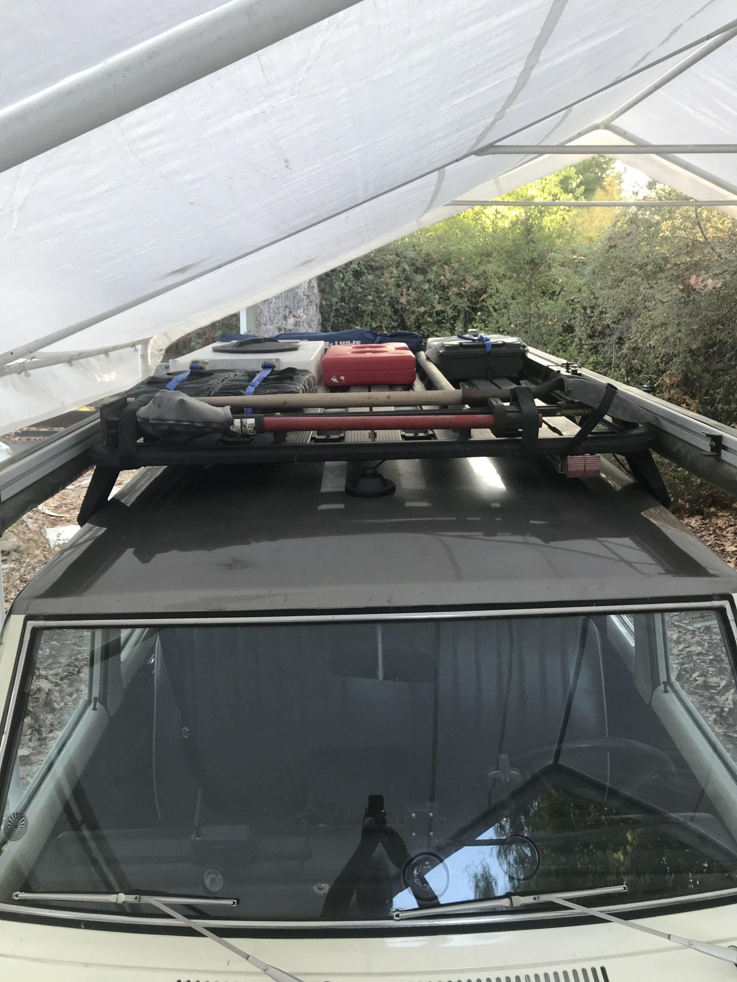

Roof rack carries the 2 awnings, 11 gal anti slosh water supply with 10' hose, 4 gal gas: got me through Magruder corridor, 2 pairs of sand and snow tracks, toilet and waste storage, axe, shovel, and highlift all under 6" tall.
That’s a nice setup Gordon
