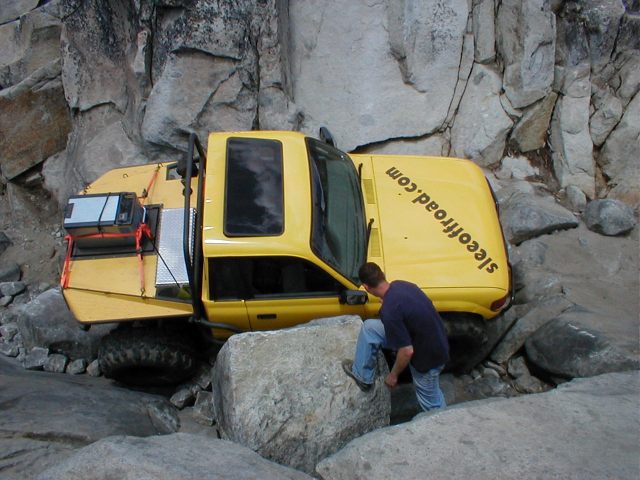

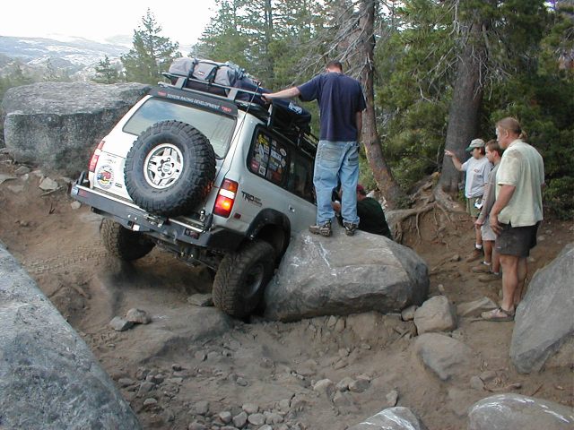

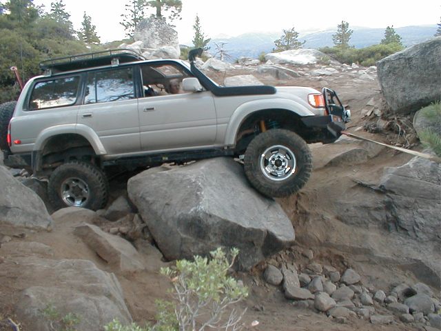

But it is so nasty that nobody in a SUV tries it. I finally did it in my 80. Then I led a buddy up it. It's one of those things that's so risky I could hear you (and all the Rubicon Trail wackjobs :D ) say...."a 100 can't make it". Well guess what? :)
In fact, I'd luv to see a pic from the Rubicon Trail where a 100-series had to complete something as difficult and risky. Forget big rock pics. I wanna see a rollover risk, 6-foot tall ledge and vehicle-height rock climb while straddling a 4-foot deep crack pic. One wheel 4-5 feet off the ground with the slider keeping you from rolling. SEND YOUR PICS! Come on Doug, Amando, somebody.
That's cute.
And just one more example of how little you know about the Rubicon Trail.
Bring your 100...hell...bring your beater 80, then talk smack.
...but until you're willing to put your money where your mouth is and run the trail...you're doing nothing but blowing smoke outta yer ass...
