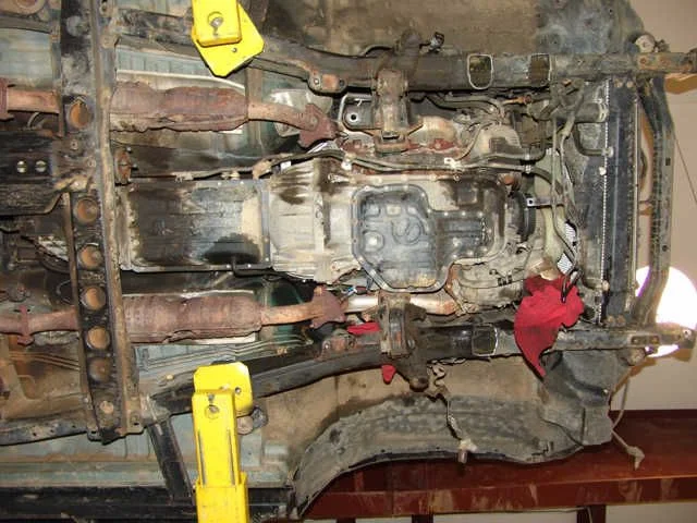

SUCCESS! Today after doing a rear-main seal swap, we threw on a rear D/C driveshaft. YES!
0-60 MPH is 90% better!
60-70 is 80% better
70+ is 70% better
No speeds have GRRRR!
At the latter speeds some vibes are to be expected.
Around town there's simply NONE! I can actually hear the 4.88 whine for the first time. :D
So that's it....I'm keeping this gem and there will not be a 2nd 100 for awhile!
Thanks to all for the help along the way. :beer::beer::beer:
