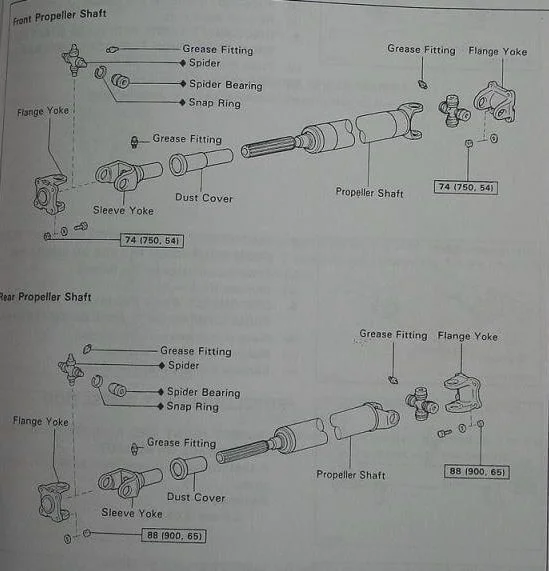

#4 is easy to tell based on the diagram in the FSM or the one posted in the driveline FAQ

I think that if the rear driveshaft is not mounted in-phase you will have the vibration and grrrr you describe. That was my experience.
See Romer's post. If your rear driveshaft is even a few degrees out-of-phase you could have problems. The marking it won't matter all that much as long as you conscienciously (sp?) line up the splines.
