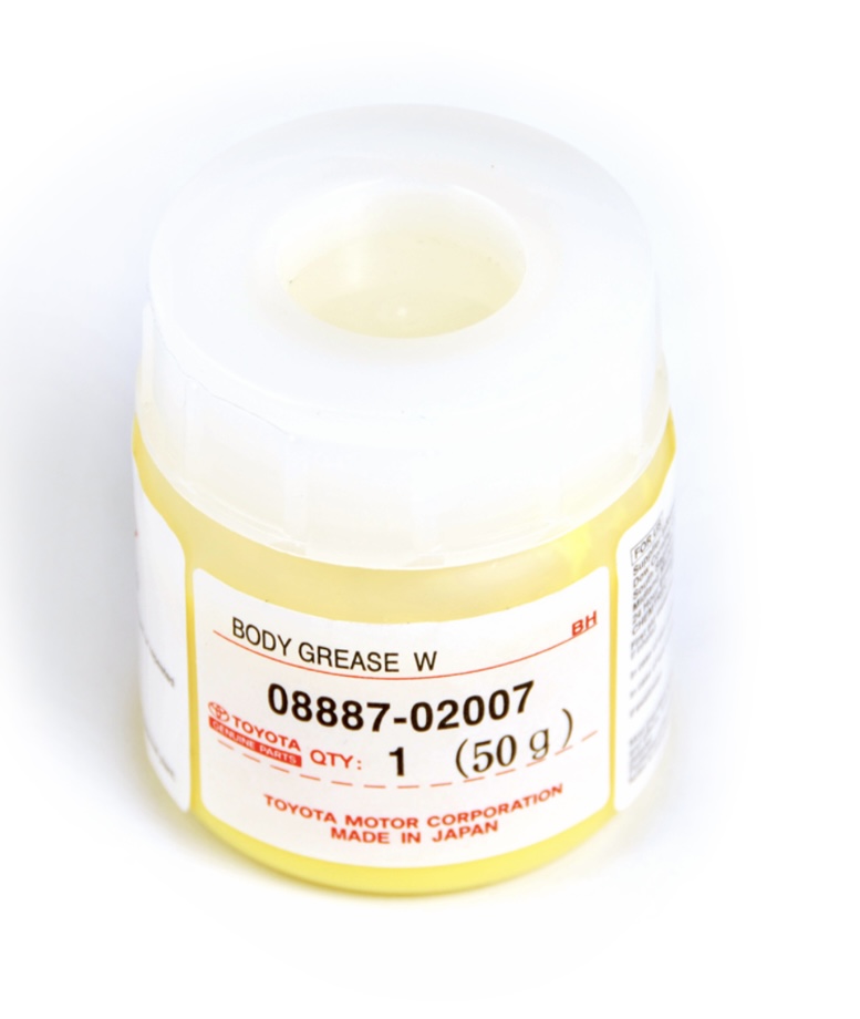

But you know what's in the lock cylinders from the factory? Some kind of heavy multipurpose grease. Mine was pretty hard and waxy feeling, and had clearly mostly been washed out of where it was needed anyway. Here's what a brand new lock cylinder looks like (from the complete cylinder and key set p/n 69005-60330):
i.php
I bought the entire lock set because my driver's door cylinder's dust/water shield was broken, and the ignition switch felt sloppy and would stick, even after multiple attempts at lubricating it. Once I priced a lock cylinder, an ignition cylinder, and re-keying, it quickly approached to price of the entire new set!
