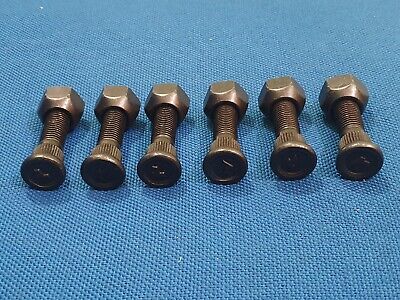

Hi All, I have super fat tyres on my 1976 FJ40. The rubber washer on the steering knuckle is precariously close to the inner rim of the wheel hub. It just about touches it. I am considering installing 5mm spacers but then I will need to remove the wheel studs and extend them for longer ones. Does anyone have any other good idea or know of a way to adjust the steering knuckles or steering rod to gain 5mm of clearance?

I’ve been running 1/4” aluminum spacers on the front wheels for 30 years and over 100k miles. I didn’t need to extend the studs, but I can’t say if your’s will be long enough. Probably at 25 years for the 1/4” spacers on the FF rear.
No problems whatsoever.

I had similar clearance issues on my 76 and sometimes wood or other debris would get pinched in between the rim and rod end off road. Installed some 1/4 inch spacers on all 4 wheels and have plenty of room now. I didn't swap
wheel studs as there seemed to be plenty of threads left for the lug nuts. Bought them from JT Outfitters for $6 each a couple years ago and they have worked great ever since.
