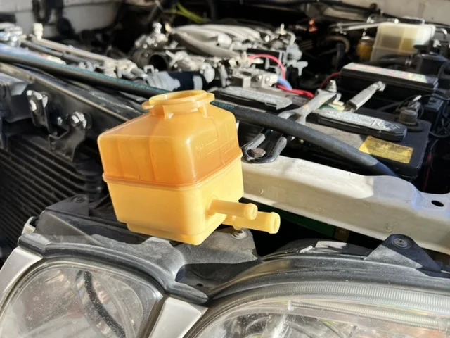

I have a new OEM reservoir on order. Should I flush the old fluid before putting the new reservoir on? Also, any tips on replacement? Is it just a given that it will make a big mess?
Yes flush before you hook up a new reservoir. Putting the old one back on would be akin to doing an engine oil change without changing the filter.

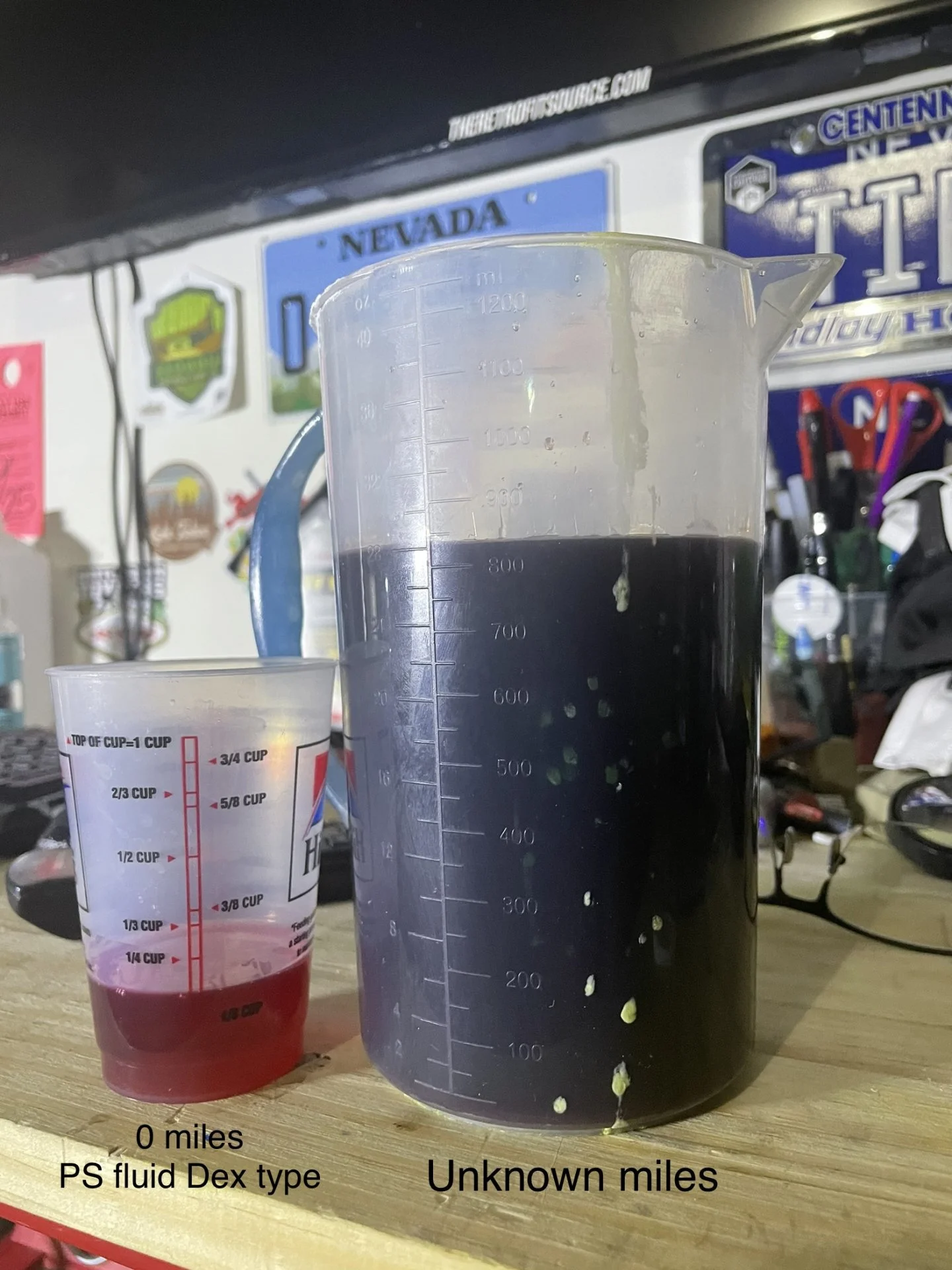

Old ps fluid:

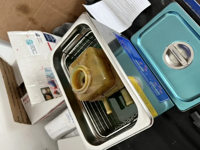

I changed the hoses and cleaned the reservoir with an ultrasonic cleaner. Used some 5/8th and 3/8th hose to replace the 24 year old original stuff. Getting the old hoses off was a pain, I ended up cutting the line at the pump to get it off. Then putting the 3/8th line back on the metal line was super tight. I used a heat gun to warm it up and a little silicone lube to help. I sprayed out the reservoir with brake cleaner first and then put it in a water and simple green mix in the ultrasonic cleaner. I messed with that for about an hour while getting the hoses off and it came out pretty clean. Getting the tires off the ground was a pain in the ass though. But its all done and no more squealing! Thanks for all the info in this thread.

  1. Ultrasonic cleaner. I use a Toyota coolant jug with top cut off. Add cleaning fluid and reservoir into it. Placing that, into water filled ultrasonic cleaner setting water level to top of basket.

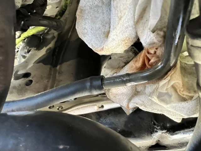

  2. 98-02. I use 3/8" ID ATF cooler hose. I make sure to push rubber hose, on all the way to the stop of lower hard line (in your picture shows it about 2" short of stop). Some 3/8" hose OD is large enough for OEM clamp, which I prefer. Other 3/8" ID ATF cooler hose, have smaller OD. I use fuel line clamps, in those. They wrap hose 360 degree, without digging in to rubber.

that pic with the hose not all the way on was just when I was struggling to get it all the way down. I heated up the hose with the heat gun and now its all the way down and has a spring clamp on it from mcmastersons. I should have labeled that better. Anyone reading DON'T STOP until its all the way on the fitting and secured with a clamp of some kind. I've got to take the intake manifold off soon to repair a knock sensor wire, I'll take some completed pics and update my post.
