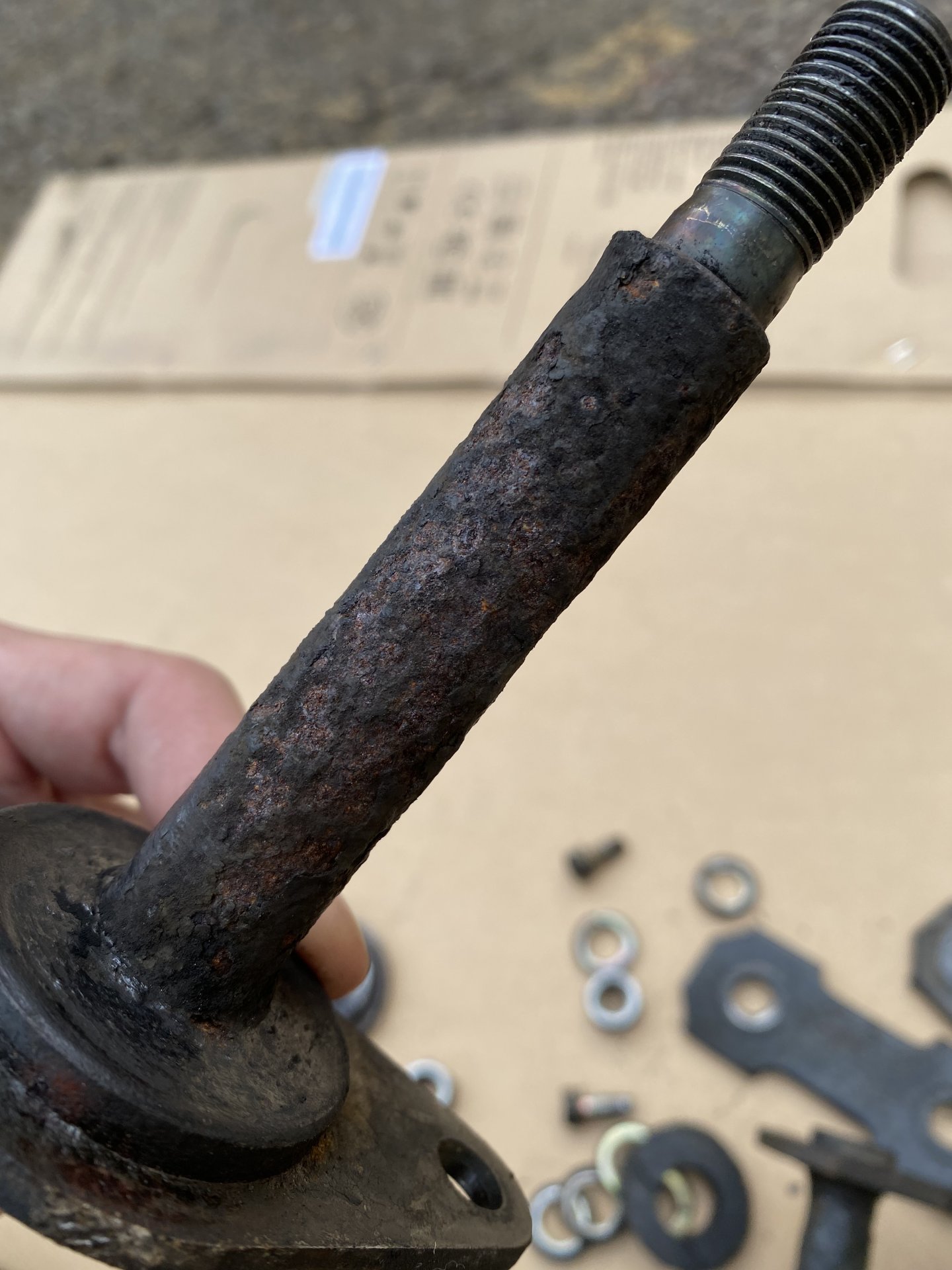

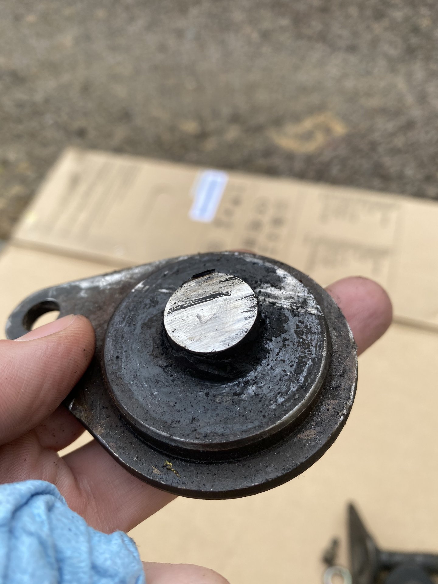

Mine were so seized that I had to use a cut-off wheel on my angle grinder to separate them from the frame. Center pins rusted, expanded and became one with the hardened rubber. Sawzall won’t cut the pin so don’t bother. I was fortunate that the springs were being replaced so I could get closer to them than the frame. It would be difficult to cut between those and the frame without any resulting damage. I tried everything else, cut-off wheel was the only solution. Assuming the springs are free… Then if you want to remove them from the spring eye, you will need to drill out the rubber, use heat and a hammer then clean out the remaining bits using drifts/chisels, small rotary tools, whatever it takes. Good luck
One side freed from bushings, one side had to be cut to remove spring from frame.
