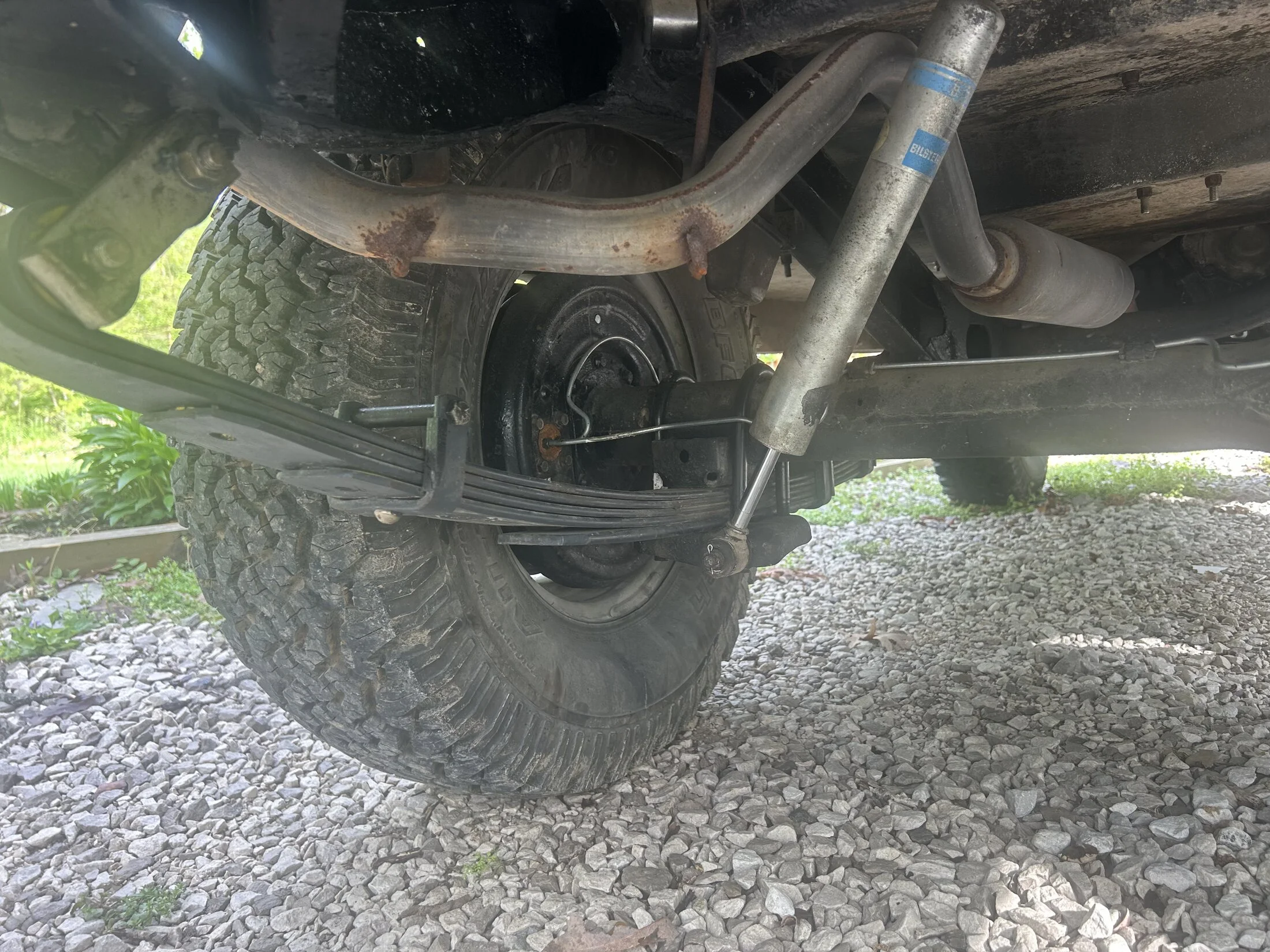

I just did this on my 40. 2.5 ome lift. Bottom 3 off the front and one off the rear leaving the overload spring. Sits level and the shackle angle is better. I have 31/10.50 bfg and it looks just a bit taller than stock. Flexes better too. Pic with the doors off is before I removed the springs. Hope this helps.

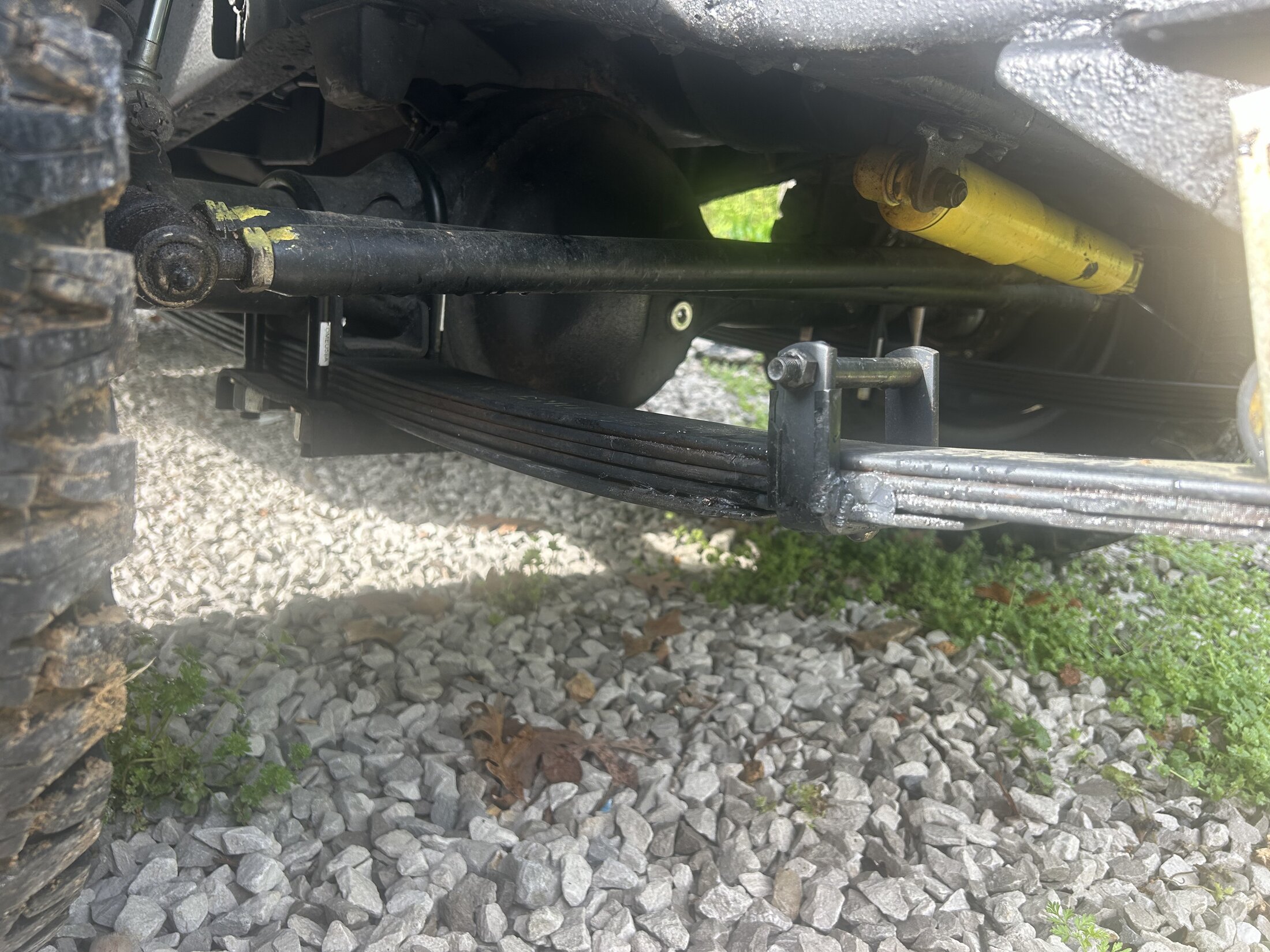

Can you take a picture of the springs so we can see what that looks like? I would have been scared to take 3 off at once
2f motor, warn 8000 and aluminum tub. Sits and rides nice.
Very nice - thank you! I have some unknown springs on my mine and they seem to be good quality but maybe a little stiff. something I'll be looking at in the future

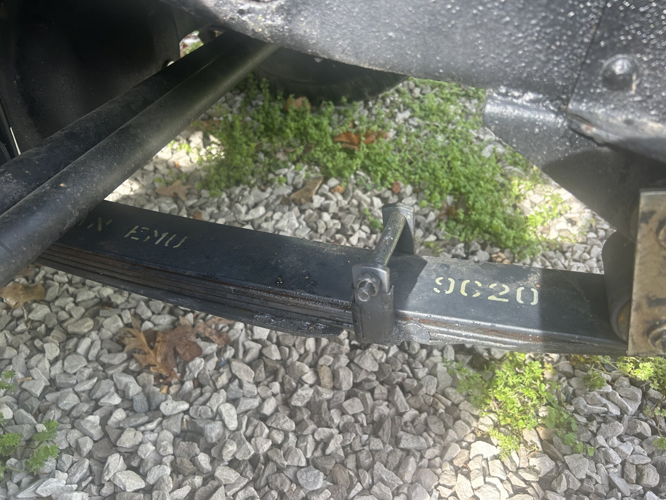

Can you please take a picture of the front spring pack at the axle? Thanks

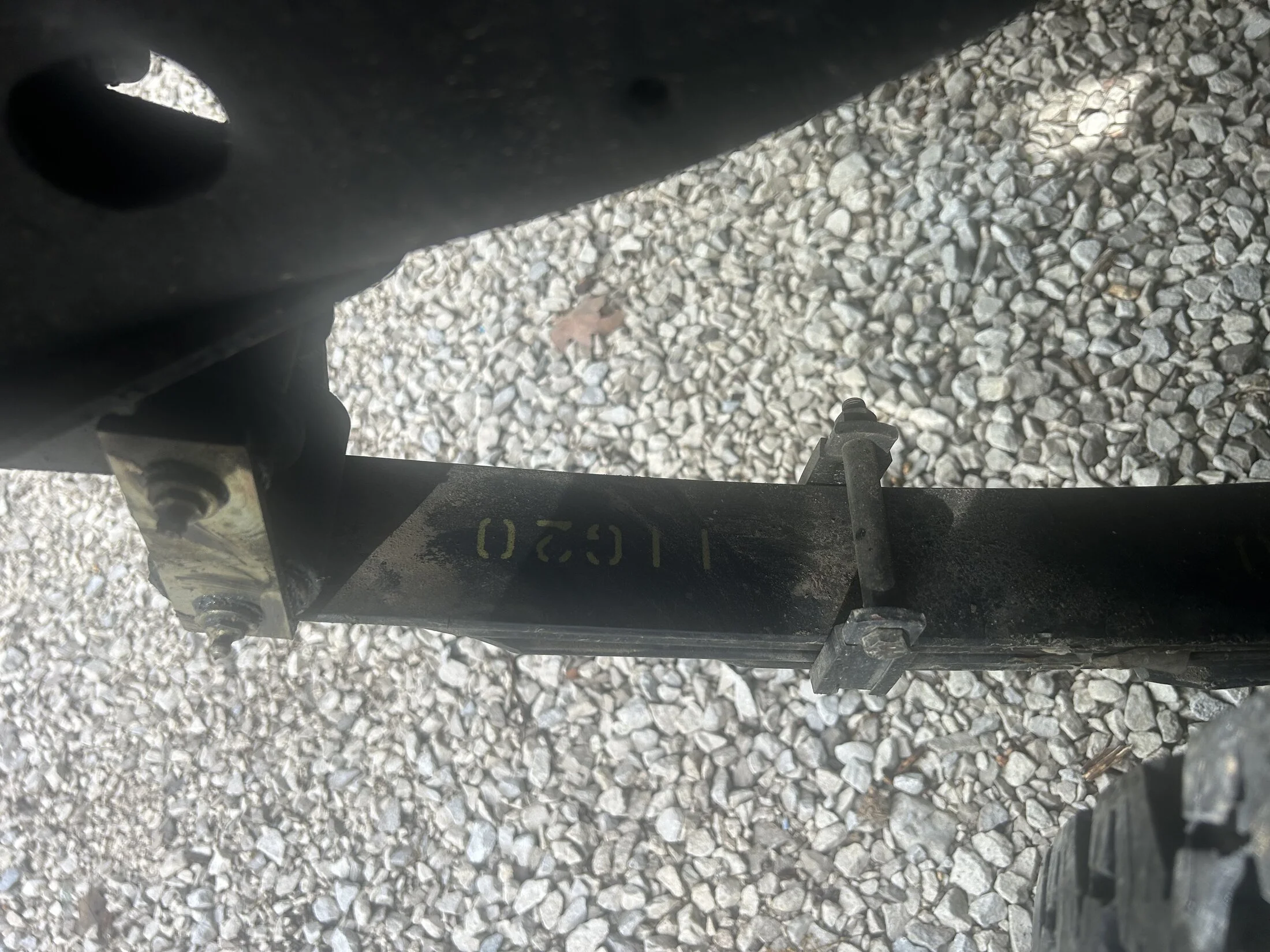

Can a rear leaf spring be put on backwards and cause the angle of the back shackled to be different as well as lean to the left? I have a HELL FOR STOUT lift with leveling block on the RR spring but the LR still 1.25" lower lean and what appears to be a more compressed? angled shackle
