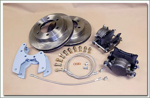

Hey guys just wanted a variety of opinion and possibly experience if anyone as installed the Speter Off-road rear brake conversion kit? Pros? Cons? Solid upgrade? Better off going big some other direction? Appreciate the hell out of everyone on here. Great community!

Sorry, yes it’s the kit converting the rear drum to disc brakes. Just wondering if it’s money we’ll spent. Or not a noticeable difference.
this one right? Land Cruiser Rear Disc Brake Conversion Kit - https://www.sor.com/cat292.sor
$800 is a lot of money and you will also need to replace the factory parking brake with something else. You don't have huge tires or lift, do you not stop properly? I'm SOA, on 37s, and still have factory drums but fronts have new rotors and using 4runner calipers...my truck stops "fine."
If you suspect your brakes aren't sufficient, try upgrading the fronts; better bang for your buck. If you have $1000 you can disappear with no problem, get those rear discs! :-)
I'm a firm believer in OEM parts but only go with aftermarket if they are proven and an improvement. Over all drum brakes are MUCH more durable. They will last longer and you will have to work on them less often if they are set up correctly. Granted there is a learning curve to pulling shoes and getting the springs back on.
So while disc brake pads are much easier to switch out, they will have to be replaced more often. Then there is the unknown of how good their calipers will hold up.
For $815.00 plus shipping your close to buying a nice pair of sliders.
I'm guessing this is the old Monte Carlo brake replacement. I did that on my FJ40 and it was OK, not great, but OK. However, that vehicle has the parking brake on the transfer case and the conversion only cost me a few hundred dollars. My thought is that with this one, you spend over $800, get little or no improvement to braking performance, and lose your parking brake? No thanks.
