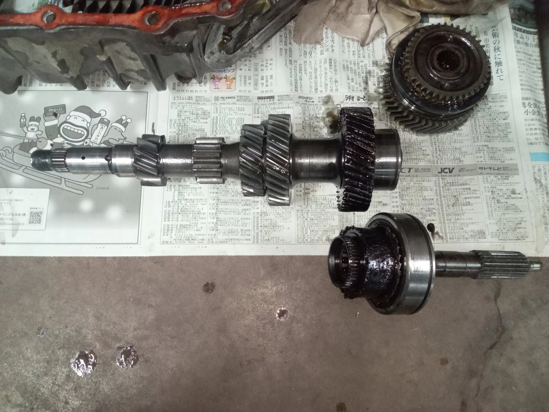

My transmission died on the highway while my wife was on a 5 hour drive to pick up her family from the airport!
I'm actually based in Japan but the garage says that they can't source replacement parts. Maybe the Aussies are buying them all up?
It's a 1991 Prado LJ78W with 2L-TE engine and R151F transmission.
The garage says the input shaft (33301-35050) & counter gear (33421-35130) are no good (teeth gone?)
They tried to find used parts in Japan, but I have a feeling the forum users might have a better way of sourcing parts.
Any tips on finding replacement parts or advice is very welcome.

if that came apart like that I would recommend getting a complete good used unit and throwing everything else in the scrap.

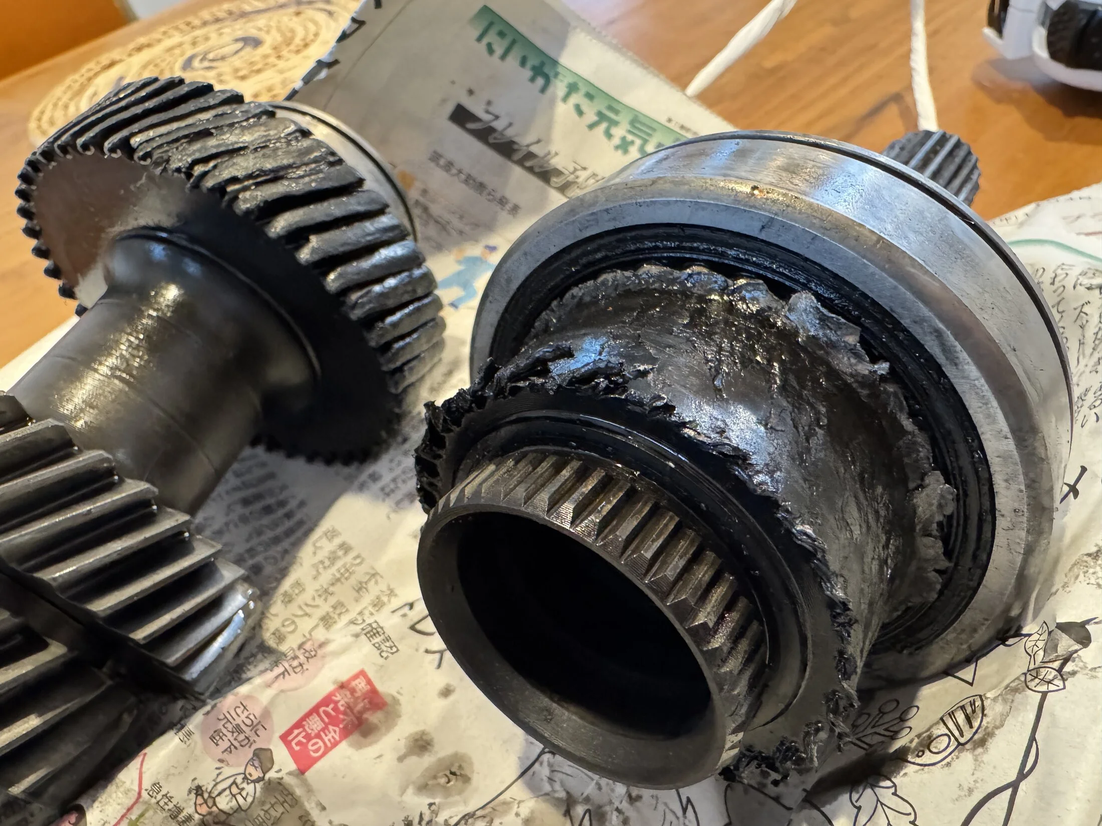

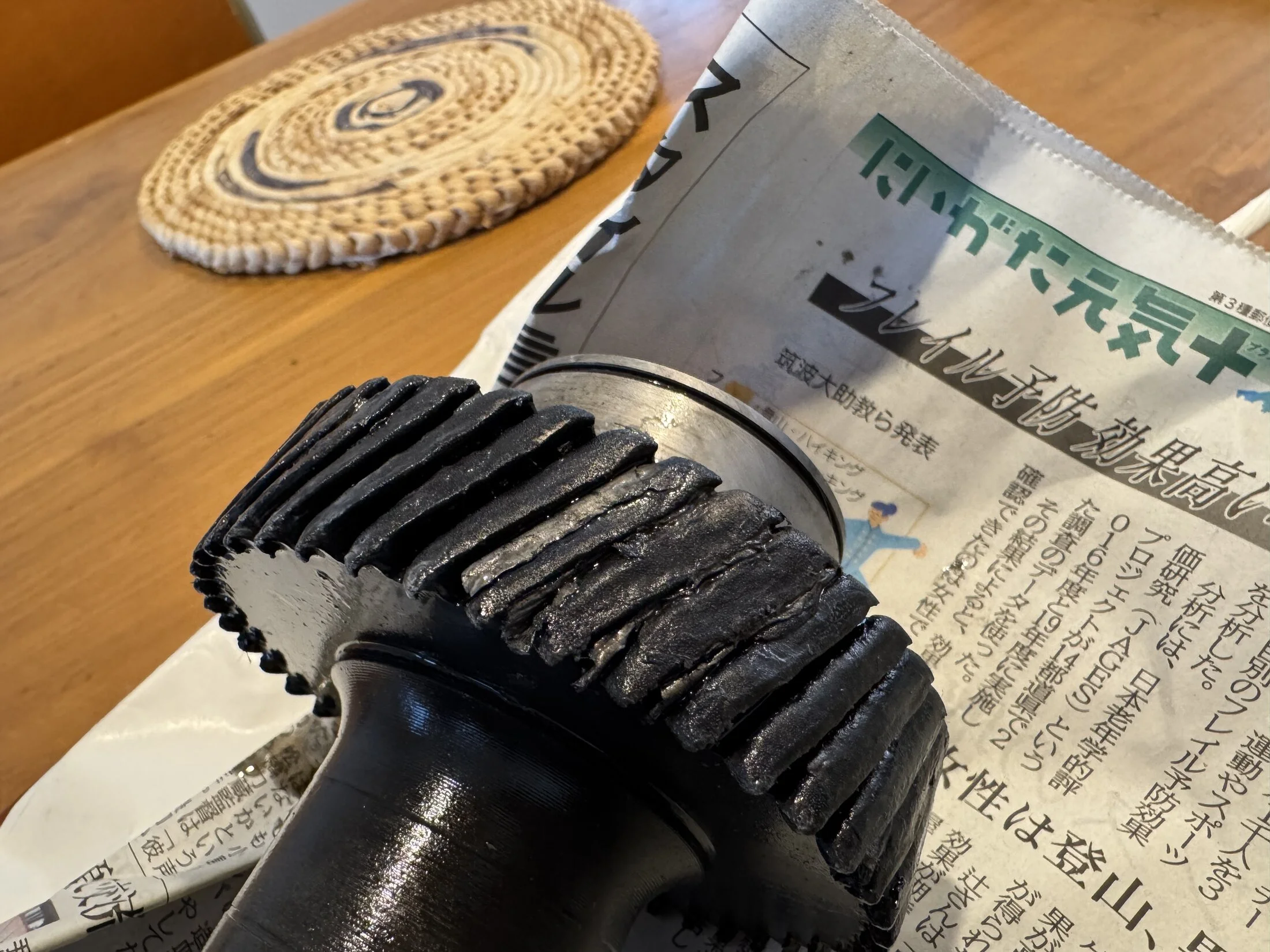

the counter gear looks like it has heat damage and the input shaft is almost smooth where there’s supposed to be gears.

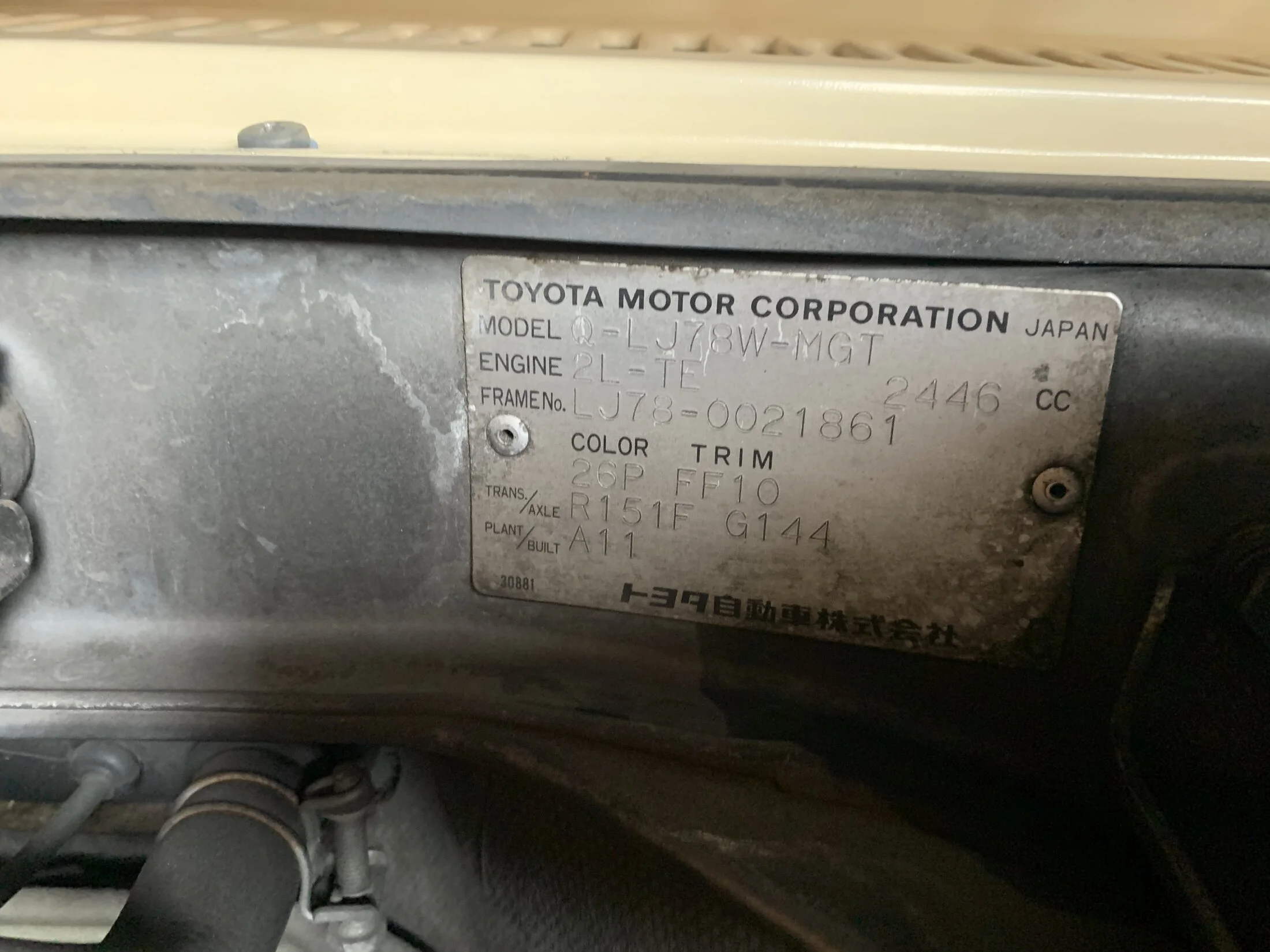

As @cruisermatt said your best bet will be to find a good used transmission and replace the whole thing. Are you sure yours is an R151f and not an R150f? I'm pretty sure the LJ78 came with the 150 and the KZJ78 used the 151. Either transmission would work (given the correct year range and transfer case setup) but the 151 has a lower 1st and 2nd gear ratio.
That was run without oil for awhile. Scrap it all and replace the entire unit.

Thanks. The manufacturer name plate identifies the transmission as R151F (pic attached).
How can I be sure an old R151F or R150F will fit? Do I just check that it had the exact same input shaft part number?

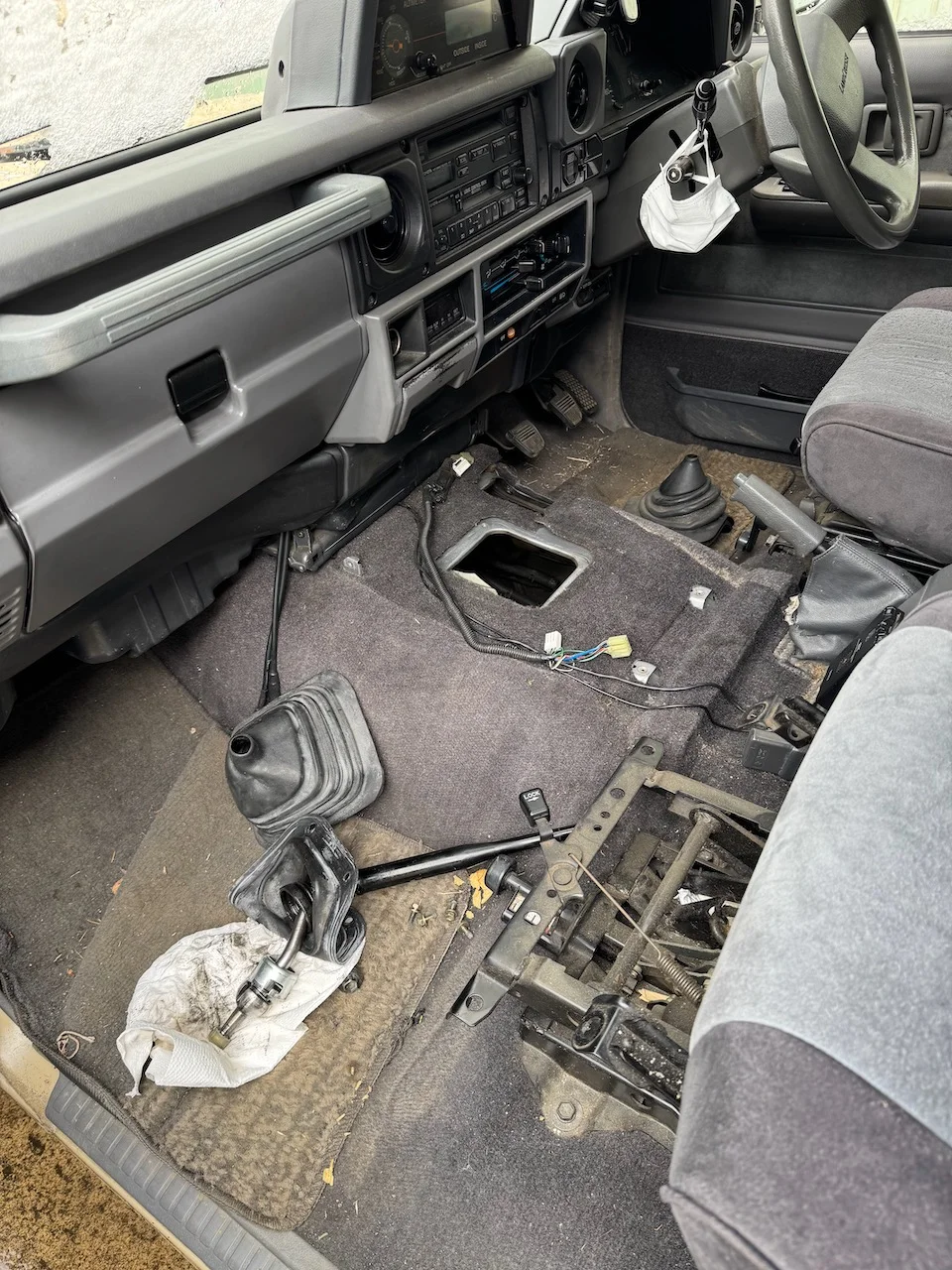

I found an old transmission on ebay.
Seller isn't sure what vehicle it came out of ¯\_(ツ)_/¯ but it does say that it's for 2L-TE engine.
The obvious difference is that the front drive shifter is in a different position.
On my LJ78, the front drive shifter is forward and to the right of the stick.
I **think** I can get this and maybe my transfer case will fit on it.
Any advice is very welcome !!
You should be able to disassemble the transfer case and transmission and separate them at the intermediate plate (the steel plate between the transmission and transfer adapter) and reassemble with your current transfer adapter, transfer case and output shaft adapter.
