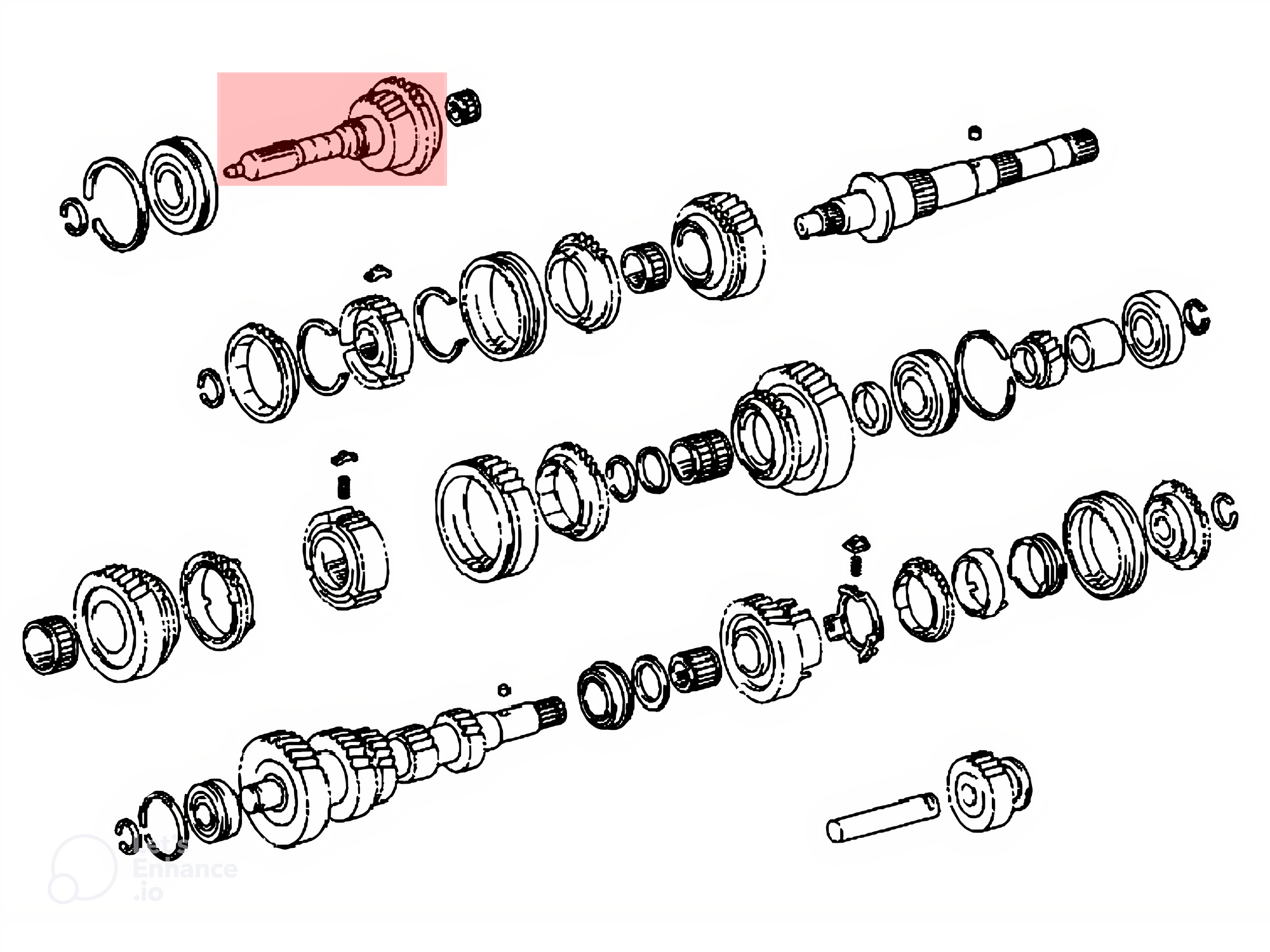

The garage says the input shaft (33301-35050) & counter gear (33421-35130) are no good (teeth gone?)

Counter gear - 33421-37130 Gear, Counter Toyota | YoshiParts - https://yoshiparts.com/parts/toyota-3342137130
Input Gear - https://www.ebay.com/itm/3327846496...pid=5337589904&customid=&toolid=10001&mkevt=1
