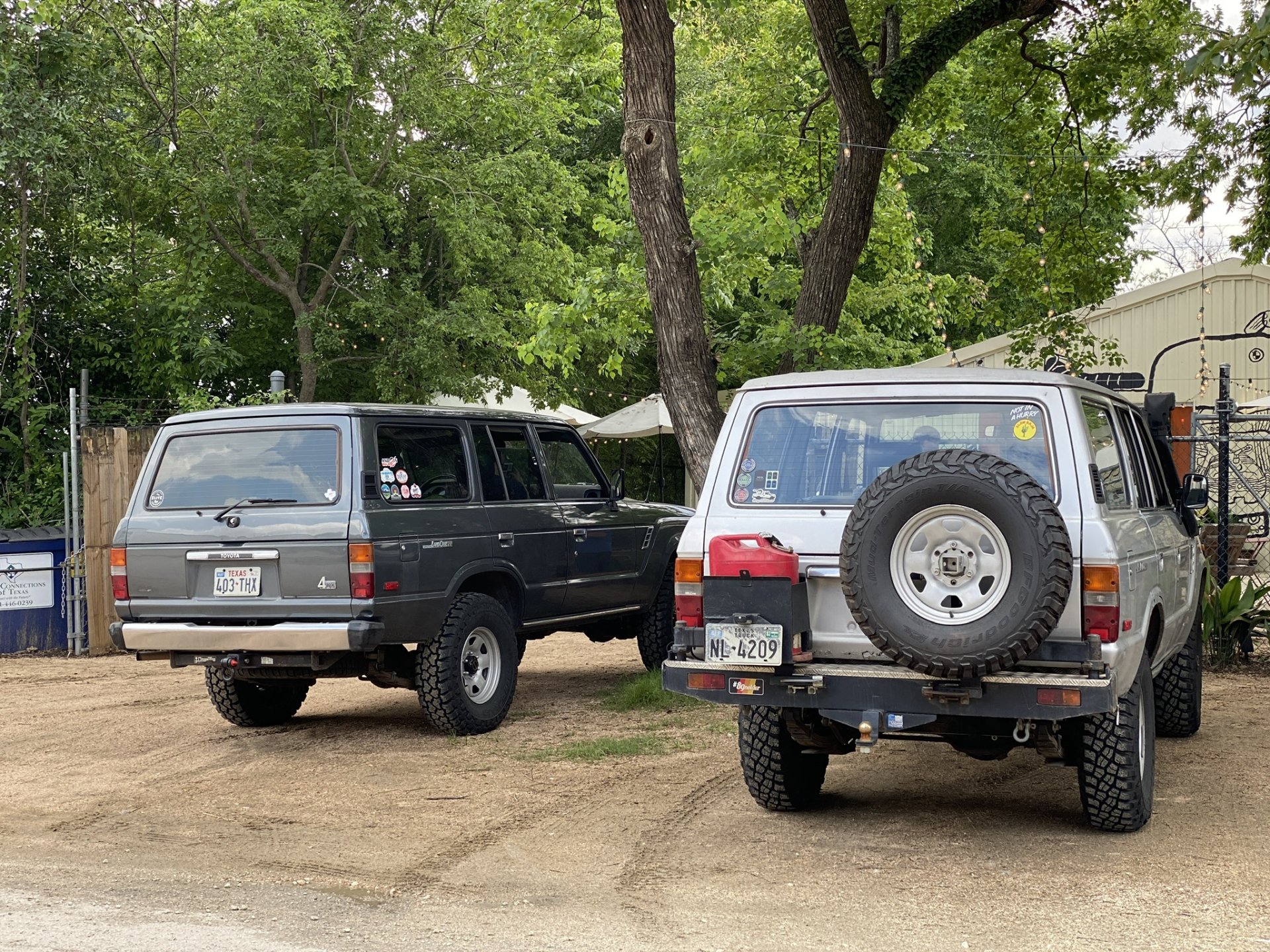

255/85r16 on a 70 series wheel. With both trucks. I’m on a 1.25” spacer in the first picture. Not needed but it looks good. I’m on km3.
I’d do a 235/85r16 in a heartbeat. 32x9.5r16 equivalent.
