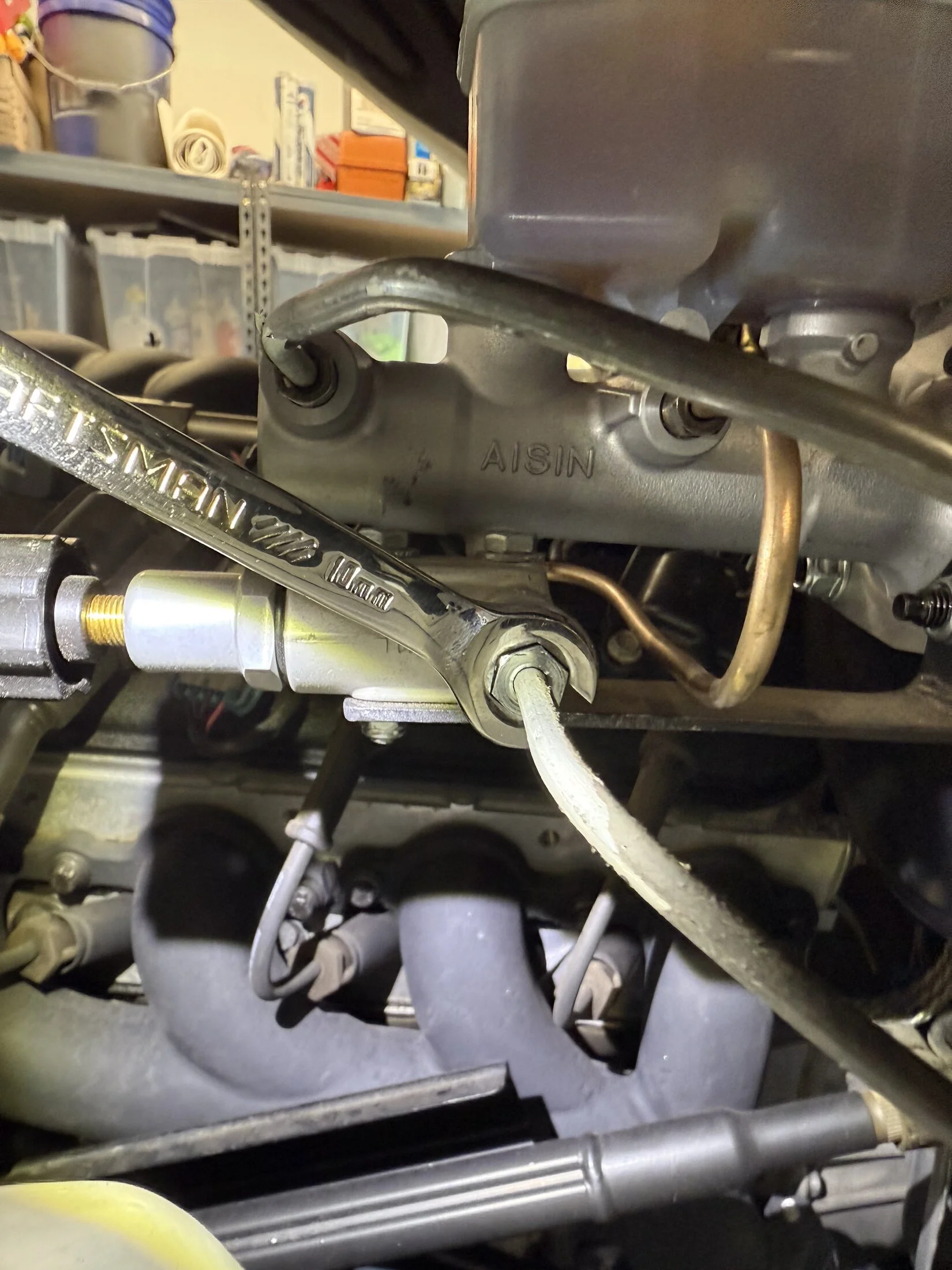

I need to make some brake lines and it's been a few years since I've purchased any brake line fittings. The ones I previously bought fit a 10 mm wrench. I'm looking for more of those, not ones with a larger nut size. Amazon has some but is there a better vendor for the brake line fittings? I have doubts about the quality of the Amazon ones but they may be ok.
But will a 10 mm flare wrench work on these or does it take an 11
10mm
