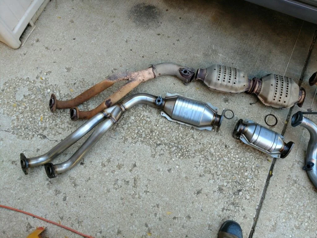

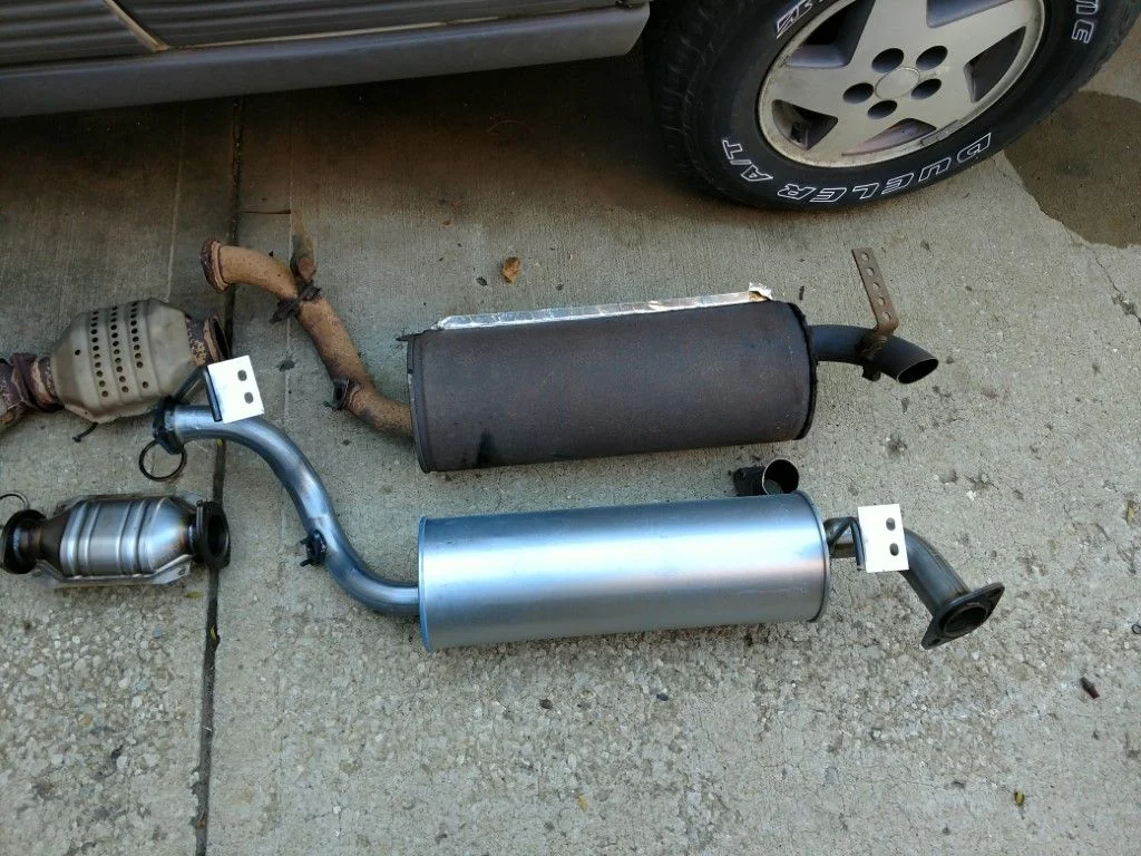

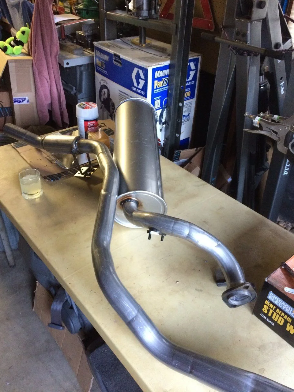

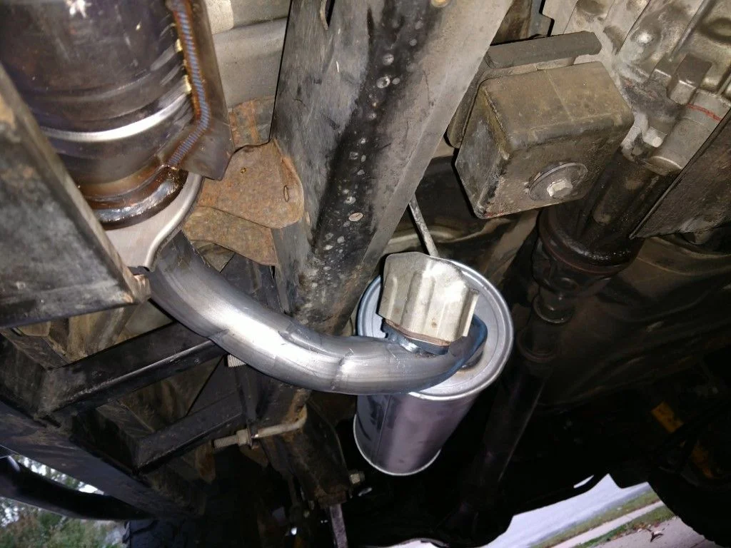

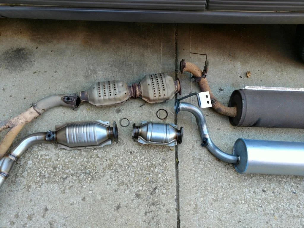

Also, I coated all of it with Hi-Heat (1000'F) clear coat paint prior to installing to help it all last longer. Because what was removed is all 409SS and what was installed is aluminized steel (CHEAP).
Fitment was about 8 hours start to finish, and I felt things went well, but I had ALL my parts for MONTHS ahead of time, and I ordered EVERY bolt, nut, gasket that I even THOUGHT I might need. I alo regularly soaked things with PB Blaster and I put it all back together with COPPER anti-seize.
