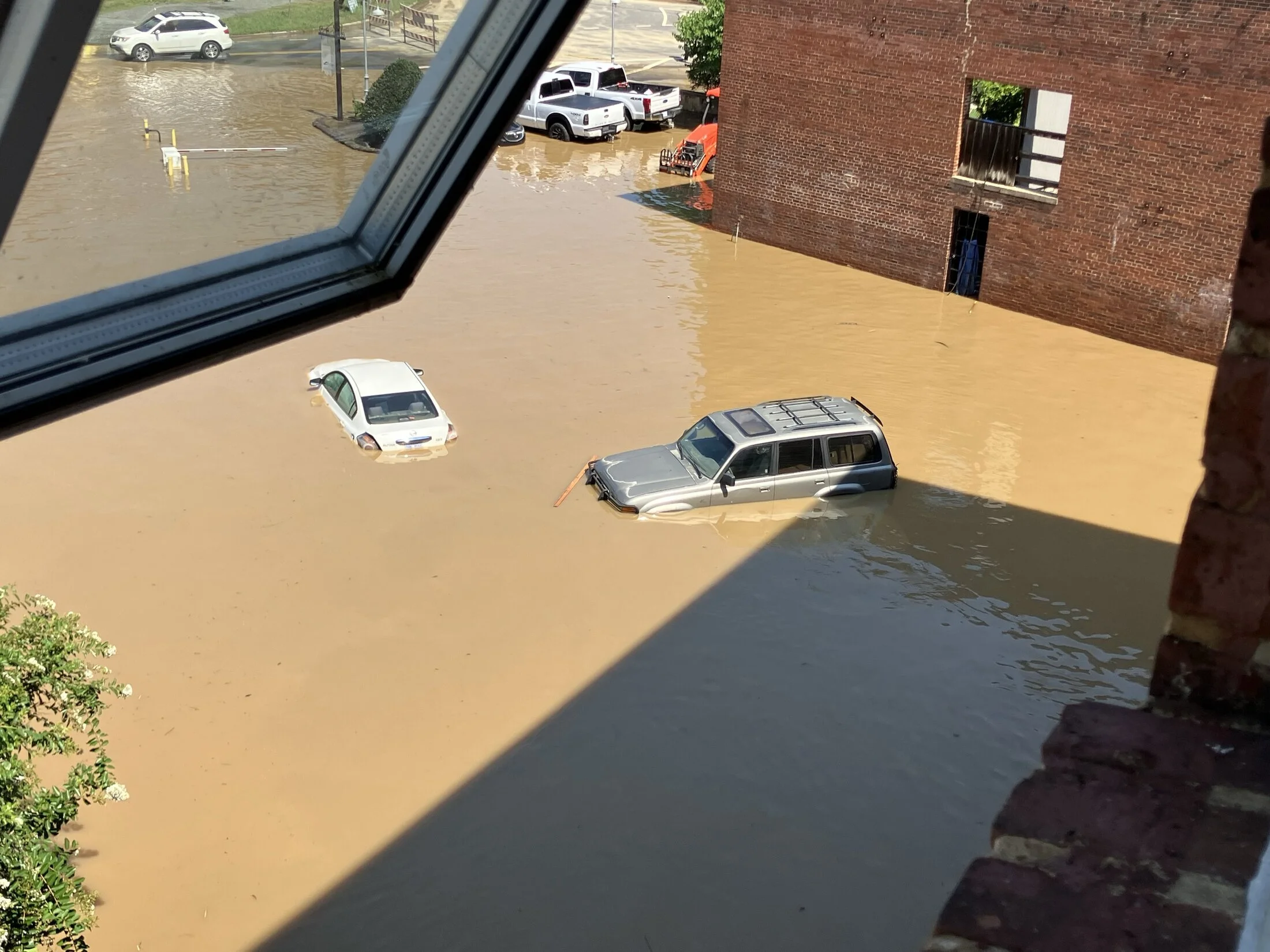

My 1997 Land Cruiser got caught up in the flood waters of Hurricane Chantal over the weekend in central NC. This has been in the family since new and I never had any intention of selling it. I remember my dad bringing it home in the late 90s and this is the vehicle I learned to drive in. Chantal dropped 8" of rain in Alamance County in a 24 hour period and the Haw River rose close to 30'. The cruiser never stood a chance and was entirely submerged for at least 3-4 hours. There is mud literally in the sunroof tracks. She floated about 15 feet from where I had parked it.

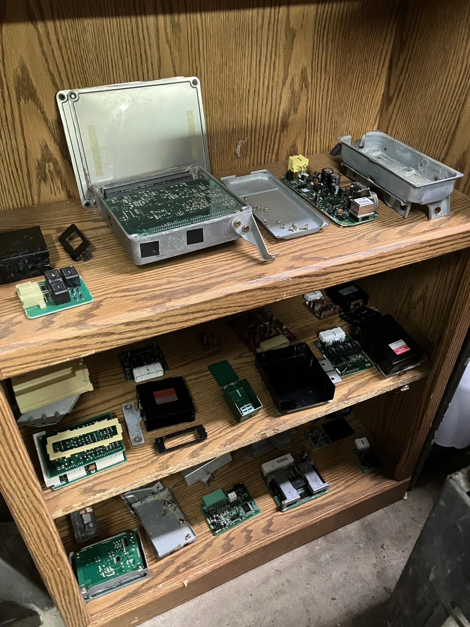

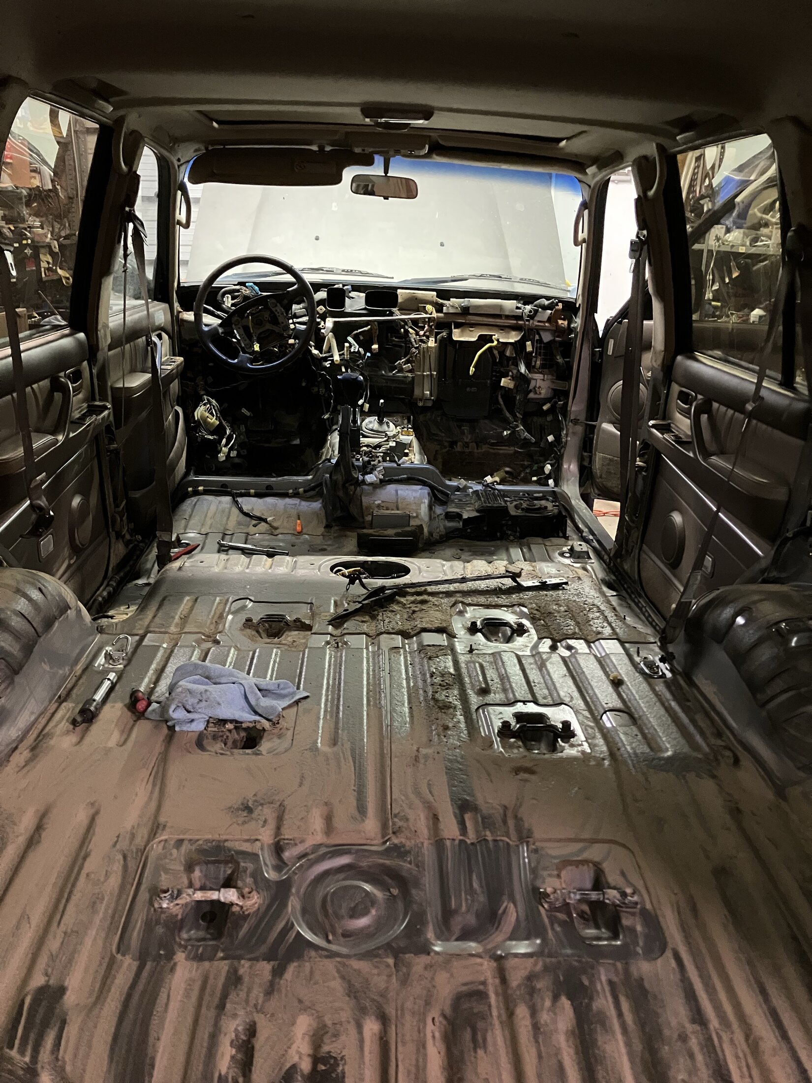

So far I've stripped out all the interior carpet and seats, disassembled most of the dash. Unplugged whatever connectors on the interior that I could get to. I've been spraying the connectors with fresh water and then drying with compressed air. I took apart the ECM and dried the best I could, its still disassembled. All the fuses were removed and relays got the compressed air treatment.
I pulled the drain plug on the transmission and refilled with about 4qts of ATF. Drained several quarts of water out of the engine and added fresh oil/filter. I pulled the spark plugs then turned the engine over by hand. Then I jumped the starter (which still works) and got the engine to turn over with the plugs out and ejected the water in the cylinders.
I pulled the fuel pump and inspected the gas in the tank which still appears to be clean. I drained some at the plug in the bottom of the tank as well and no water came out. Still need to drain the diffs and Tcase to inspect for water.
Any advice on what I should do before I attempt to start the engine? At a minimum what needs to be plugged in for the engine to run? I'm assuming if I can get it up to temperature and oil circulating that any residual moisture will evaporate?

I knew we were going to get rain but had no idea this was even possible where it was parked.

Here's where I'm at as of last night. Sad that this was a clean complete vehicle a few days ago. Carpet is just sitting outside getting rained on and drying out with the weather. I keep putting the seats outside in the sun, but we are still getting rain so lugging them in and out is a task. I might try to find a donor vehicle for replacement seats as I've never attempted to reupholster something. I think I got to all of the control modules, cleaned them then dried them back out. All the chips seem to have some sort of water resistant coating on them. This had the Auto Climate Control A/C which I'm sure is shot. Radio is trash. I'm going to try and clean out the instrument cluster today, she flooded with 342,389 miles on the odometer.
