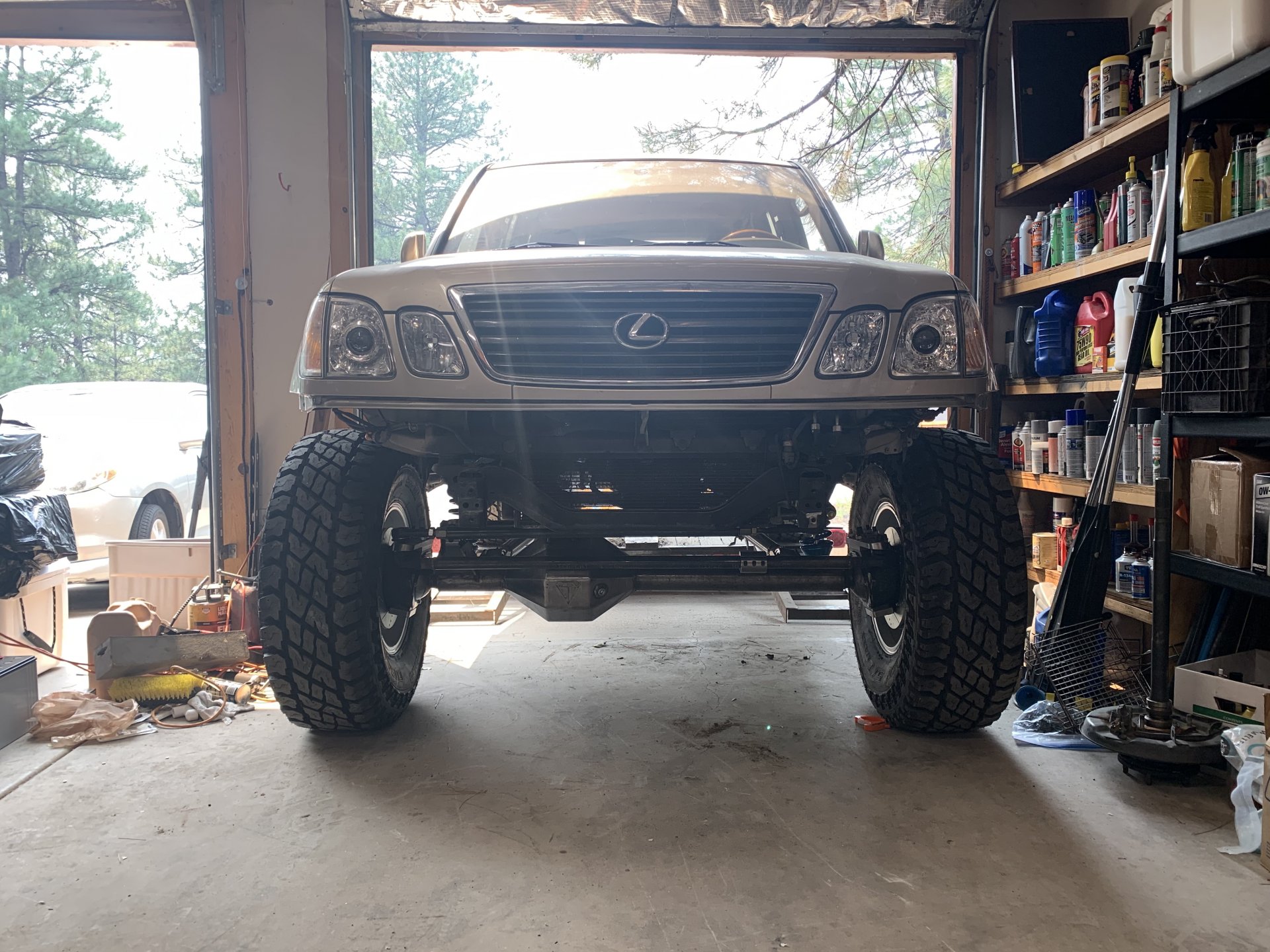

Not that I'm remotely serious about a SAS, but is it possible to SAS a 100 and not turn it into a "monster truck" so to speak or is the shape of the 100 frame the factor that necessitates 4"+ of lift? I'd be satisfied with a 2" of lift and 33-35" tires. (basically a modestly built 105)
Not if you want to retain uptravel. I moved the engine/trans up about an inch and notched the frame on the passenger side for drag link and panhard clearance. A combo of the frame and oil pan shape makes it tough.
Down travel is the problem with 100 ifs, uptravel is the problem with a solid axle swap.
If you are good with 33’s or 35’s, not a whole lot of reason to do a solid axle though. Unless you just really want a solid axle.
My lx is huge, and it’s a lower than most swapped 100’s.
Where’s the build thread on this beast? 😍
I haven't made one yet since this has been a backburner project for the last 2 years, the build would be really slow and boring. I will eventually make one though. I should have had this done a few times over, but I have built 4 other trucks since and just bought another... lol
