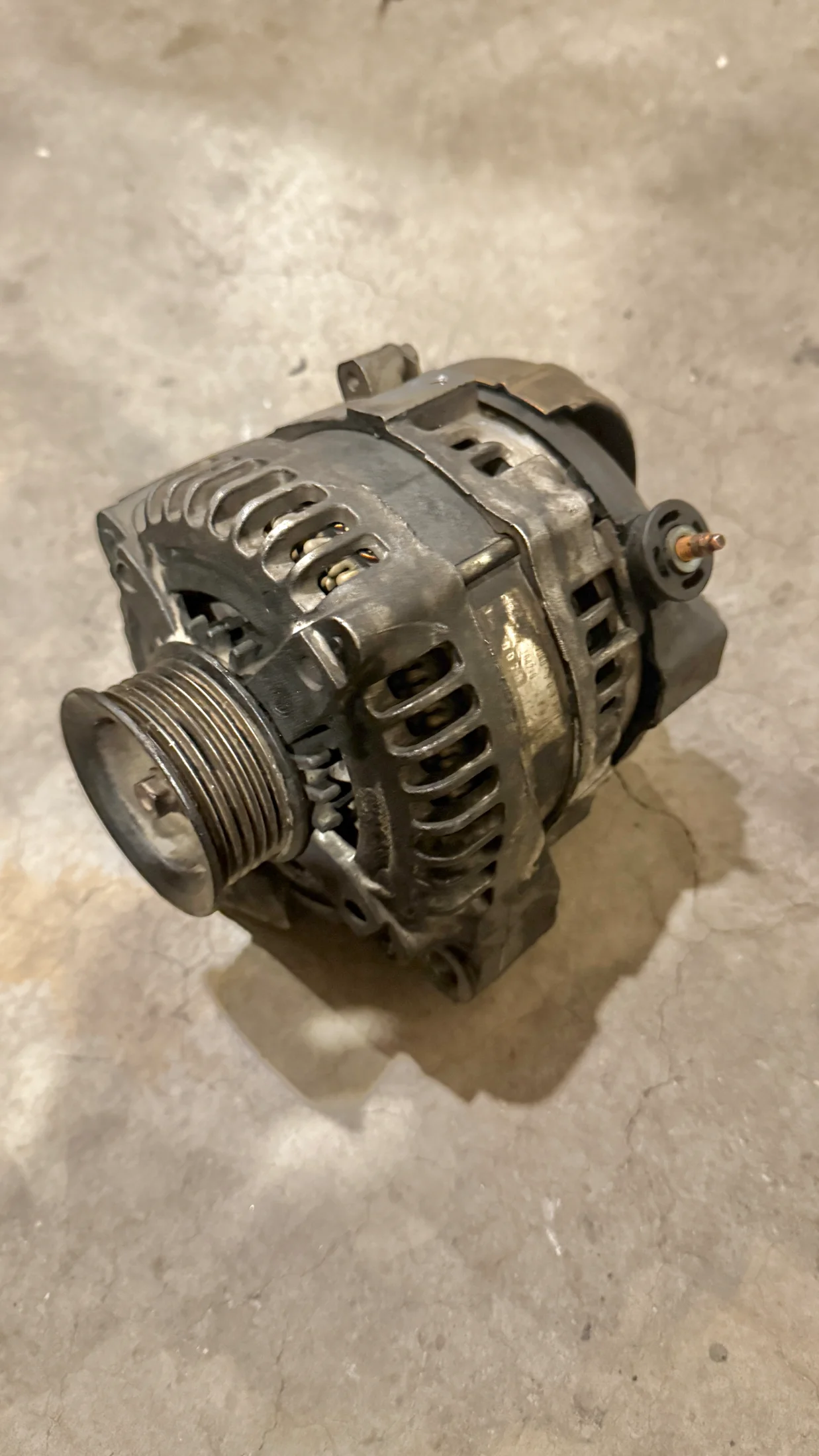

changed the brushes on mine since it’s easy and cheap after removal. It’s either original or over 10 years old and works. For those with oil and gunk in them, is there a good way to clean them?
This is the way. Brushes are a consumable part. That being the case they are easy to get to and inexpensive to replace. IMO the smart move is to replace the brushes at ≈180k miles during the second timing belt change.
I’ve used this stuff for cleaning
After cleaning, rear cover and old brushes removed
New brushes installed. Pull the release pin and reinstall the cover.
