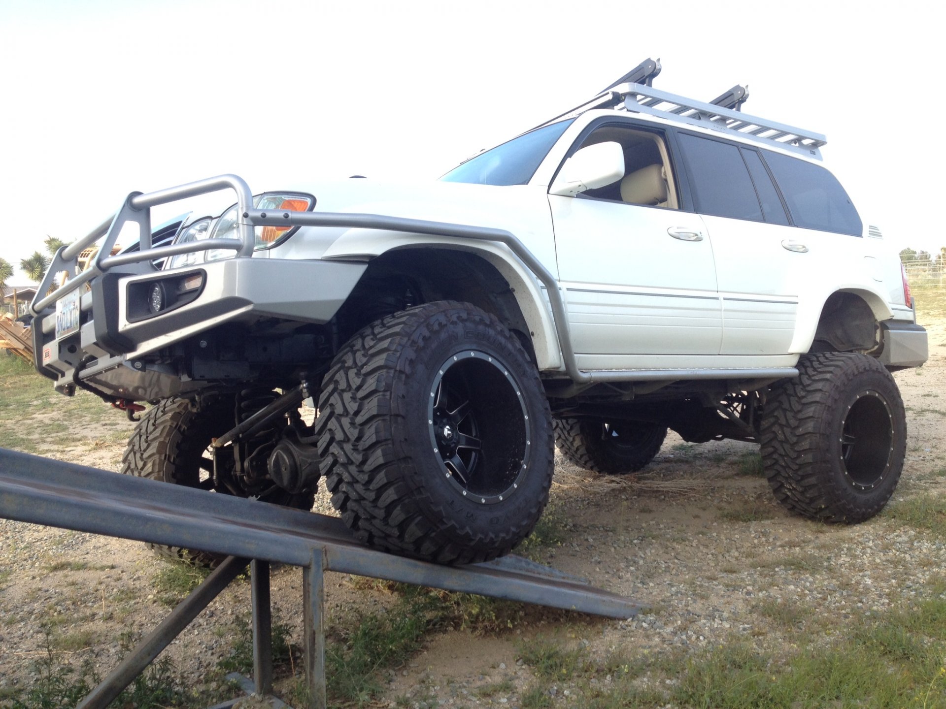

Totally. I wonder what @TRAIL TAILOR is getting for travel on his kit. That pic above on the flex ramp makes that truck look very tippy. Seems like you gotta cut some sheet metal to get proper up-travel out of these puppies. @nukegoat what kind of travel did your LX end up with?

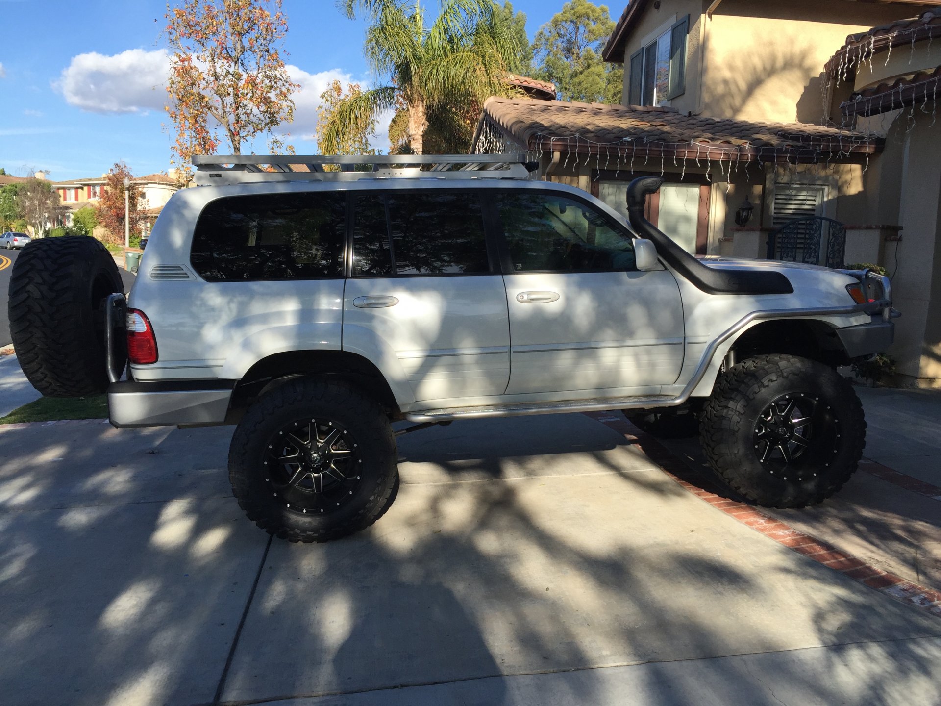

This is a simple 3" lift with internal valved shocks (less stroke 10.75") and 34s with sway bars attached.
About 5.5". But the tire stuffs more when flexed. If you're doing a SAS or anything significant with suspension and tires, doing yourself the favor of adding sheet metal mods to your list will give you a lot more flexibility.

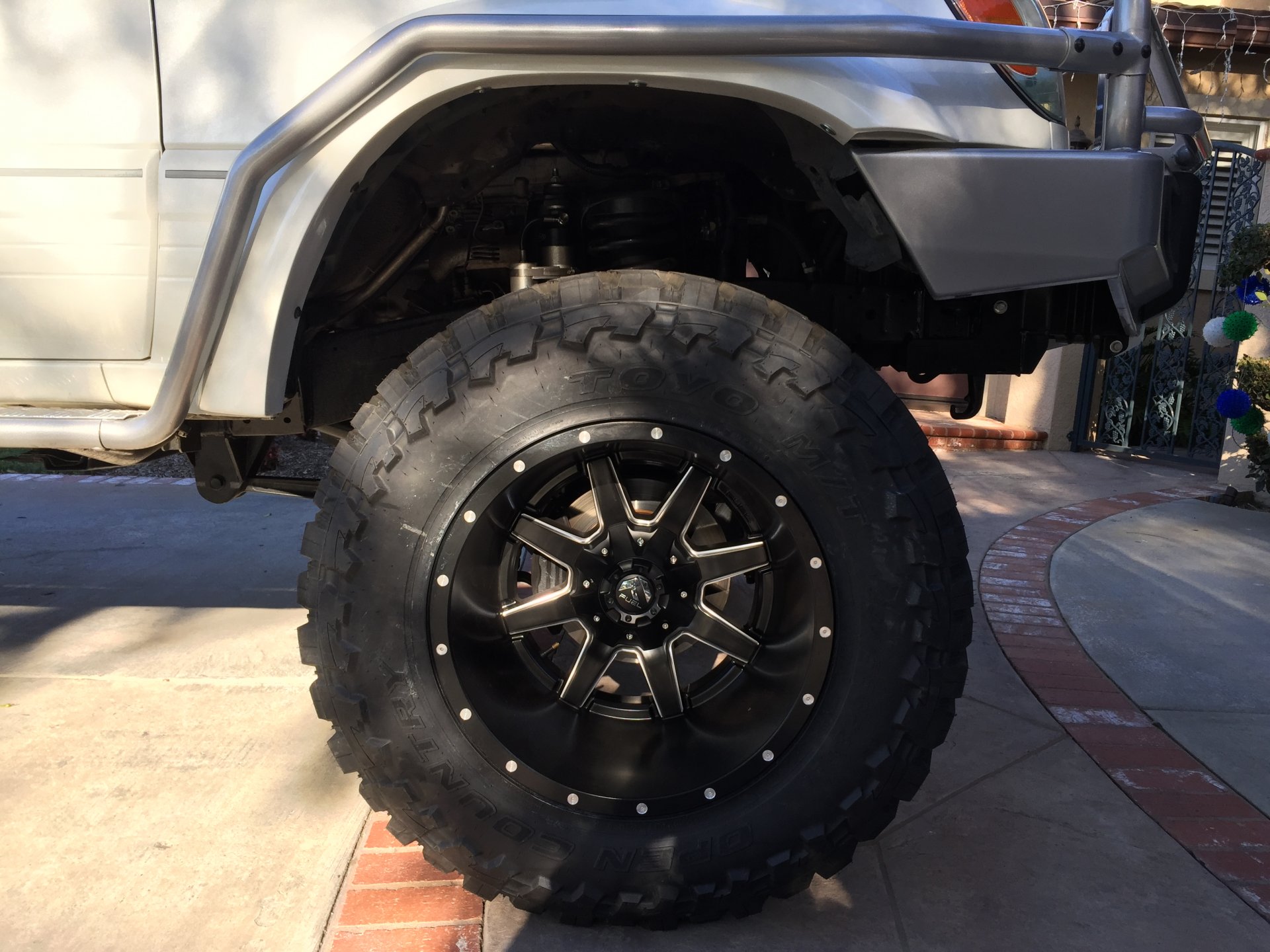

I ended up pushing my axle forward 2 inches, 114" now. After the pinch weld hammering from fitting 35s on stock ifs, I have no issue with tire rubbing on 37s(-44 offset). Haven't measured my actual travel yet, but the factory rear is limiting me at the moment, triag 4 link is in the future. RTI score might be somewhere in the 900s after some calculations.

Dang nice work! Looks to be pretty good up travel on this photo.
