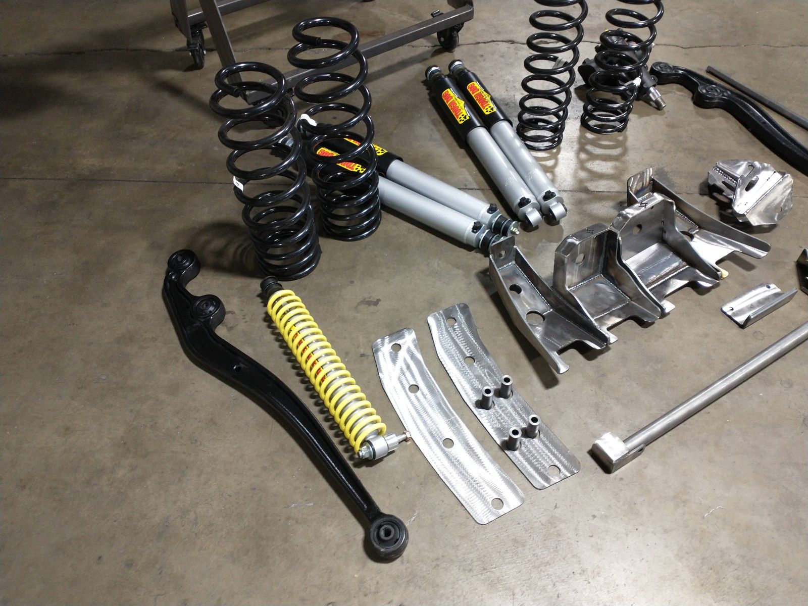

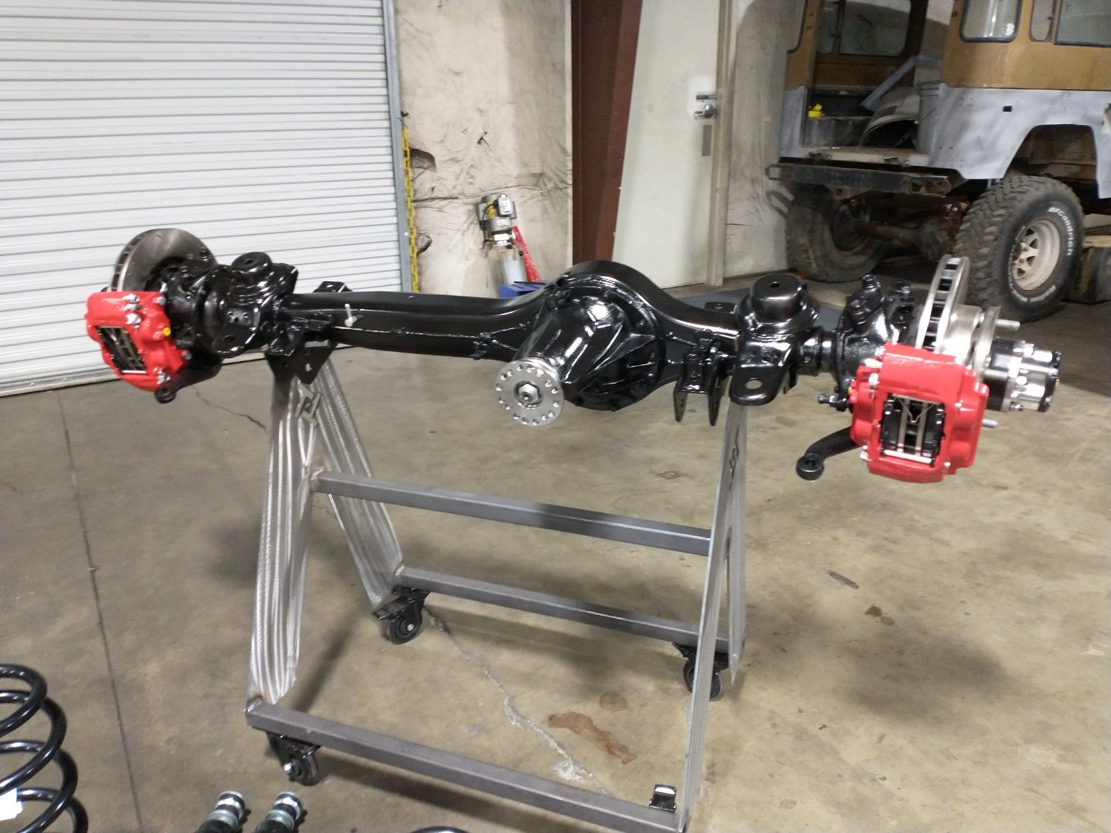

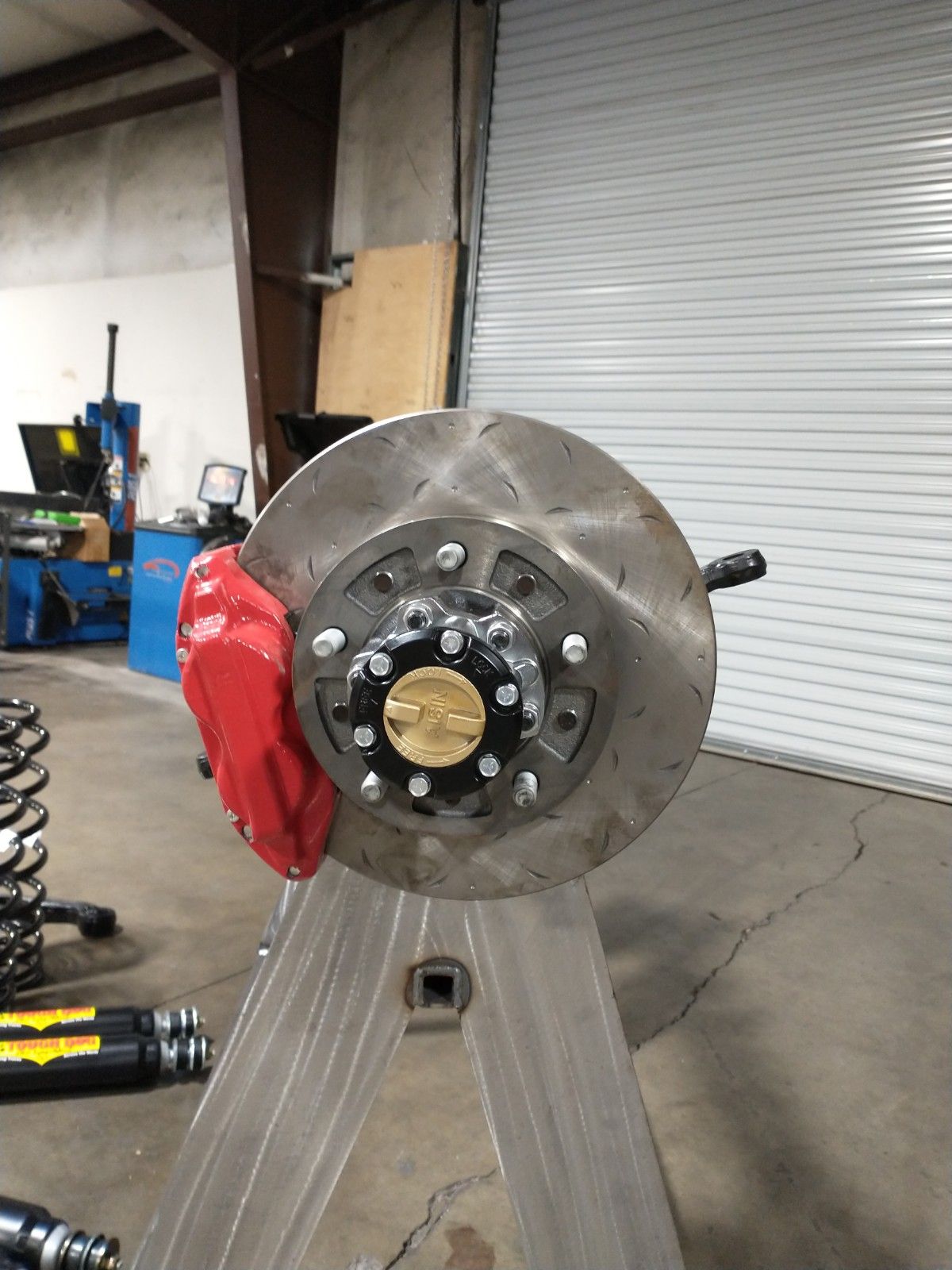

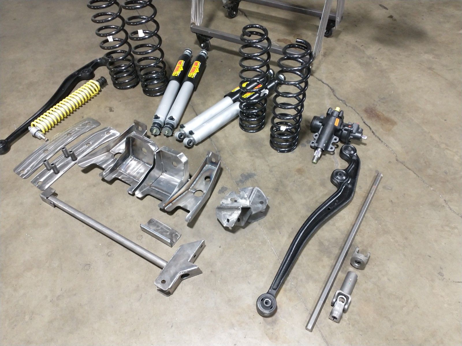

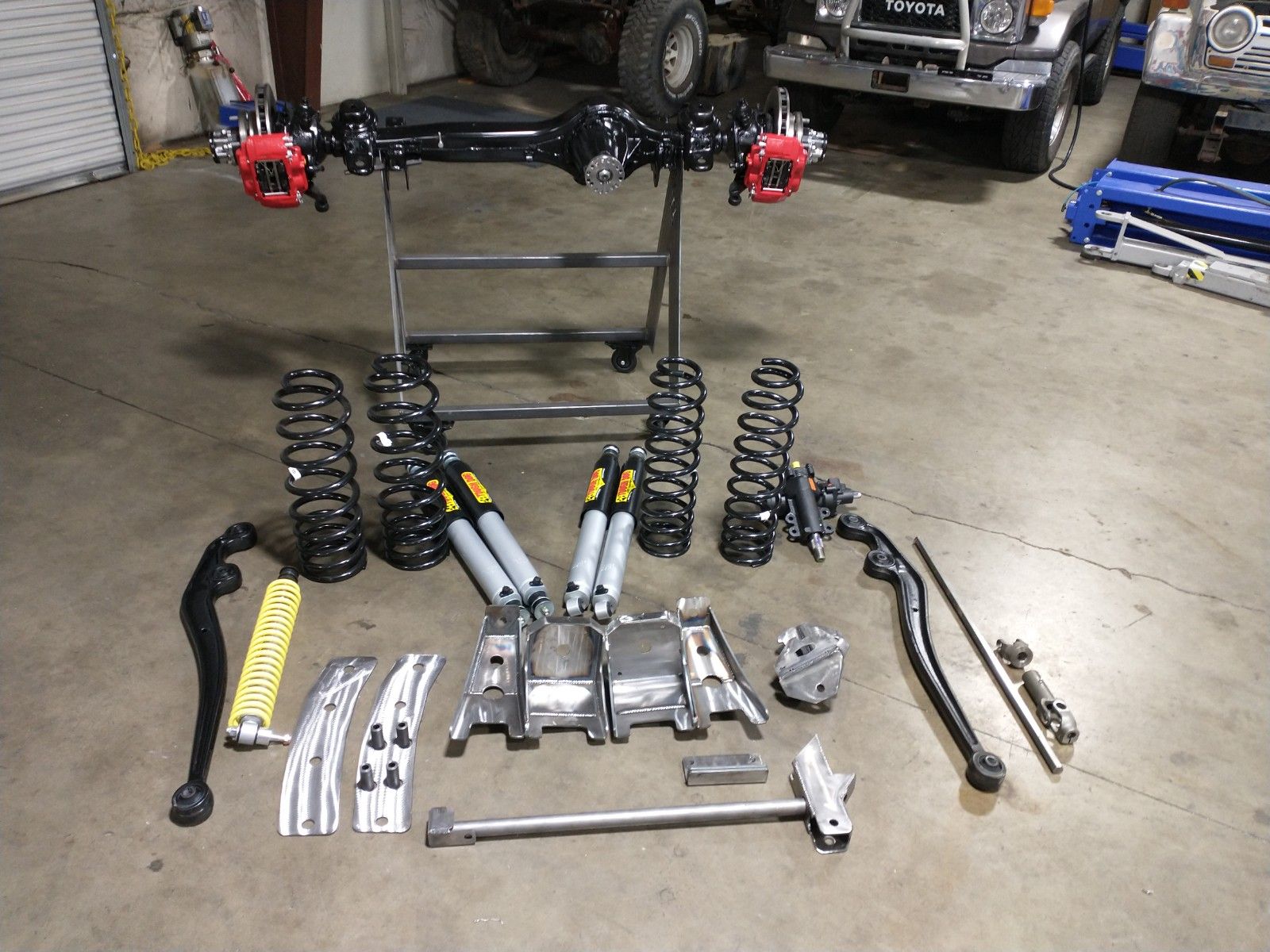

AND................... The 100 series SAS kit is born..
This set up is going in my ELE rig for a final test fit. 4" Trail Tailor TourFlex tapered wire coils, 9 stage adjustable EXTENDED 45mm bore Tough Dog foamcells, XHD steering stabilizer, 105 5 lug Toyota hubs (NO WHEEL ADAPTERS HERE), Aisin freewheel hubs, Nitro/RCV axles, 105 rotors, 100 ceramic coat calipers and Akebono ceramic pads, 80 radius arms and bushes, 4:88s, ARB air locker, 80 box, custom steering shaft and joints and the new Trail Tailor bracket kit with frame strengthening plates and steering box sleeves.
(Tough Dog adjustable panhards not pictured)
