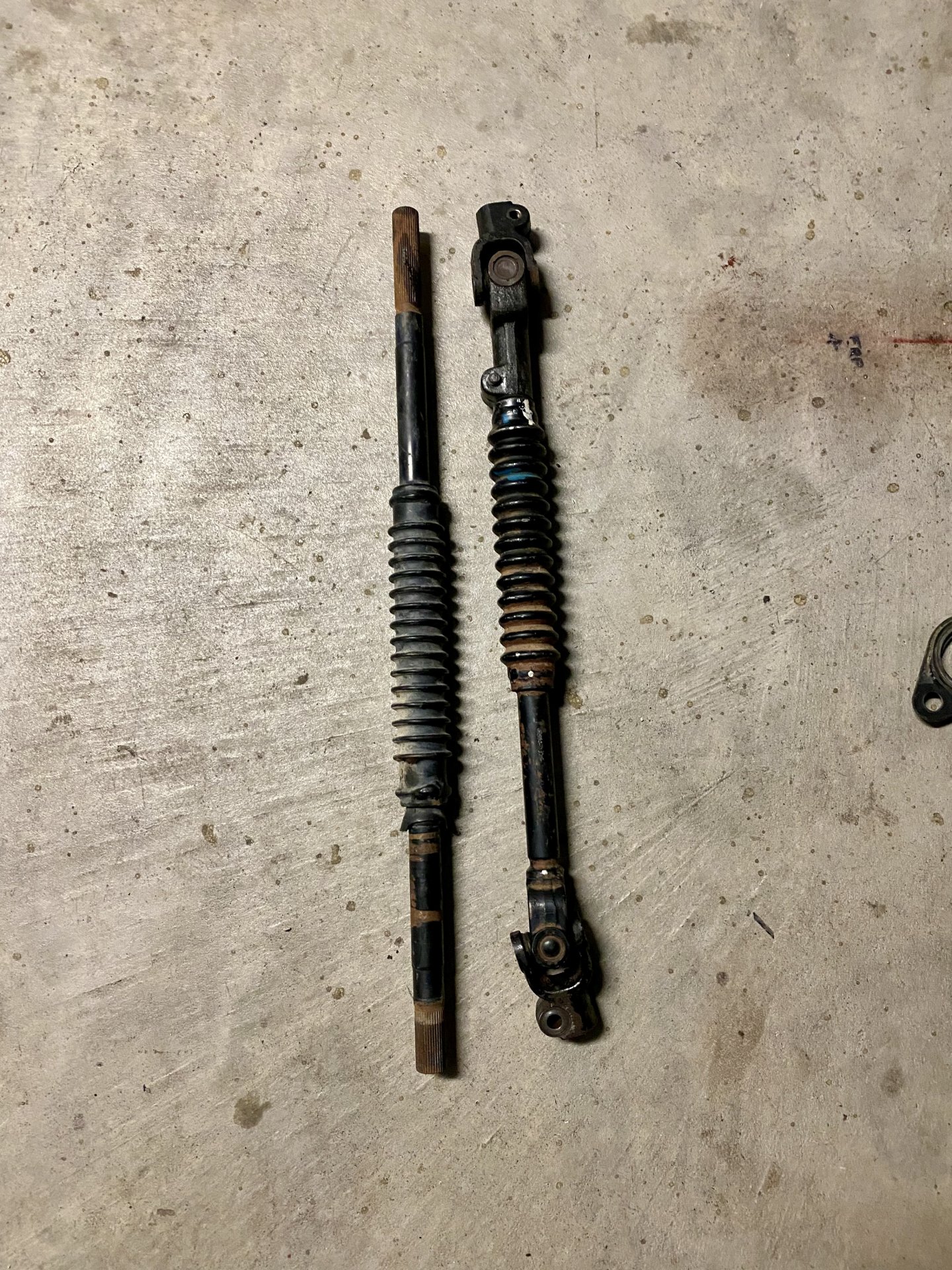

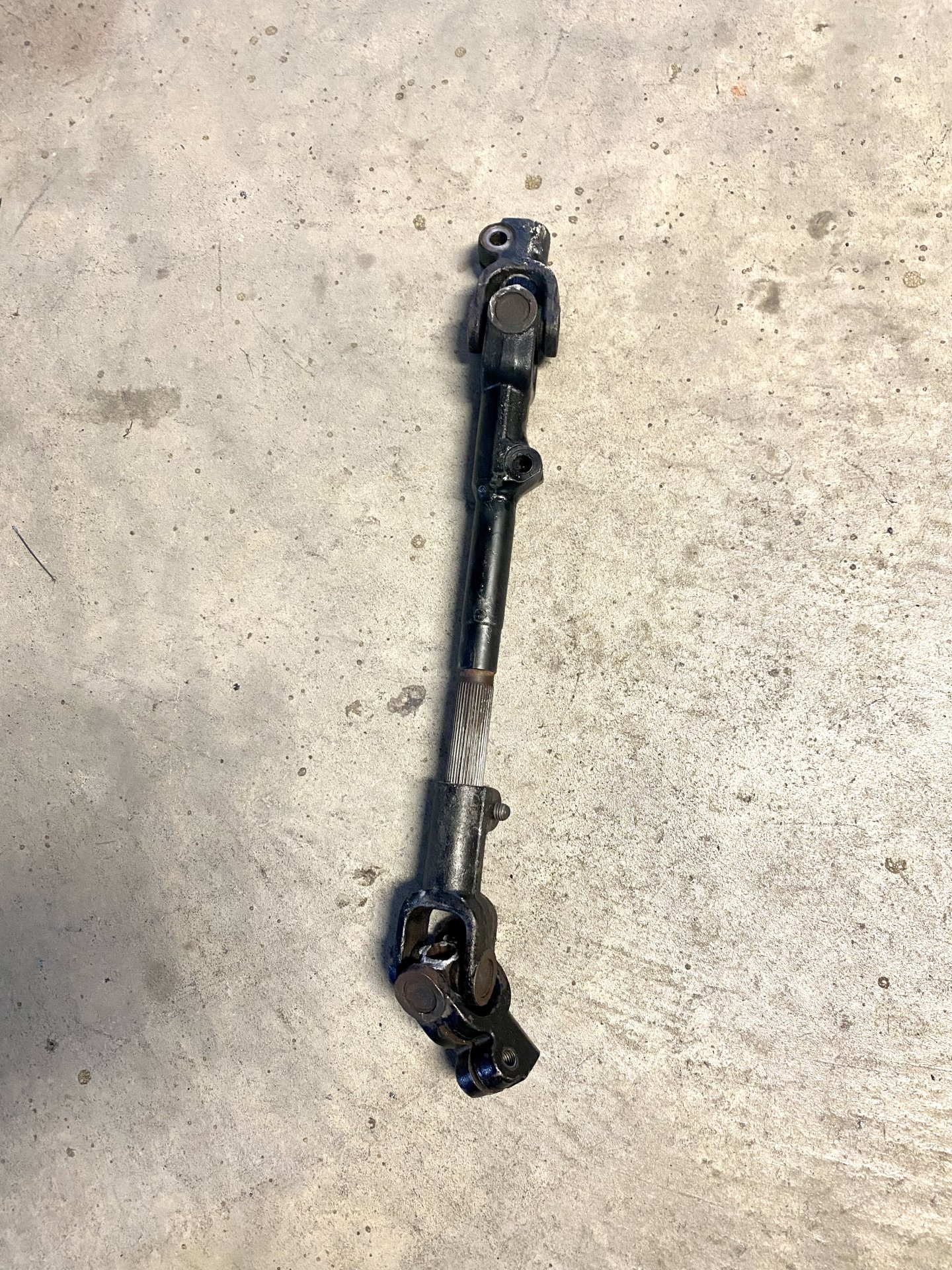

I basically grafted a shaft from the 80 (steering box side) and the 100 shaft (firewall side). IIRC it involved cutting the 80 shaft down slightly to fit, and driving the 100 shaft out of the bottom of the u-joint assembly. Pound the 80 shaft in its place, weld the hell out of it, and it's good to go. There is just enough room for it to fit, but if you have headers it'll ocasionally clink on one of the tubes. An annoying fix I haven't taken care of yet (my steering ujoints may be a little sloppy).
Start:
End:

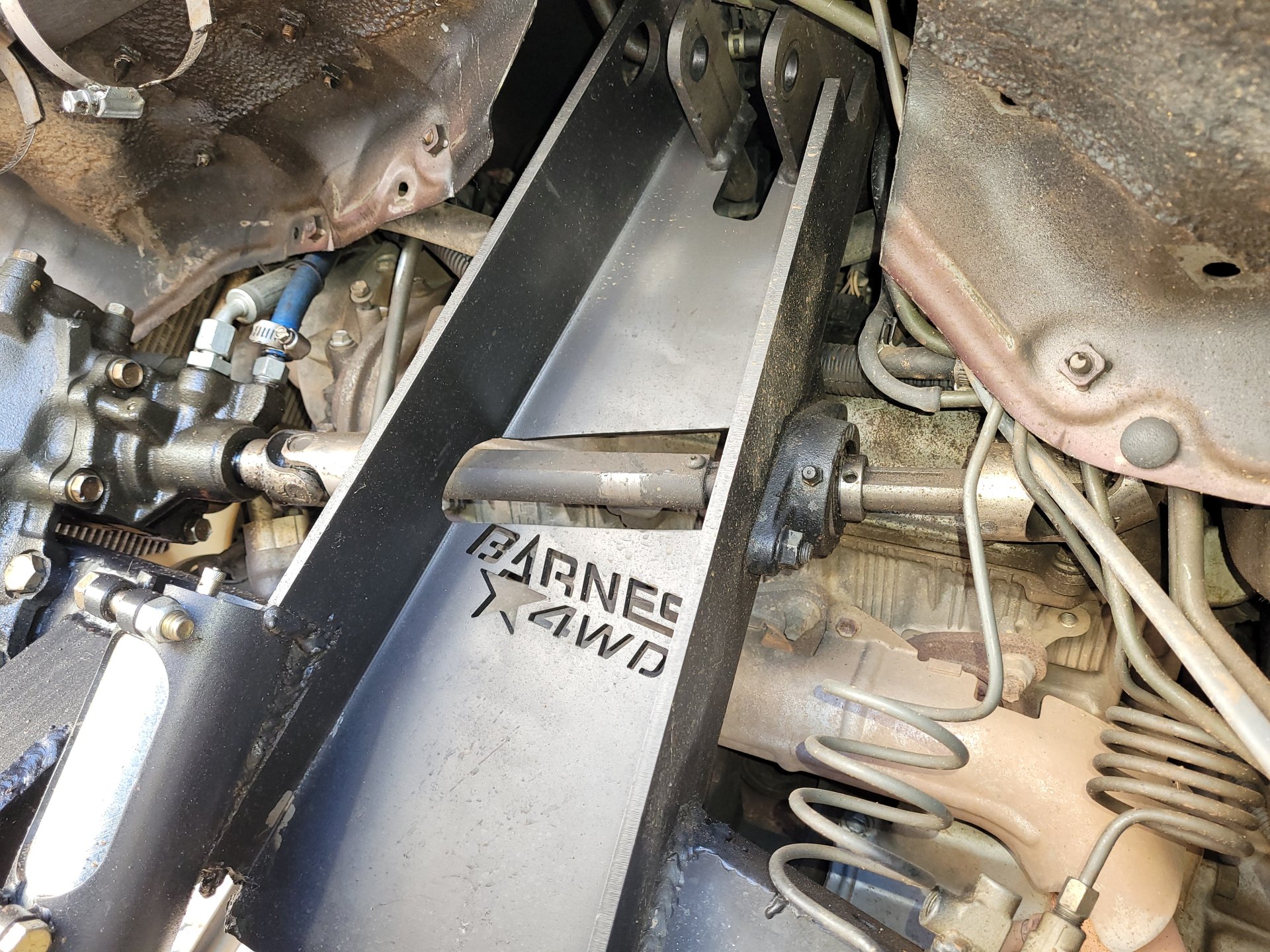

Best picture I have (and it's sort of terrible for showing off what I'm talking about, but look for the power steering filter):
Also: the power steering filter was a dumb idea. Nothing I ever did to it would stop a slow leak. It's since been removed.

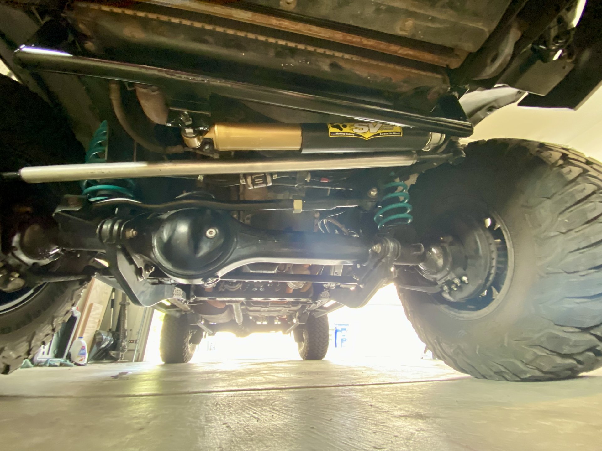

Here are the parts I used to build my steering shaft, all Borgenson stuff. I had a bunch of parts for a tacoma SAS laying around, which included Trailgear's tacoma steering shaft kit and power steering lines. The shaft kit had sloppy u-joints out of the box, so I found a thread with borgenson part numbers. I also added a 1" ID spherical bearing on my shock tower because the shaft coming from the column is loose so it needs to be hard mounted (pic).As for the power steering lines, the kit runs the lines from the 2uz pump to the box just fine, only thing is you cant run your idle/pressure vacuum control switch. I cut the factory banjo line a few inches coming off the pump and I'm welding an AN fitting to it, to put that vacuum switch back.View attachment 2920508
