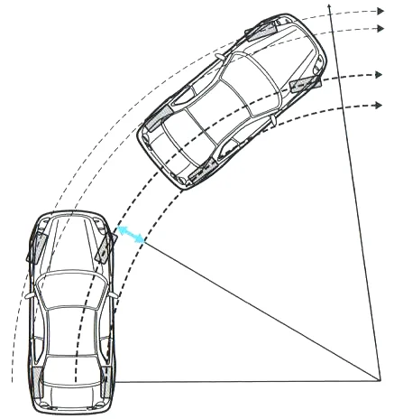

AWD vehicles have a differential (or something playing this role) in the center.
A part-time 4WD vehicle like the FJ40 has no diff in the center, so when 4wd is engaged it means both the front and the rear will spin at the same speed.
When cornering, yes both front and rear differential will adapt the speed between right and left wheels, but when cornering your front and rear axle are also traveling a different distance. The rear wheels don't follow the exact path of the front ones, they tend to slightly cut the corner. So in 4WD mode it will force on the transfer box and the vehicle will tend to not want to turn (on pavement), steering wheel will feel harder to turn (particularly if no PS).
