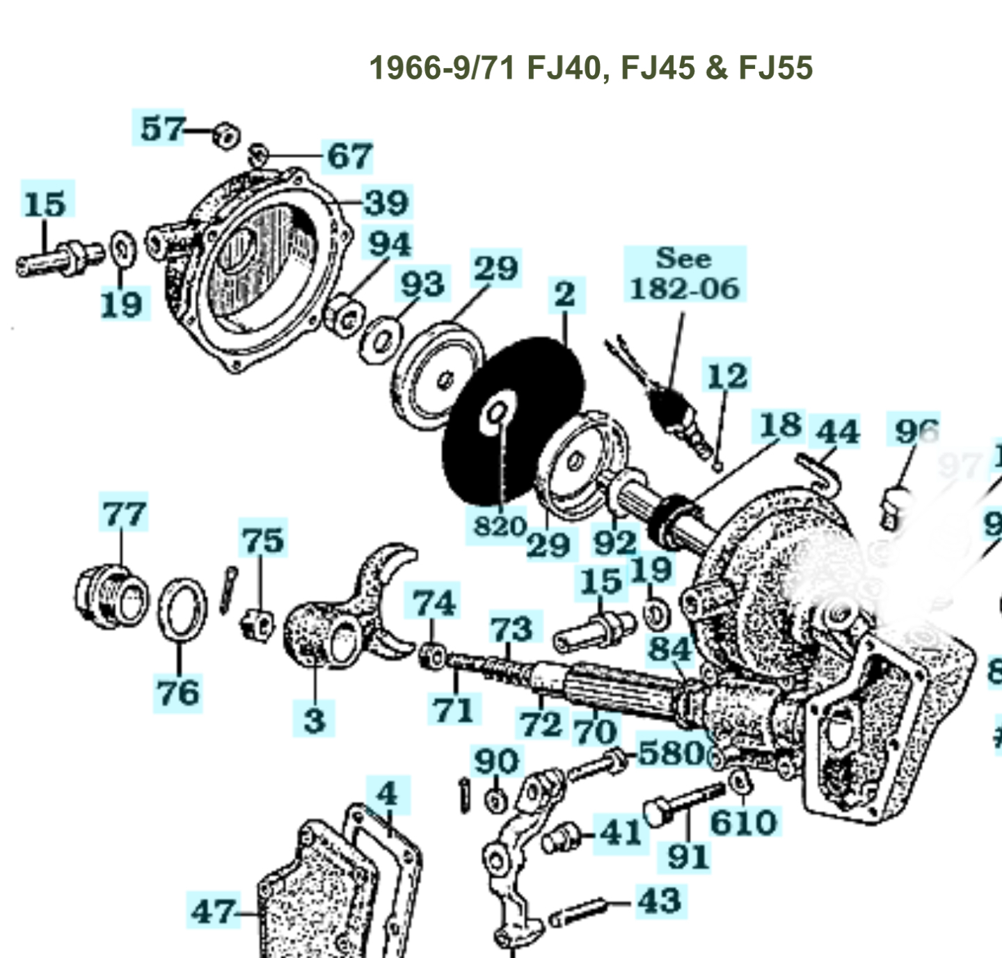

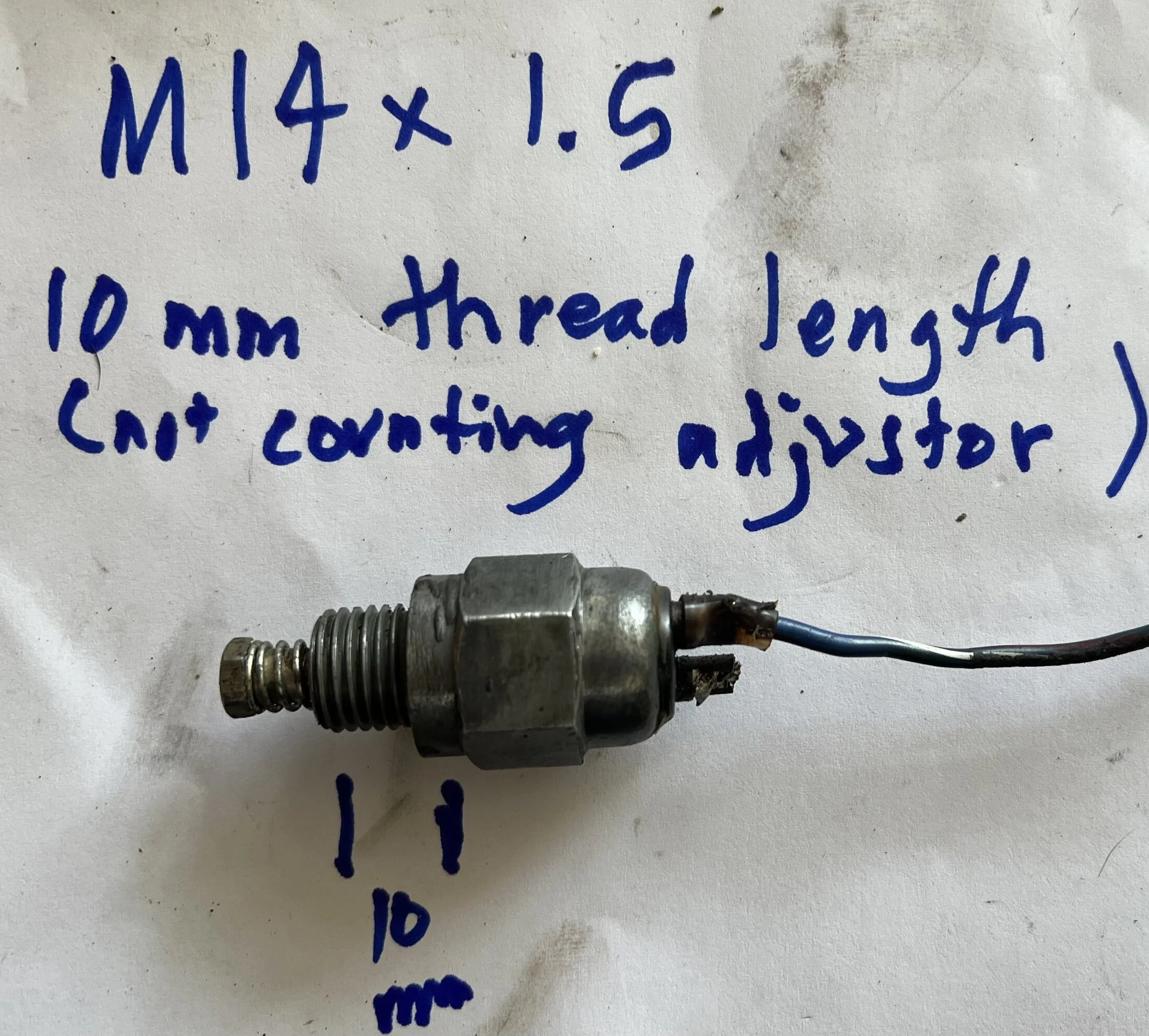

Can anyone source a replacement 4WD indicator switch for vacuum shift unit on a 1968 FJ40 transfer case? The one that sends a light to the dash when the vacuum shifter engages 4WD? Part 182-06 below, and is NLA for my year truck. Wires on my existing are badly frayed.

If you can’t find one replacement wires can easily be soldered in place of the frayed ones if that’s the only issue. Functional connectors are available also. GL.

This! I heated the terminals on my switch with a soldering iron and was able to pull the old OEM wires off with ease. Then cleaned the terminals and soldered on new wires. Good as new!
No clue. I'd try and fix what you have first. $110+ for a used part is like purest price. GL

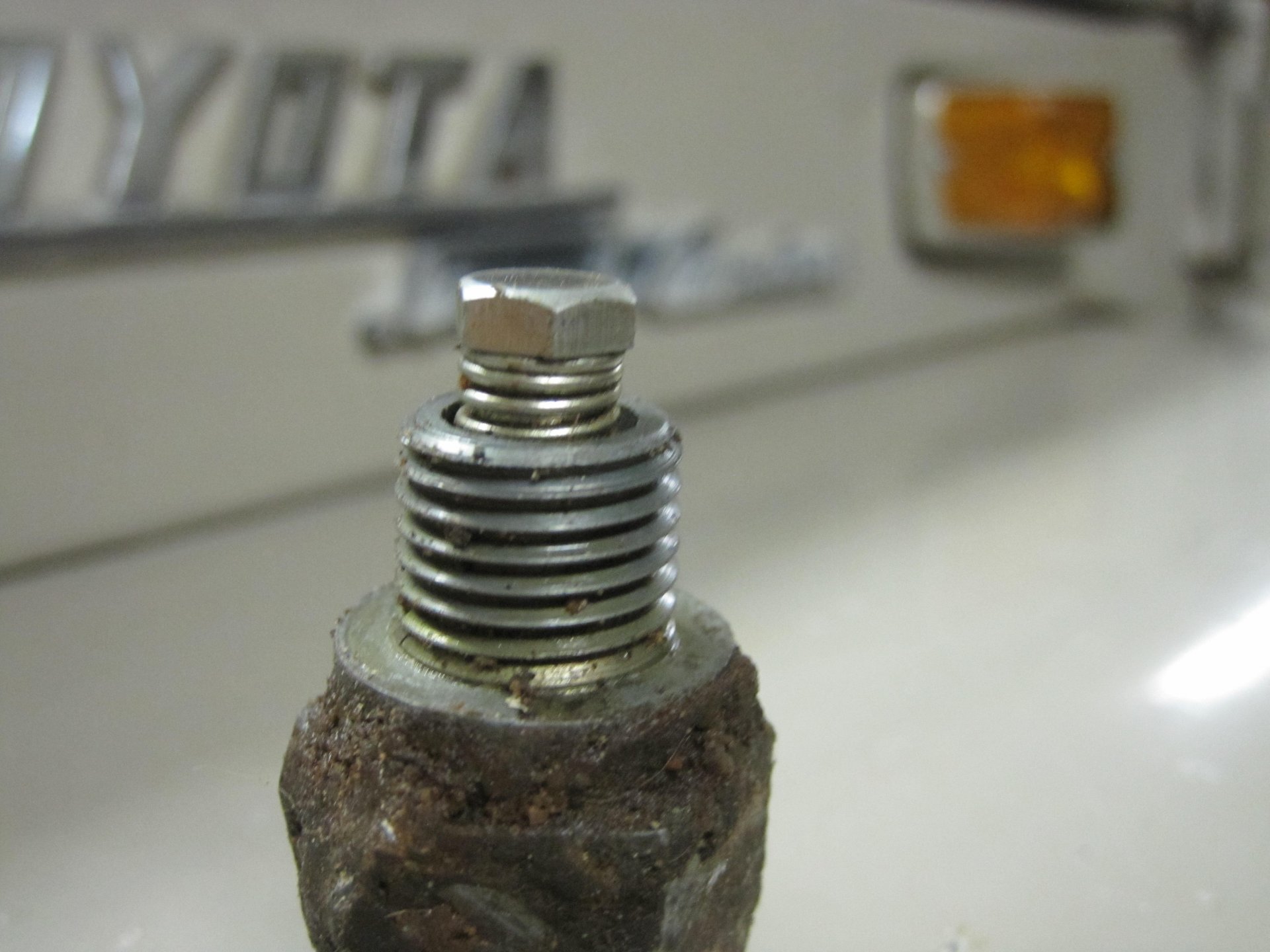

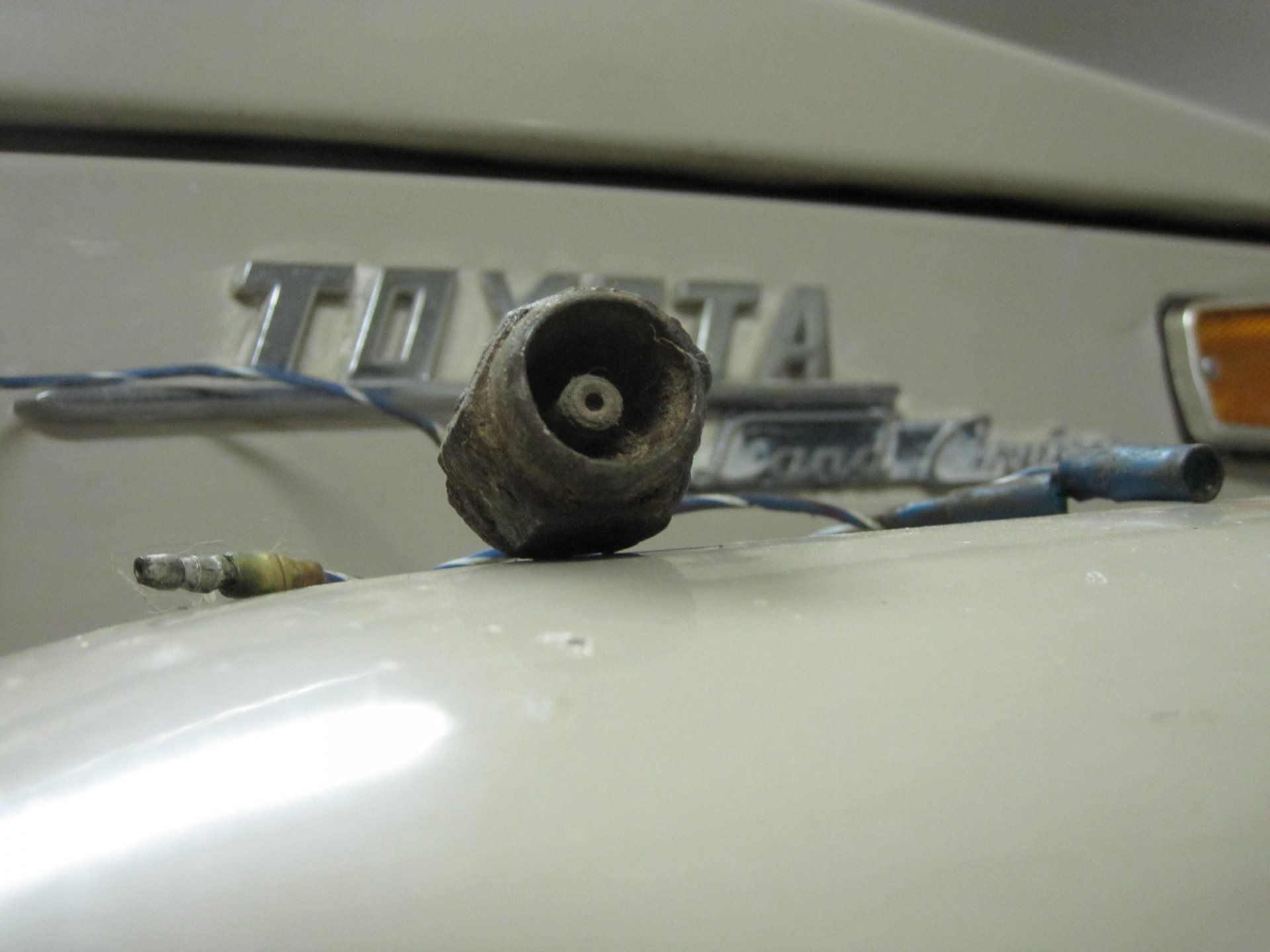

I remember time when I could buy a whole used transfer case for $25. The one on my 70 FJ40 the whole terminal had rotted away. Plunger end was perfect.
The other end was gone.

There was no soldering in new wires. It wires were the problem that is how I repaired it versus the whole switch.
Its not like there is a lot of oil pressure in that switch. I have fixed many a plunger type switches that looked worse than that one. A person could just remove the guts in the housing and epoxy in a new switch with the correct throw. Rebuilding double throw double pole, multipole rotary when parts are missing is a lot more fiddly
Before you go the solder-new-wire route if you have a continuity meter you can check if the switch is functional before investing any time to repair it. Your switch looks to be in good shape except for wires so should be good to go but the continuity check is simple assurance . Don’t forget to make sure the ball bearing is in place (part 12 in your parts figure) when reinstalling.

Thanks for the good idea. Did a continuity check toggling the switch. The switch is good.

Yassuh. I validated continuity across the terminals with and without the plunger depressed. Functionally good, just needs the wires re—soldered at the terminal and protected with some strain relief / shrink wrap. So I’ll do a solder repair and post pics for future folks with my question. THanks for helping me along the way.

BIG thanks for the ball bearing reminder. I would have missed it. Hopefully it is still in the cavity of the vac pod where I removed the switch. Otherwise, I’m gonna have to source one. That would have been a bear.

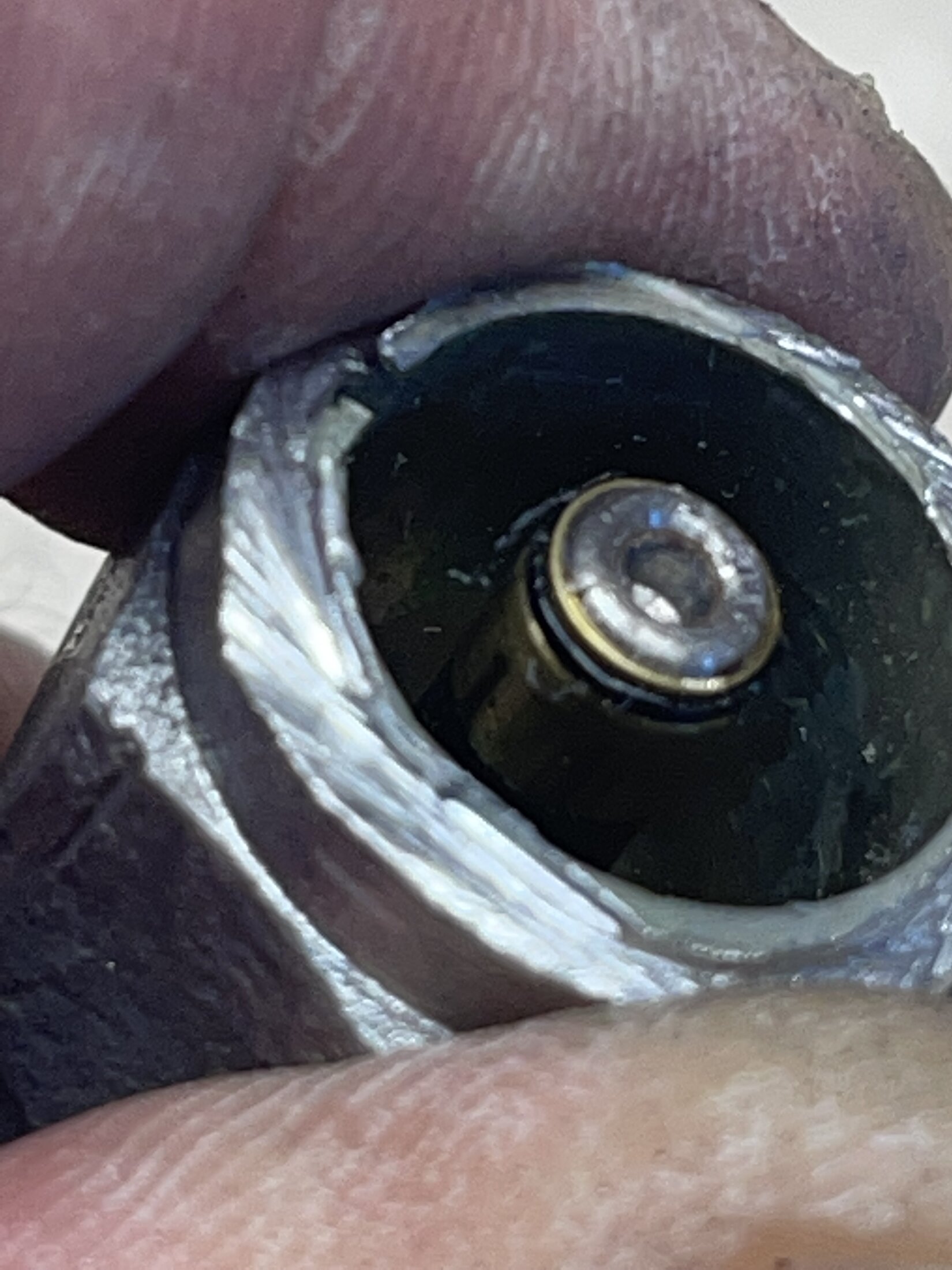

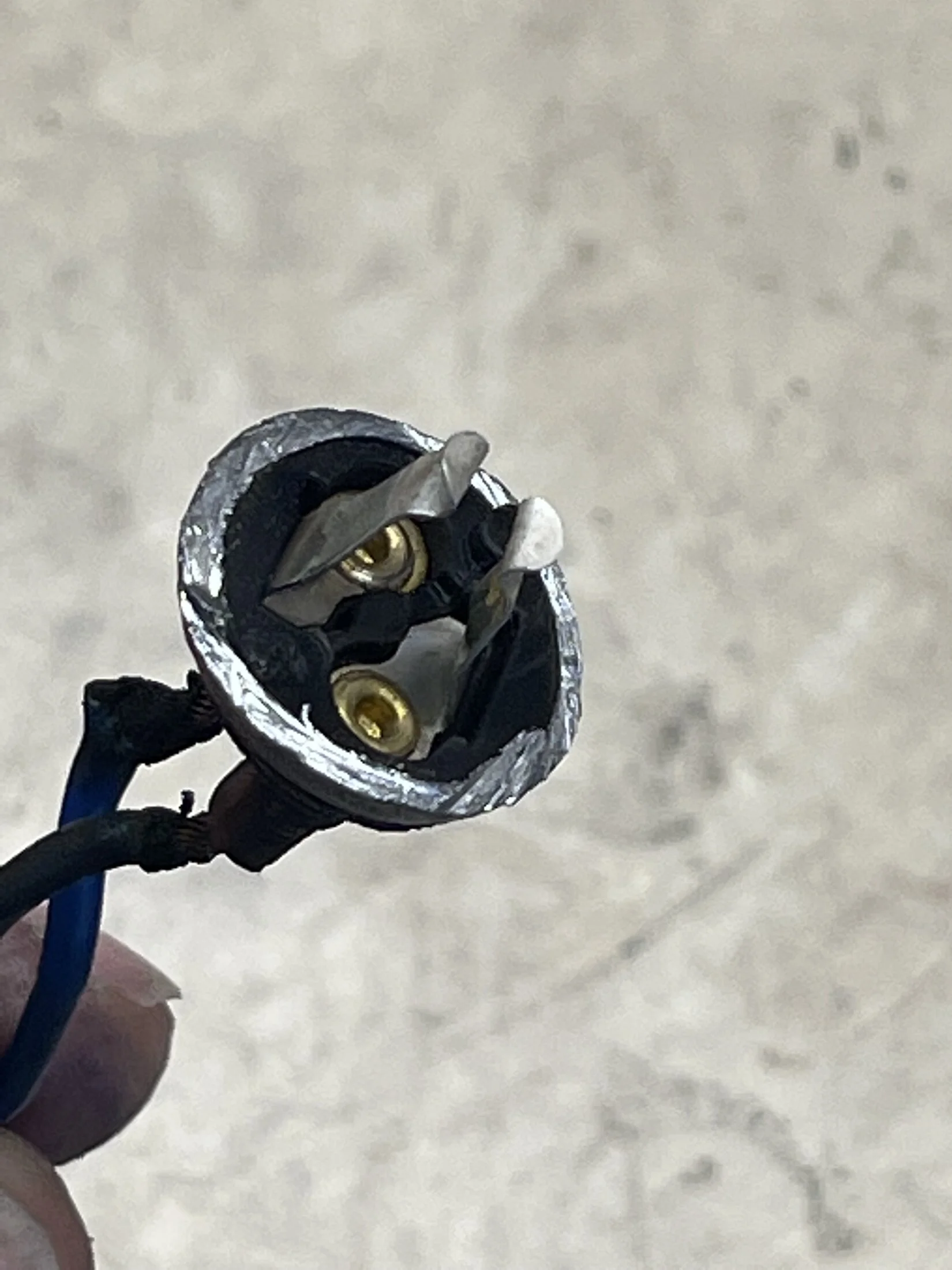

Here’s what the switch looks like inside the plunger just pushes up to make contact

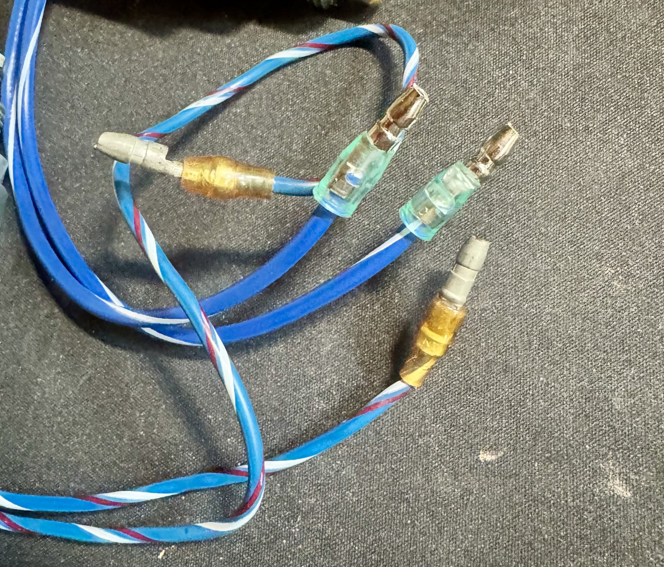

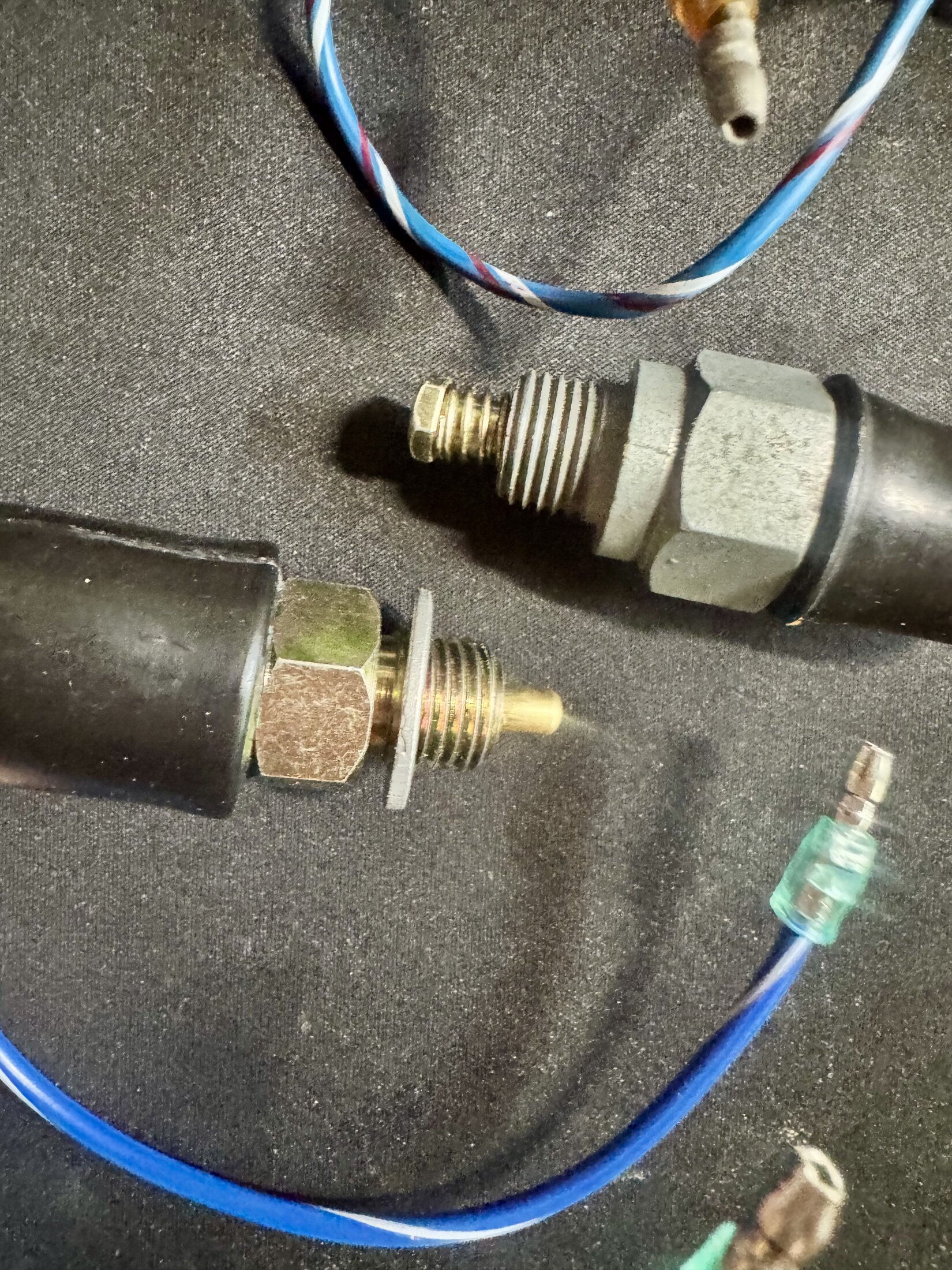

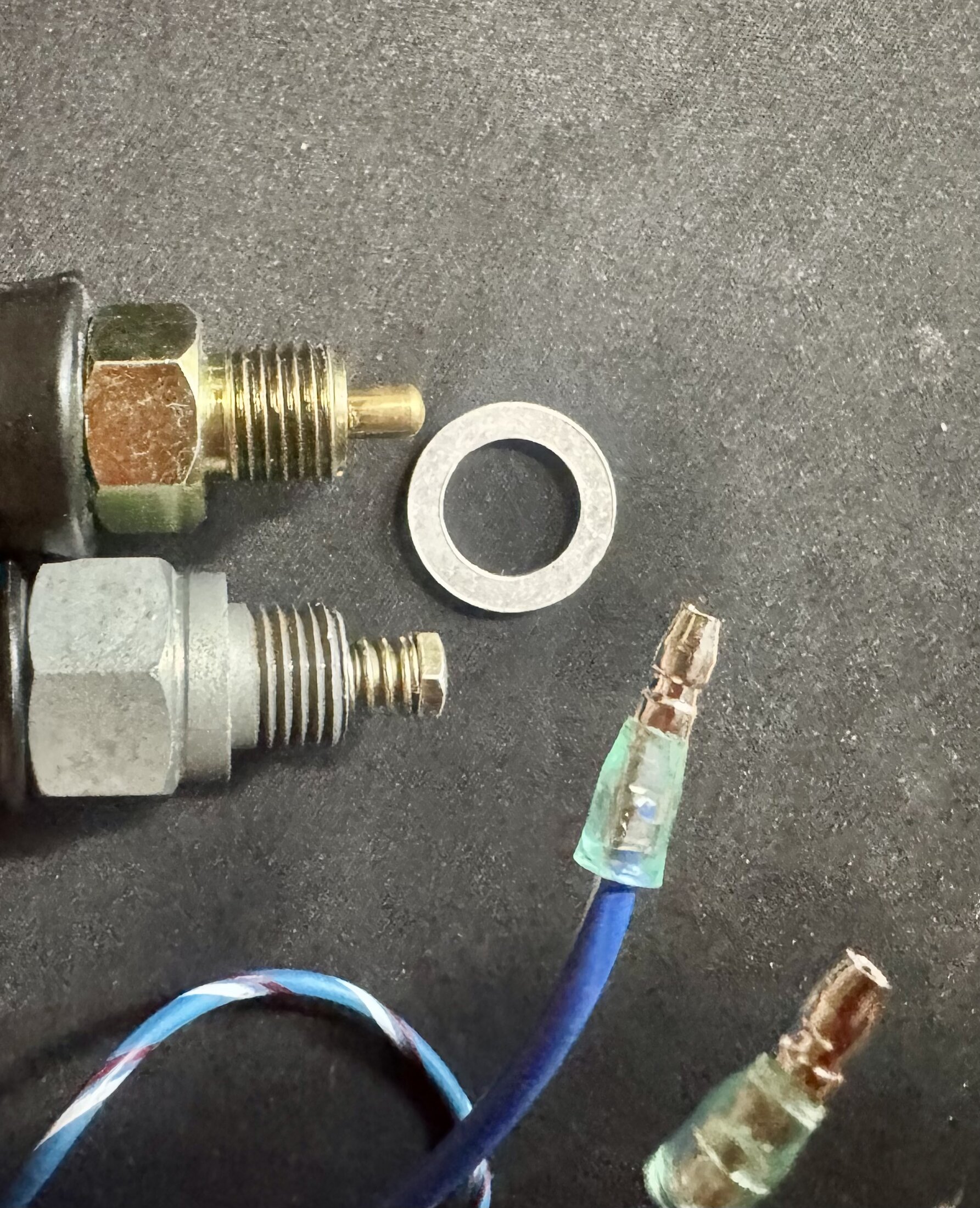

below is the modern age 2025 Japan spec. oem parts maker updated switch for your vacuum transferase 4wd green indicator dash light application ,
- they beefed up the wires , use the updated marine grade tinned bullet connectors , and incorporate as snappy very nice EPDM rubber weather boot too ,,,
- it uses the same part # aluminum crush ring and actually includes one with the switch ...... i guess somebody finally realized after 40+ years that might be a good new idea ....... ? 🤔 :wrench::wrench:
- the spring loaded pump plunger was a place dirt and crap got all stuck up with , its nice to see the sanitary solid pin and tight clearance between it and the main switch body so as to wipe off any little intruders that might want a new home ........:D
reviving this one and wondering if anyone has had any luck using the 73'-77' transfer case switch that is available by CityRacer but on a pre 73'. I have a 1968 and i bought the switch, made some modifications to match the length of the old inoperable one and cannot seem to get it to work. It works when tested and works when connected to the existing wiring when not connected to the transfer case. But as soon as a connected it to the T case it either stays on if screwed in too deep or not at all. After making a million micro adjustments to the depth i can now get it to flash on when i pull the vacuum handle but it immediately shuts off.
I have tried and tested all the wiring. I noticed the difference in the plunger style compared to my old switch and wondering if that is the issue. The amount of effort put into a stupid green light is driving me mad. If anyone has a source for the older ones (under $100) or has experience with this one, let me know. Thanks
