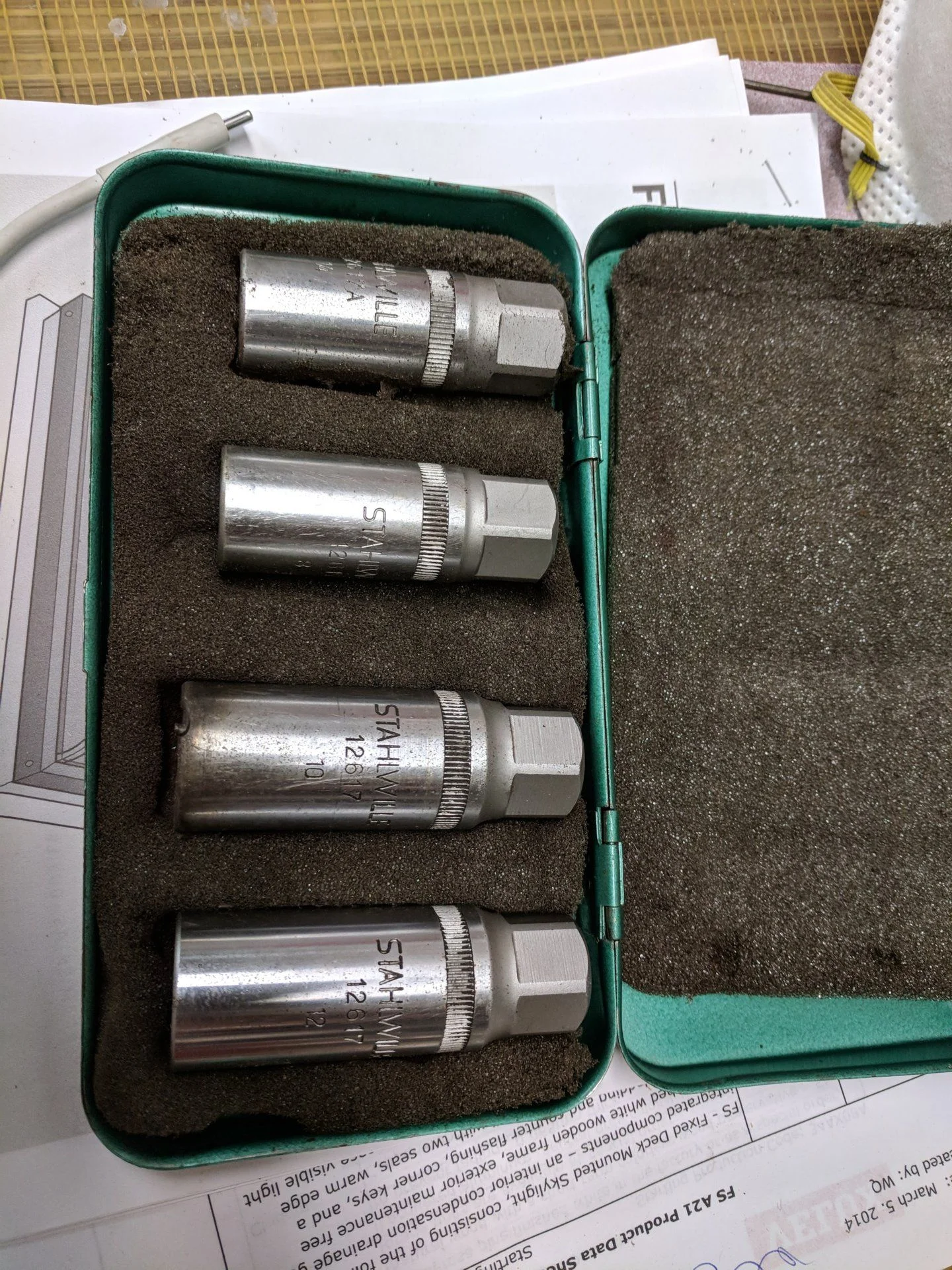

But I've twisted the Torx head off a few studs, so my preference now is my snazzy stud sockets, they work really well and never damage threads:
