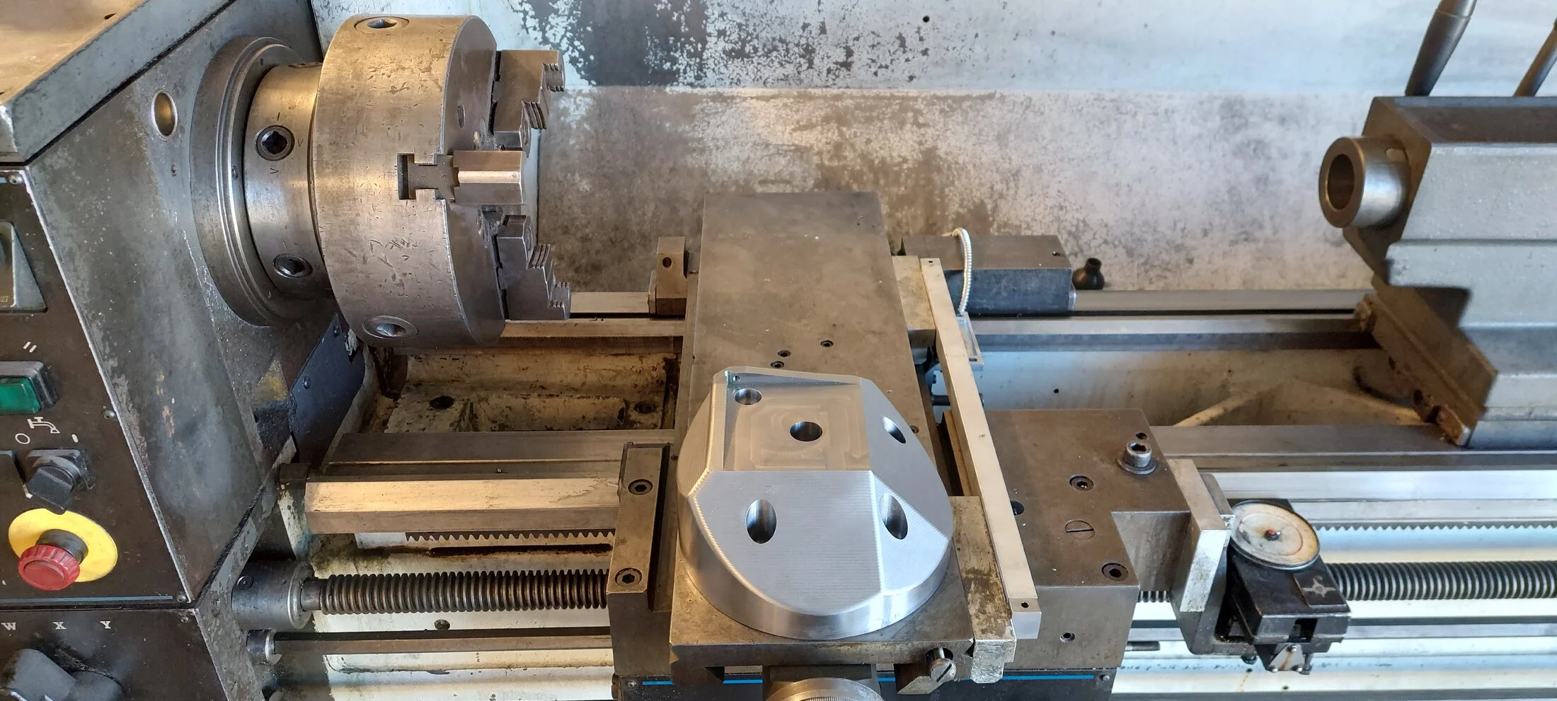

Slowly picking at the tool holder. Need to get some capture nuts and cap screws, and the tool holder can get trammed in so the lathe fully functional.

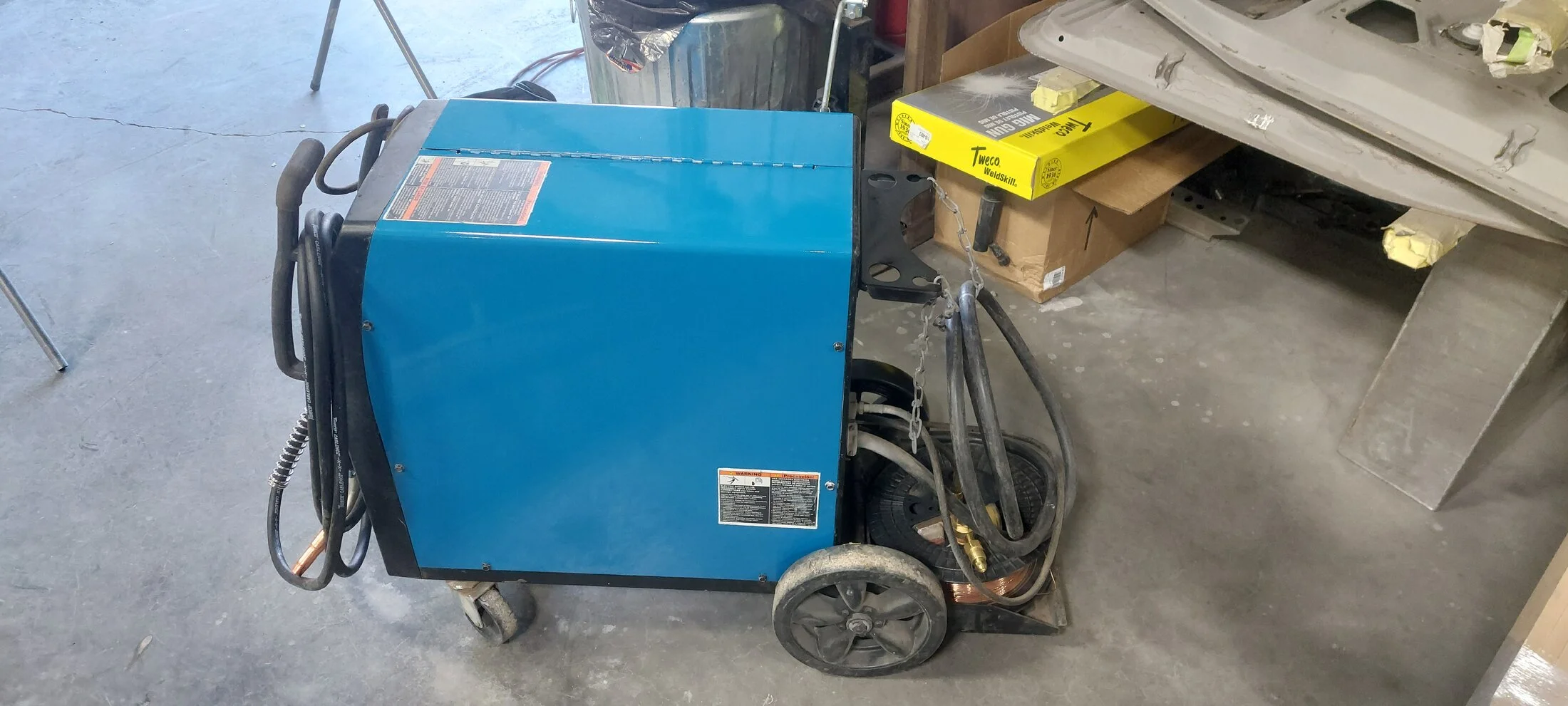

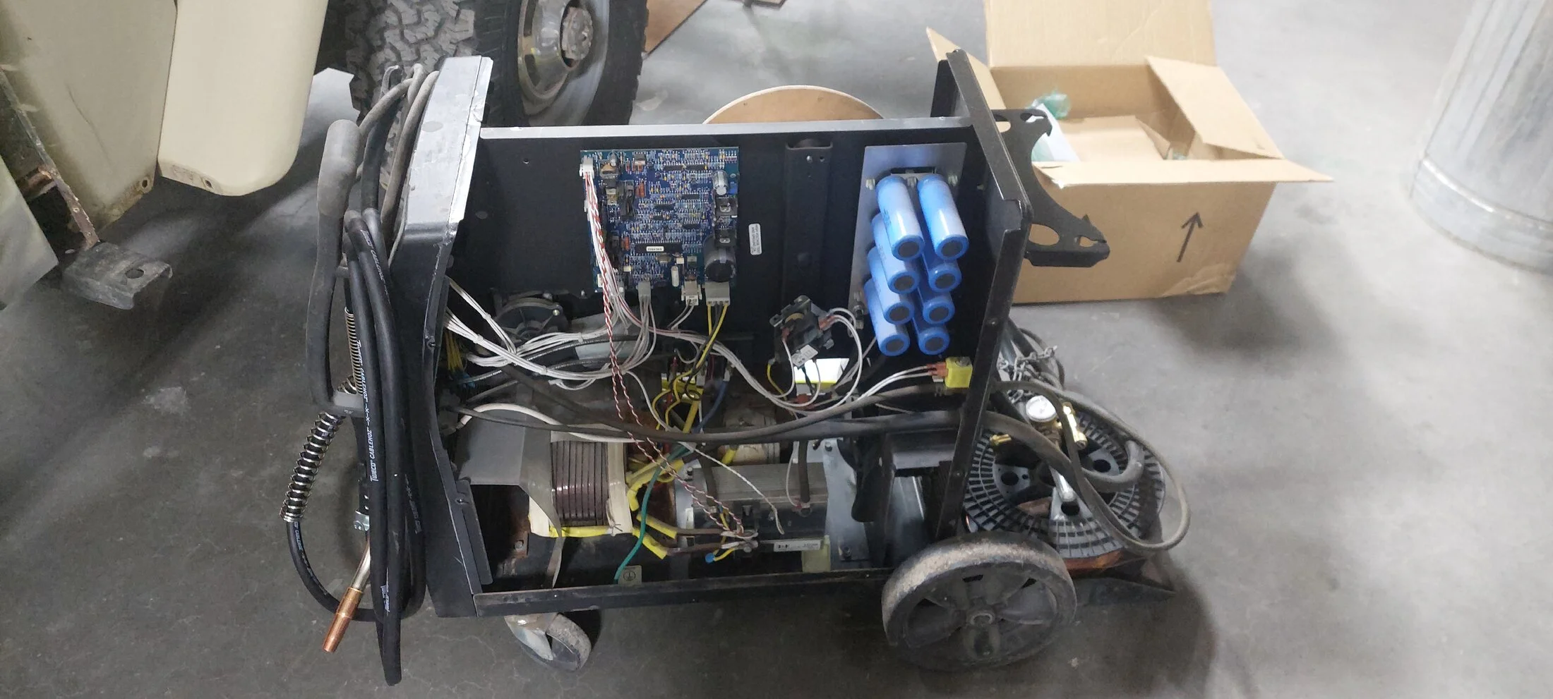

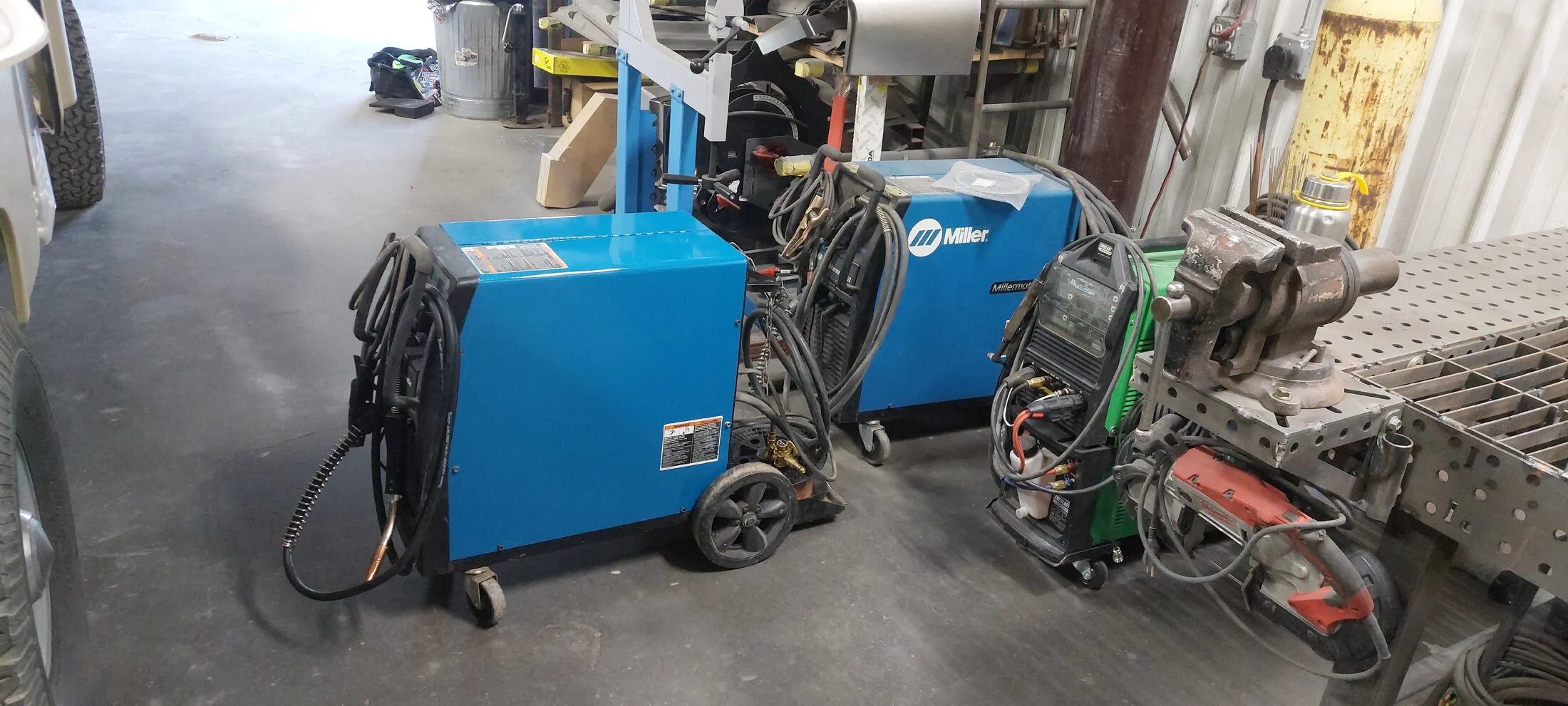

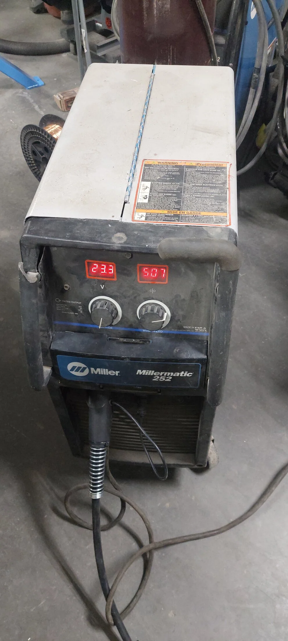

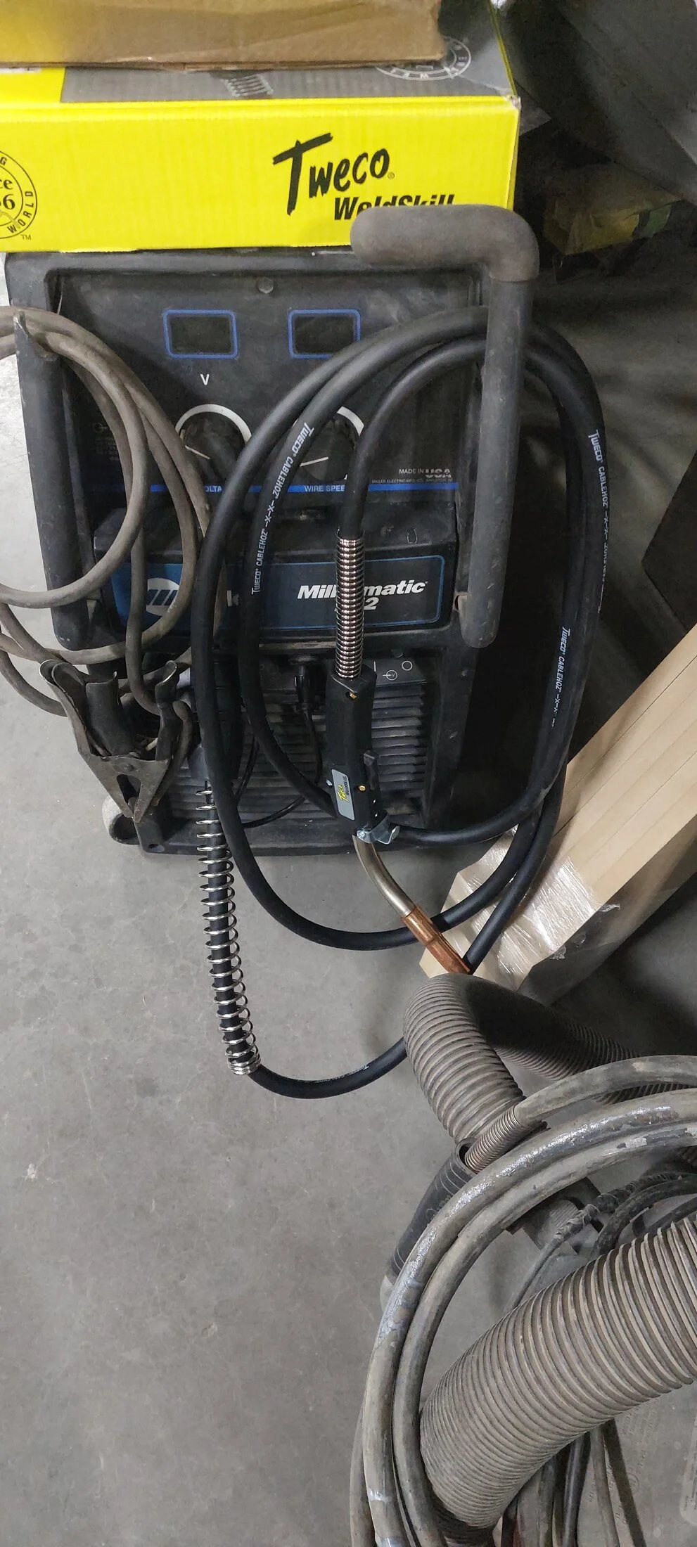

A $700 Miller 252 popped up an hour from me.
Dude couldn't run it at his house, and no way to test it.
So, naturally, I had to go look at it. I run a 252 daily for work and would love one for the new shop.
It seemed like it was in pretty good shape, so I took a risk.
Anyways, good deal. It runs super well, but looks kind of rough.
The new 252 had a dead fan, not an uncommon problem. They like to cook those, then the motherboards, so it was time to change it.

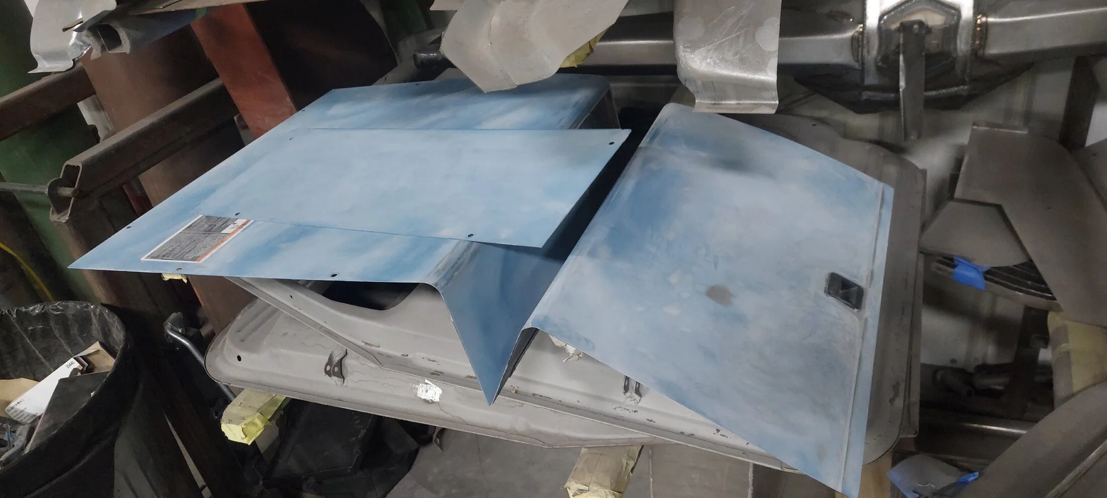

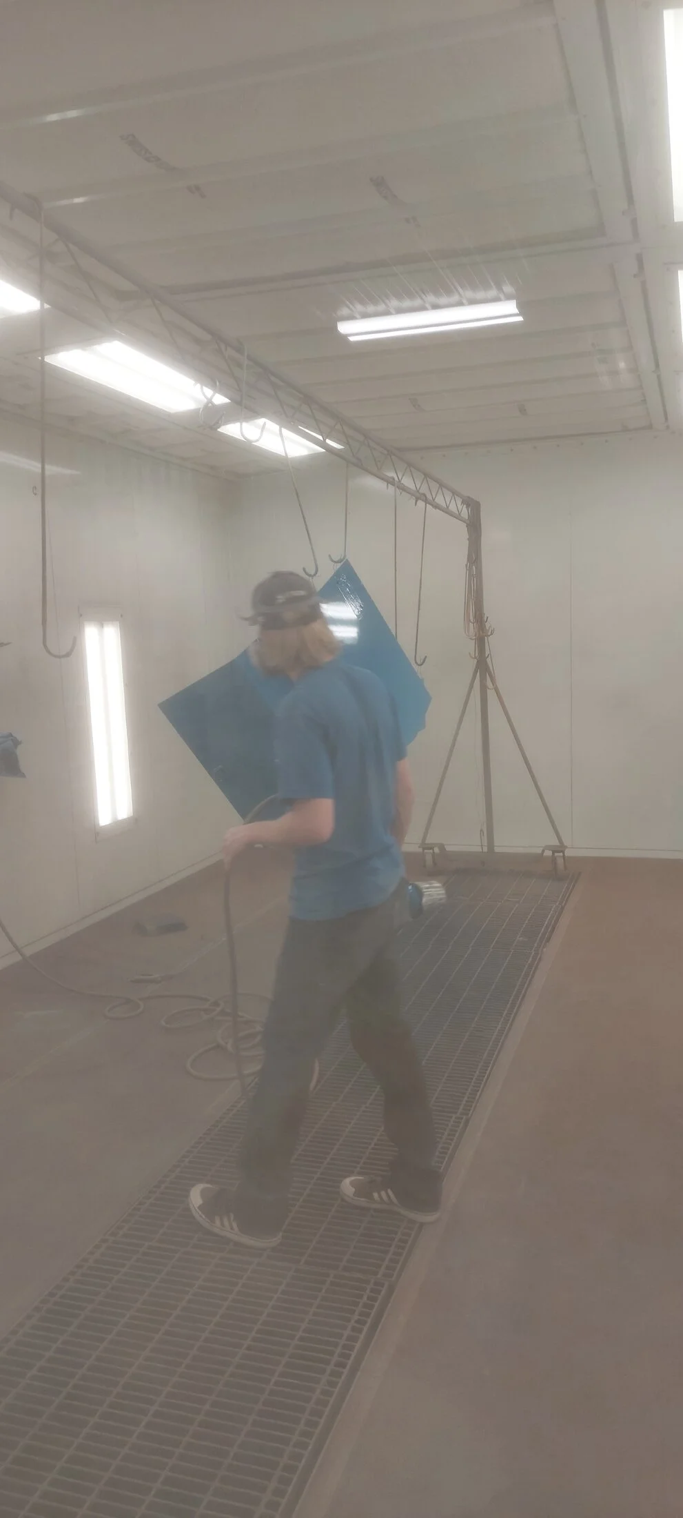

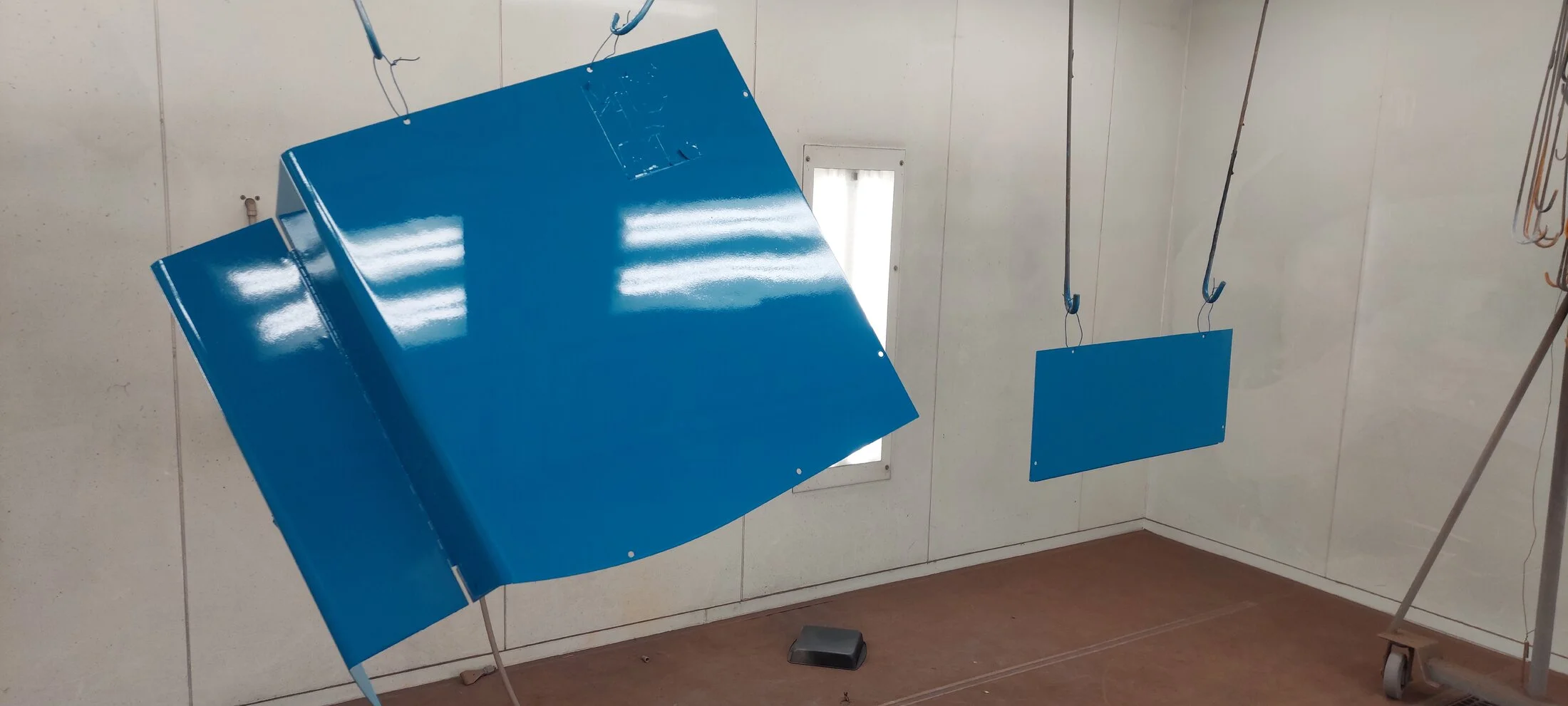

I also decided to paint the cases since they were all coming off anyways for the fan replacement. Whoever put the gray on laid it on thick and runny. It sucked to DA off.
This also had a not so great whip on it, so I replaced it with a tweco. These don't have the trigger problems like the miller guns, and I like the feel of them.
Painting the cases tonight, and then hopefully this thing will be back up to fully working status.
The welder is blue again!

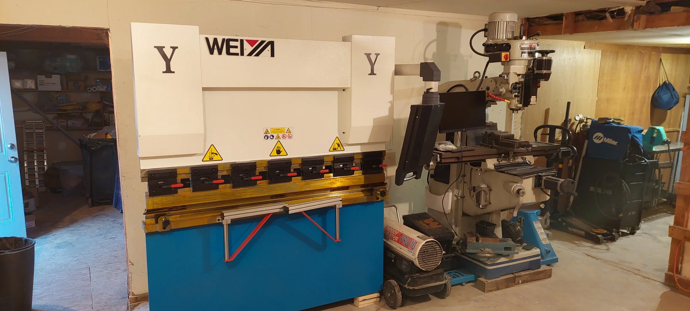

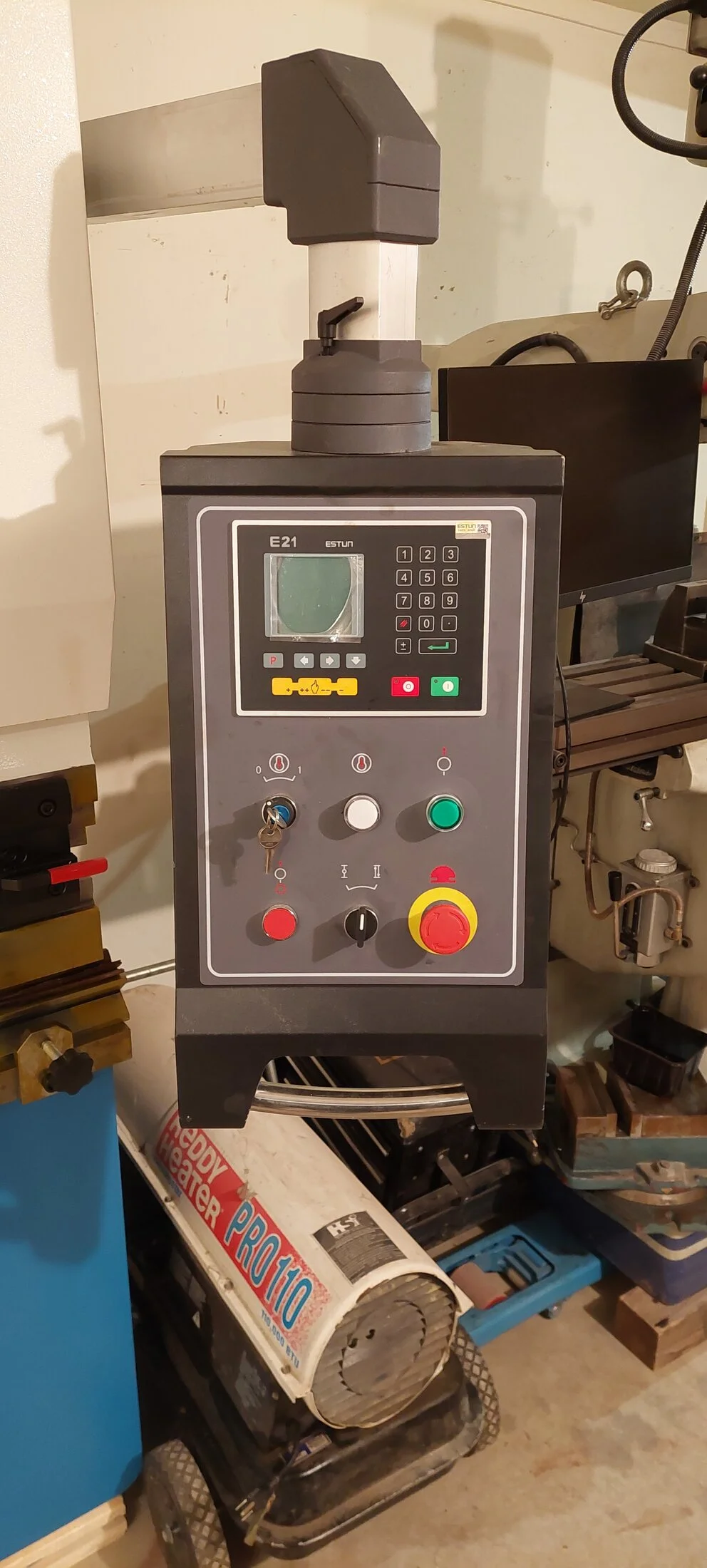

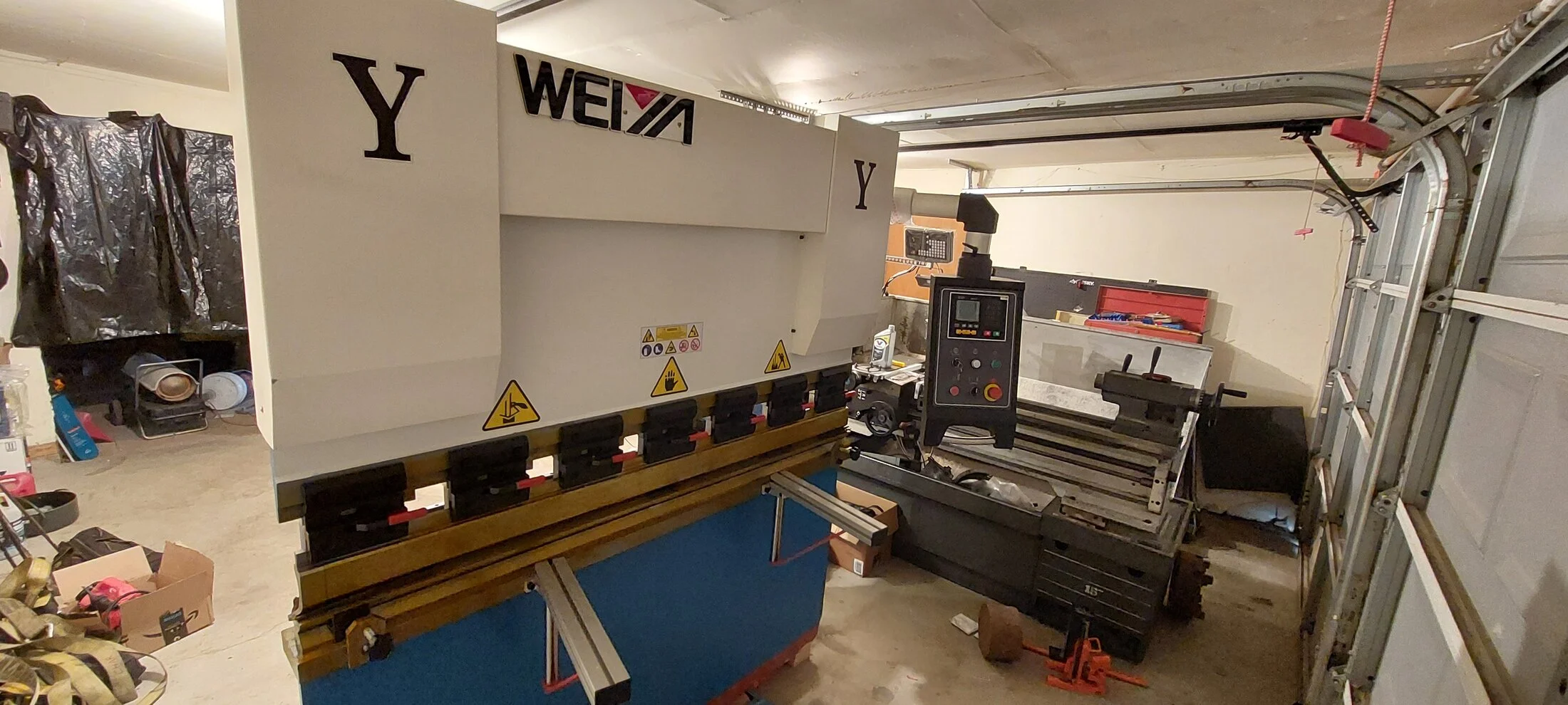

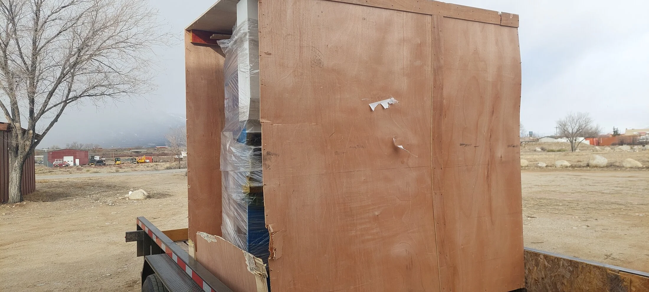

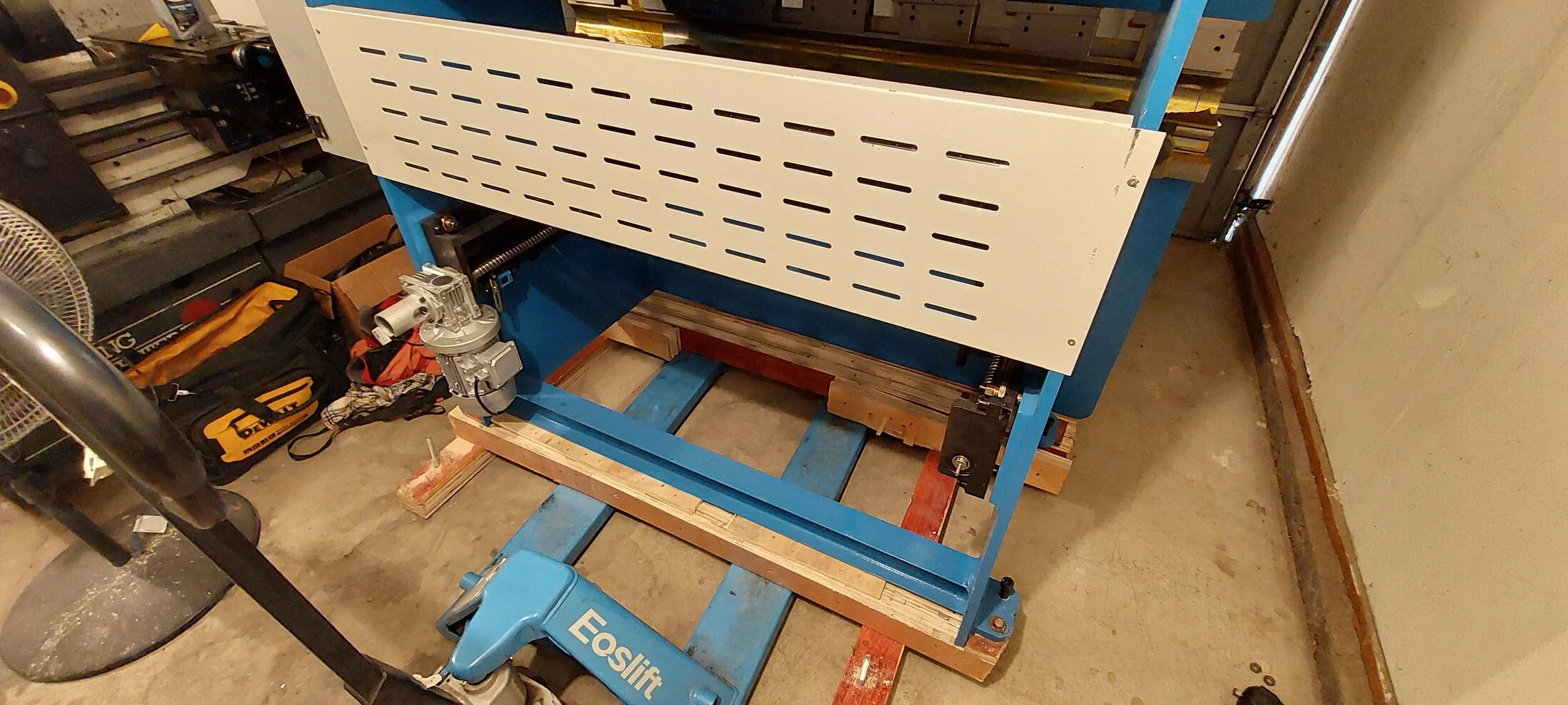

Well, the brake showed up! It is a 1500mm, 30 ton, full American style Tooling finger brake. A little light for some stuff, but for most fab stuff I do, it will be more than enough.

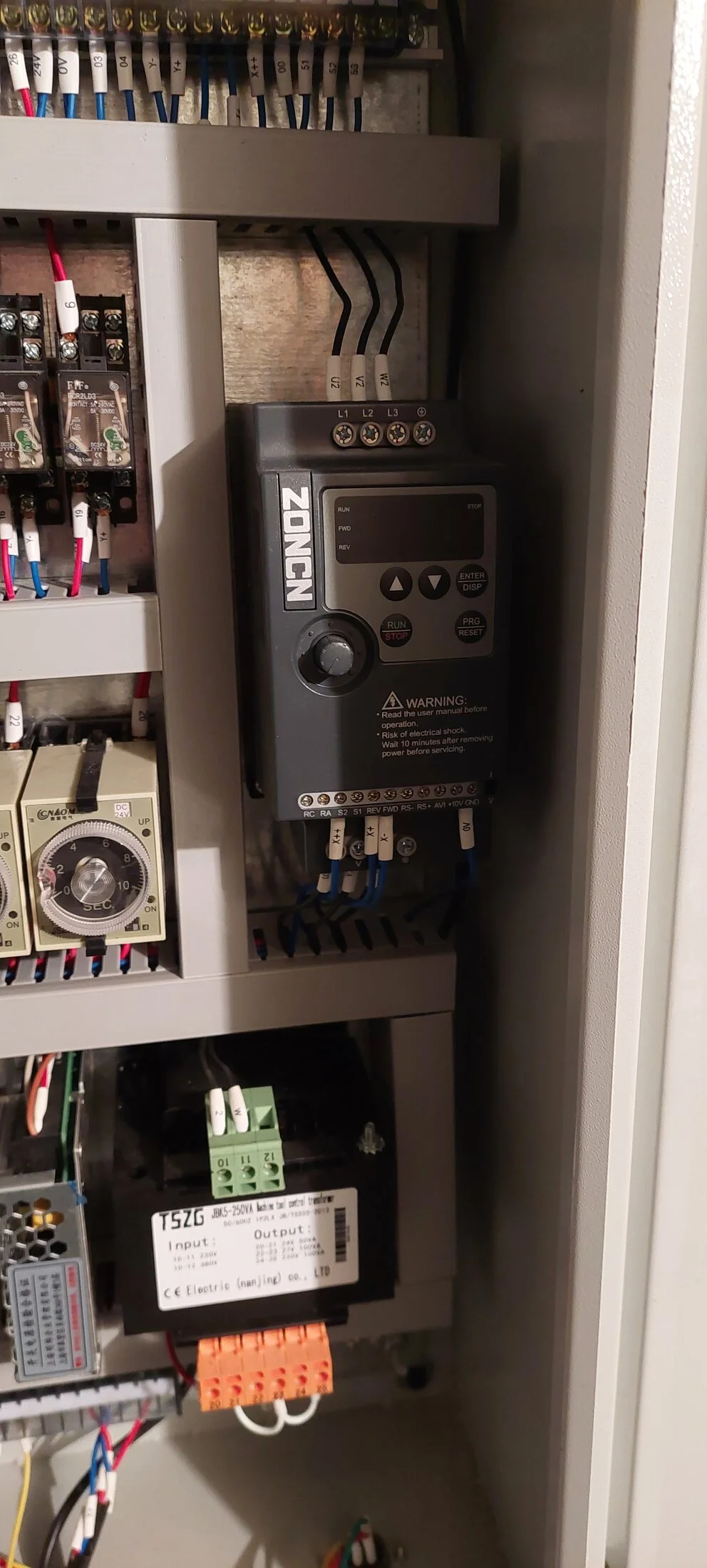

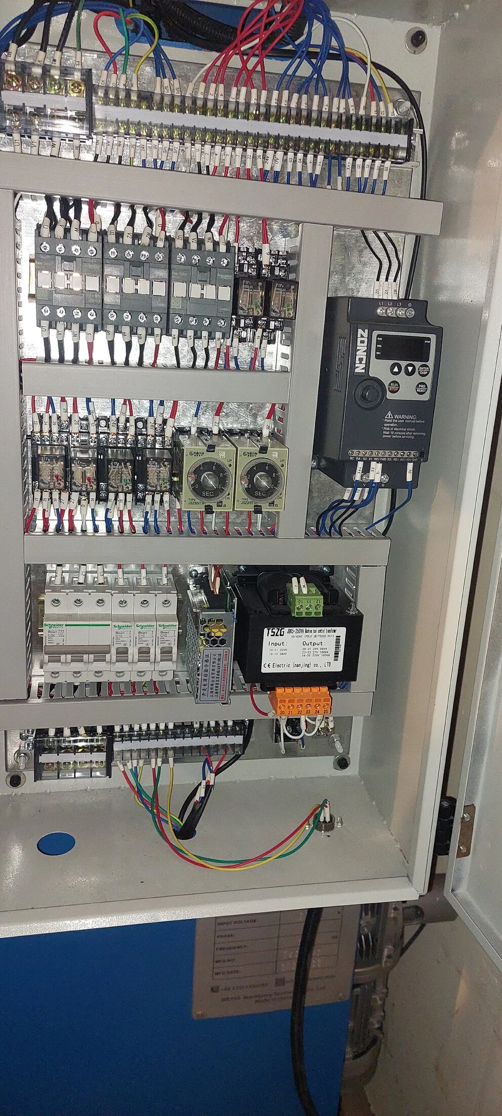

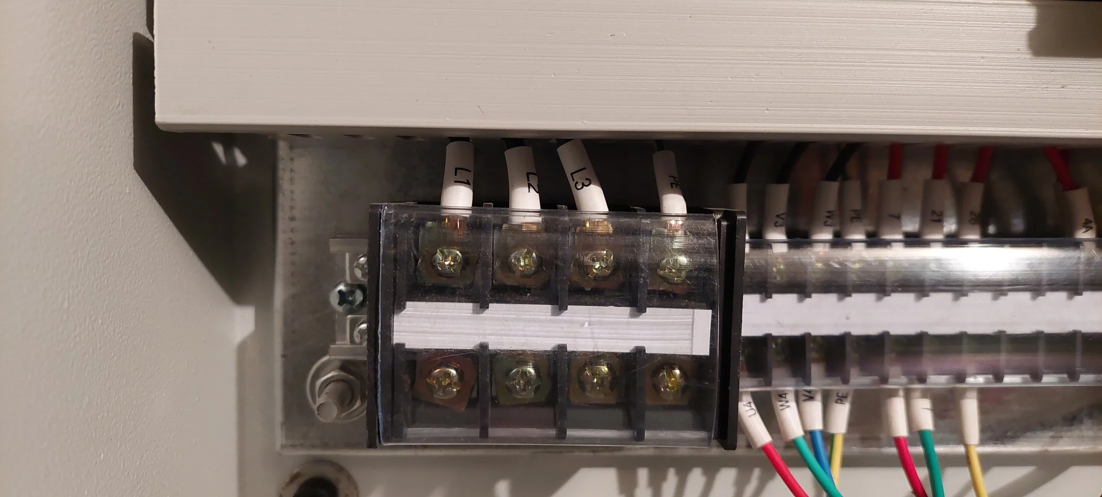

Slightly disappointed, I spec'd it as a single phase machine, but a three phase machine showed up. The company is sending me parts to convert it to single, but I have no idea what they are sending. Hopefully just a VFD.
The box looks great. I could hook up the phase converter I have, but I really don't want to always have to run this on a converter given everything else I have is now running on 220 single.
The machine weighs 3700 lbs, it was a bit sketch to get off the trailer. The poor little mounty was picking up the back wheel. I was able to suck it in after breaking down the pallet and it went smoothly after that.
This is now the heaviest thing I have, the lathe is about 3350.

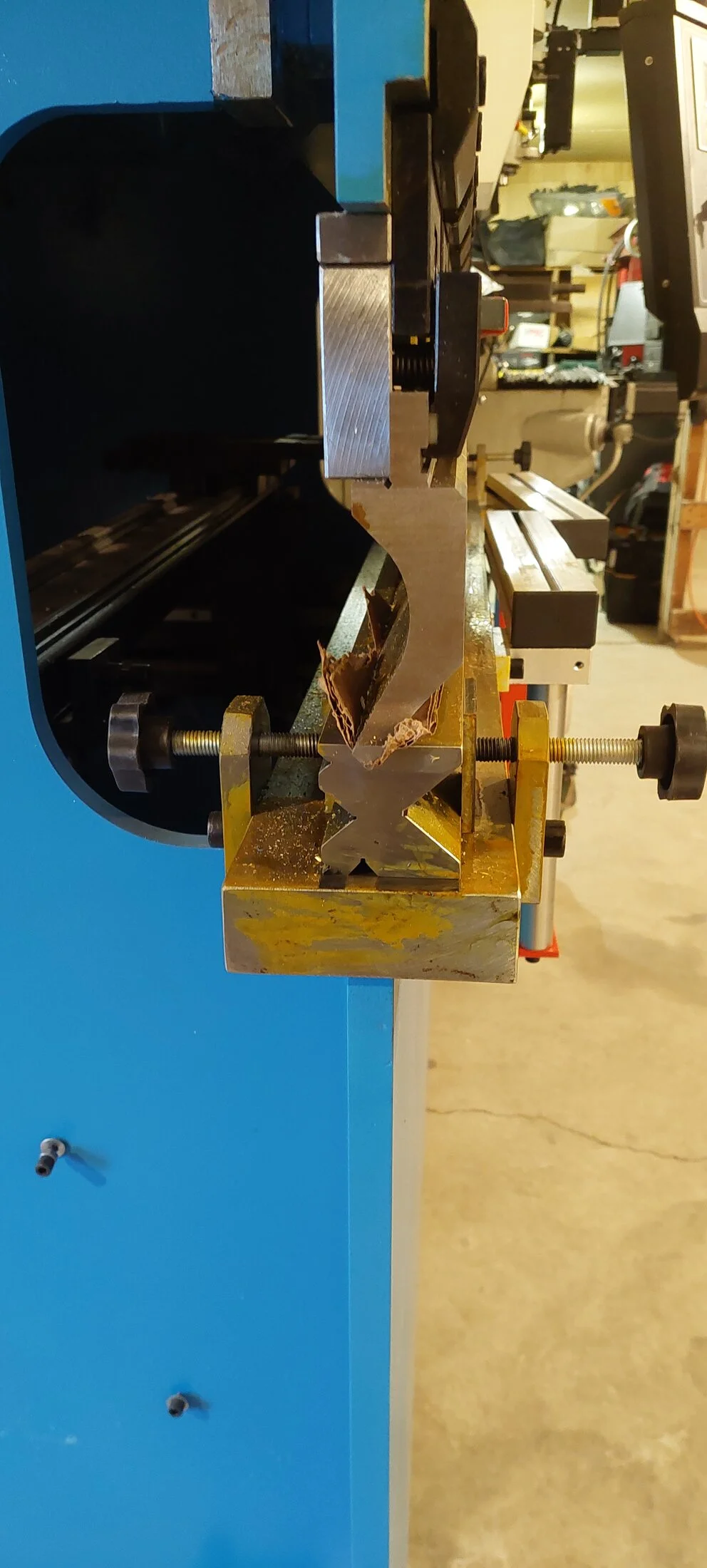

I spec'd this punch set and had it made. It is a nice little gooseneck, and the lower is set up for 3/16th, 10G, 12G, 14G, 18G, and 20G
What is super nice is the fact that the NC control is the exact same as the Piranha brake I used at school, so this is all known.
It has a full NC X and Z? Backgauge which is super nice.
Anyways, this was expensive, but I think it will be a very good machine. It was way cheaper than getting something pre imported in the US.
