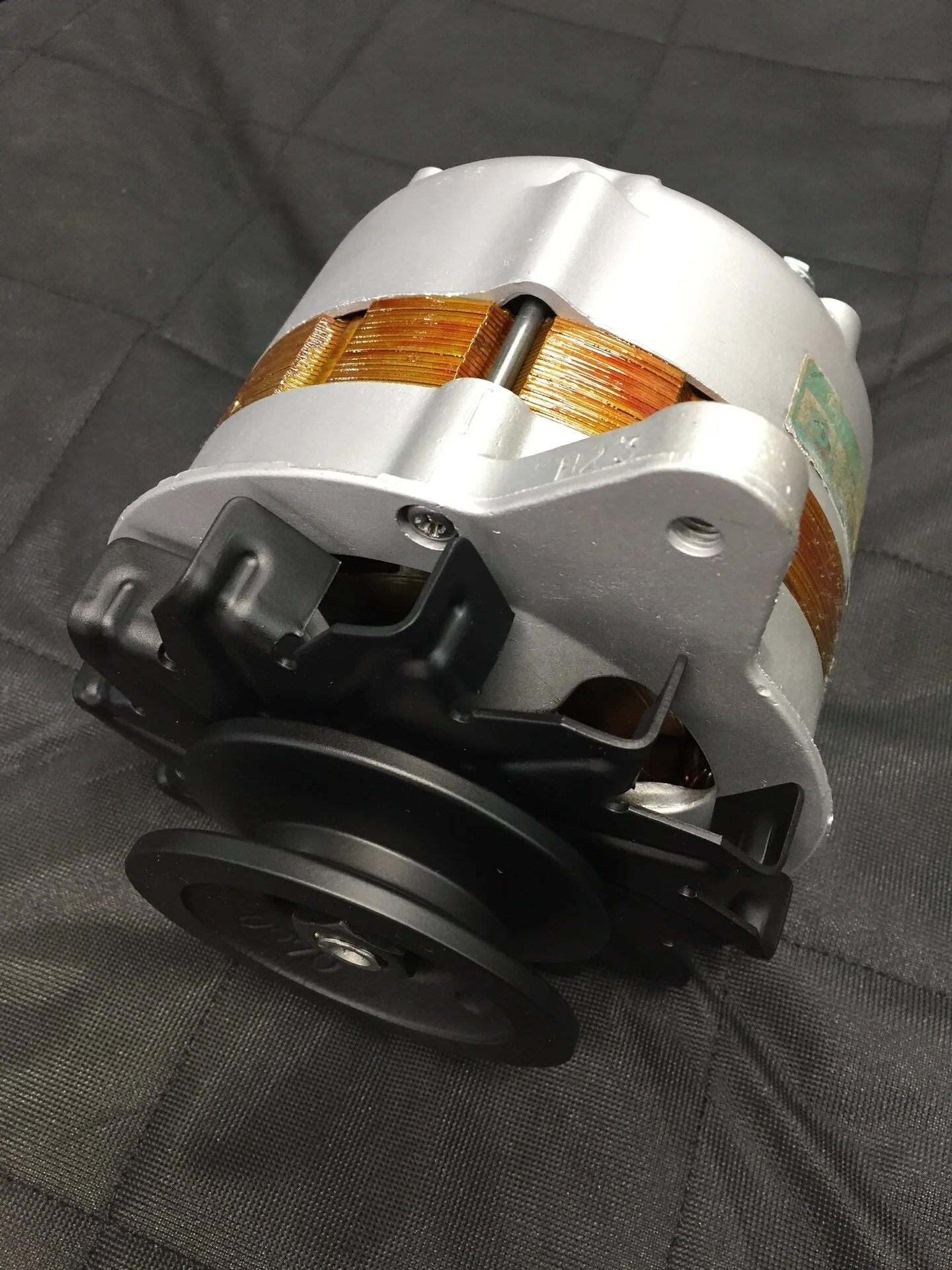

I would say you can give it a try with the stock alt and see how it holds up. I switched to an fj80 alt from @ToyotaMatt and it works great.
Wiring up an FJ80 alt is 100% separate from your Sniper circuits so you wont gain any work efficiency by doing both sniper and alt at the same time.

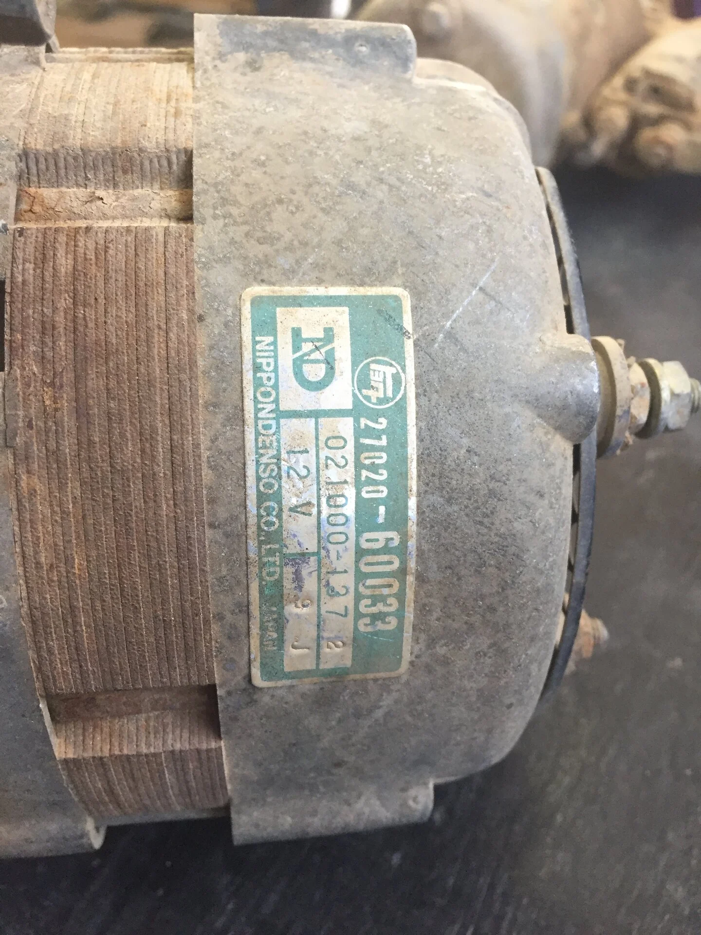

Interesting, the information was given to me by a vendor on this site. Possible the information is not correct or I misunderstood them? This is the markings on my alternator: View attachment 3523270
Interesting, looking up that PN it shows 40 amps, though some of the fork lift replacement parts show 45, and other pages show 55A alts as direct replacements. There is also 27020-60040 which lists as 69-75 FJ40s and 55s showing 55amps. Now I am curious and going to have to check which PN I took off. 🤔

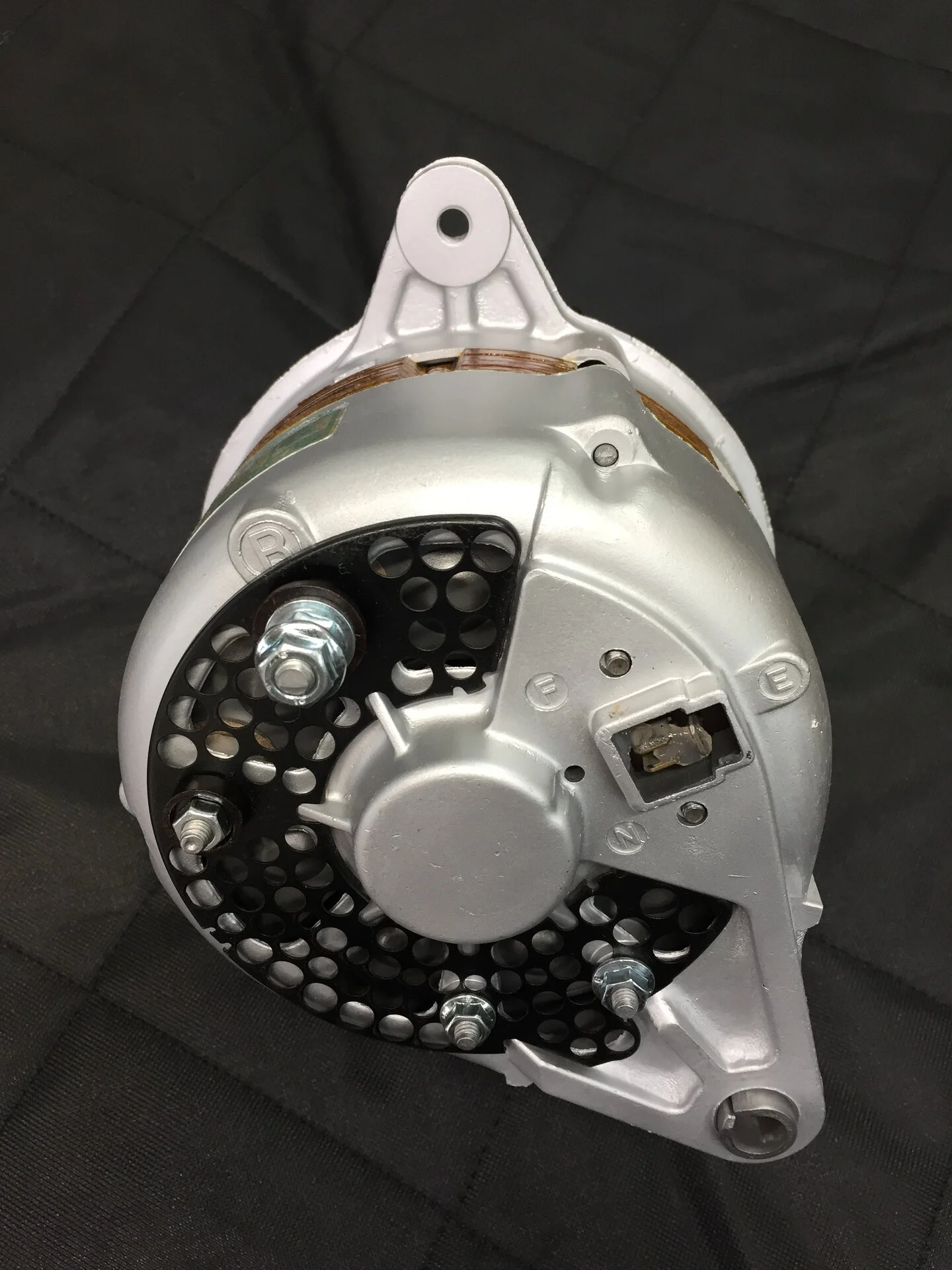

FWIW - If you are going from an alternator with external regulator to one with an internal regulator, < click here > for how to deal with the voltage regulator plug/wiring.

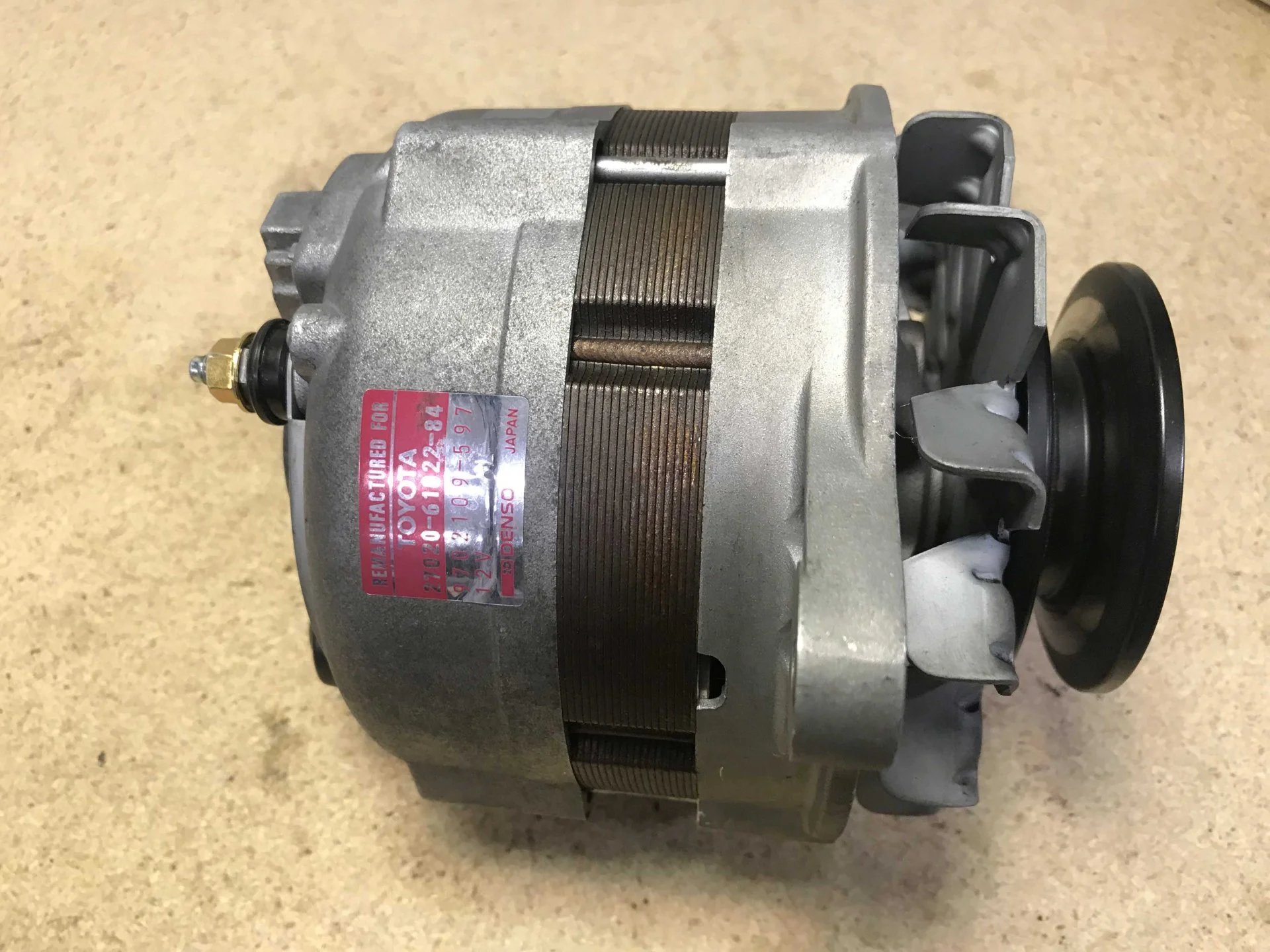

With my Sniper, I'm running the 27020-61022-84 below, a 12V - 50A unit I had rebuilt.
But before that, I was running an OEM 27020-61012, 12V - 40A unit with the Sniper for a few years with no issues.

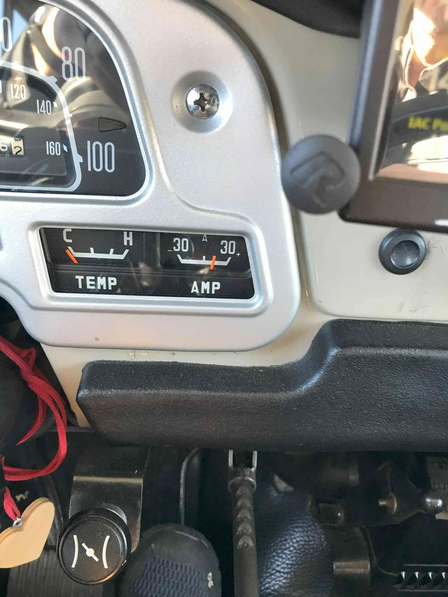

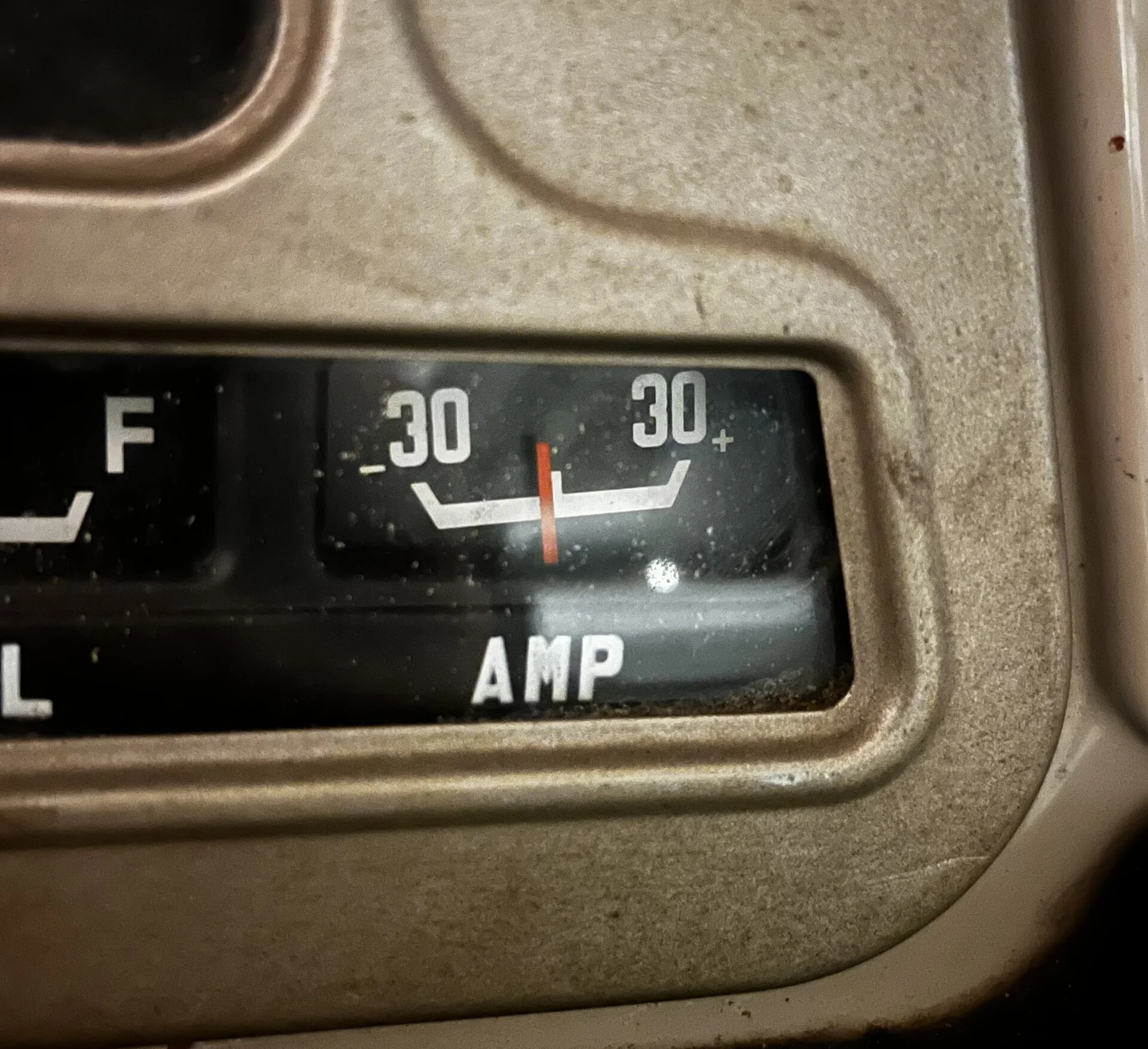

Thanks for the info. What did you do with the amp meter in the cluster? Mine is -30/+30. Was yours a 50/50 meter?
-30 / 30+ ammeter is still in service in my gauge cluster. Also has the original main harness, but do run a set of LED headlights right now.
All reassuring information, thanks! How did you address the temperature gauge for the cluster and the sniper? Because I’d like to keep the cluster temp gauge operational with the Snyper I’m thinking of adding an additional sensor in the head. Am i overthinking it?
