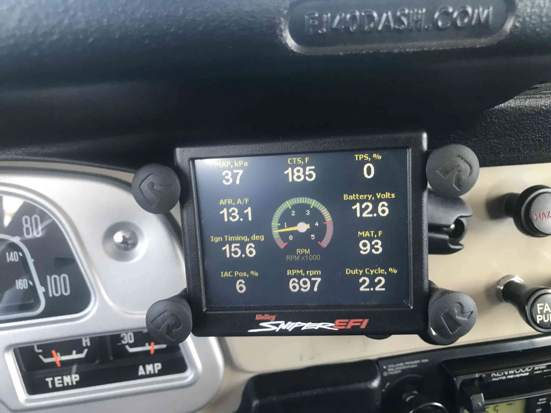

Being that the head uses the OEM sensor to the OEM gauge, I'm not sure of what difference (if any) in temp between the two. I will say, during typical driving conditions, my Sniper reads around 185 (+/-) consistently. Being that I run a 190 degree thermostat, seems the Sniper is reading an accurate temperature. None the less, I never really put too much thought into the Sniper location/reading, just so that the sensor would get above 160 degrees it all that really mattered.

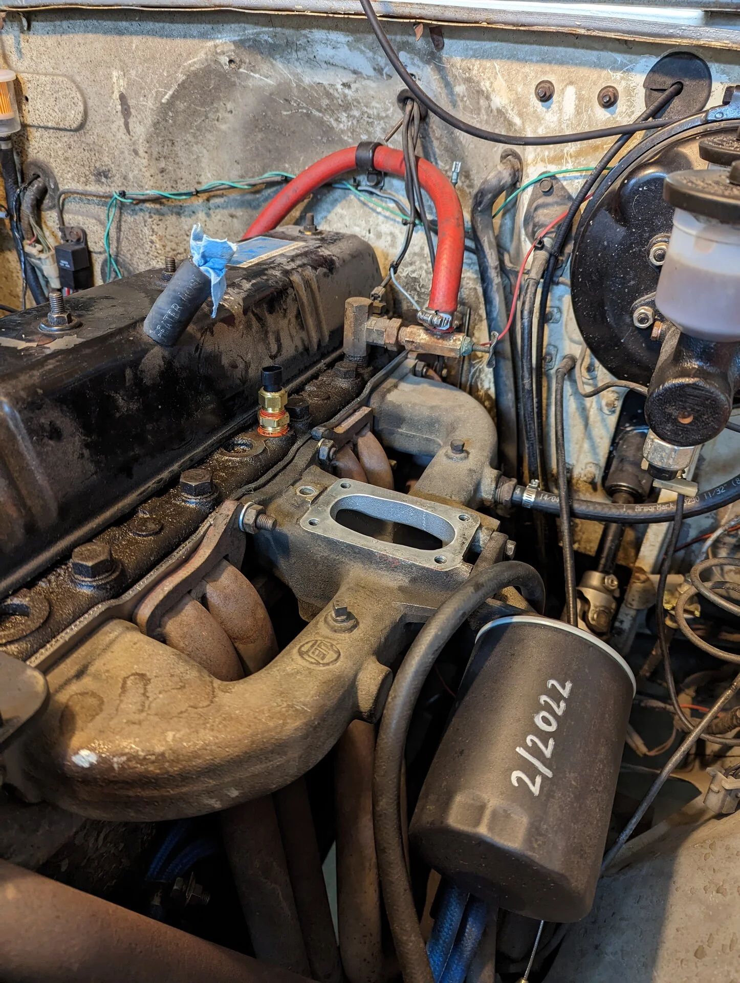

The OP has a 72, so assuming original engine there should be an unused sensor port in the head that will accept the Sniper temp sender without messing with the coolant drain. @GA Architect I am sure the coolant drain location is FINE if an extra port isnt available in the head!
Photo from my Sniper install thread, note the shiny sensor next to the center of the intake manifold.
Yep, if the cylinder head on my rig had the extra port, that is where I would locate it fo-sho.
My configuration is exactly like the picture above. Prior to the engine rebuild only the rear 2 ports were used. I'll use the 3rd spot with the reducer in the port near the center of the head. Thanks for the information!
Could the earlier heads be tapped for the sensor? If I recall there is a boss. Then it could be done to the Sniper thread spec and eliminate the need for a reducer.

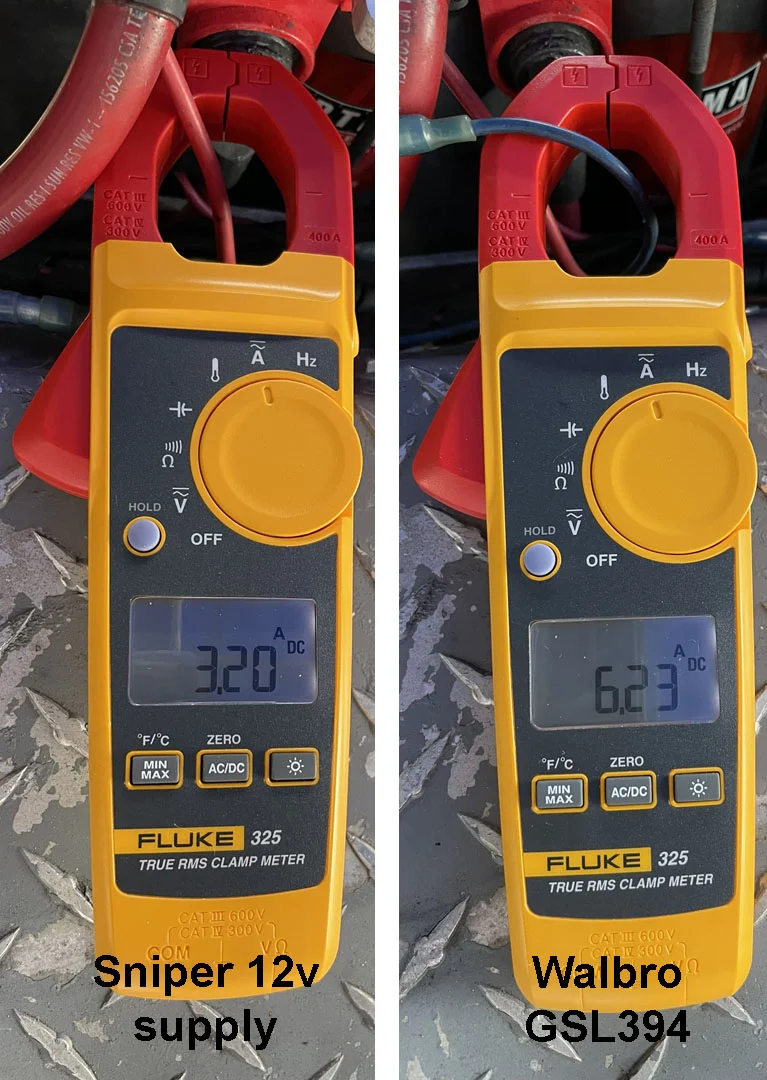

I just put an ammeter on the Sniper main 12V supply and the fuel pump. The fuel pump is powered through a relay within the Sniper harness, so I measured separately and added. Total, 9.43 amps DC.
This information gives me more confidence the -60033 will be sufficient for my needs provided I'm not adding anything to the system. Thanks!
Nice meter!
Thanks. It sure is. A bit pricey & I pondered over getting it for a long time and only recently went for it. What’s weird is, I have used & owned AC clamp-on ammeters/Amprobes since my childhood and throughout my working career but all that time I was believing that a DC clamp-on ammeters did not and could not exist because the induction field in a DC wire does not move (when on). Also, I just never noticed them in any catalogs. I was an old man when I just happened to find out different. It is my 5th Fluke meter and like it the best. Besides the Fluke hygrometer, this could replace them all.
