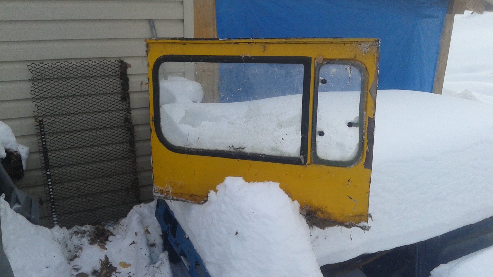

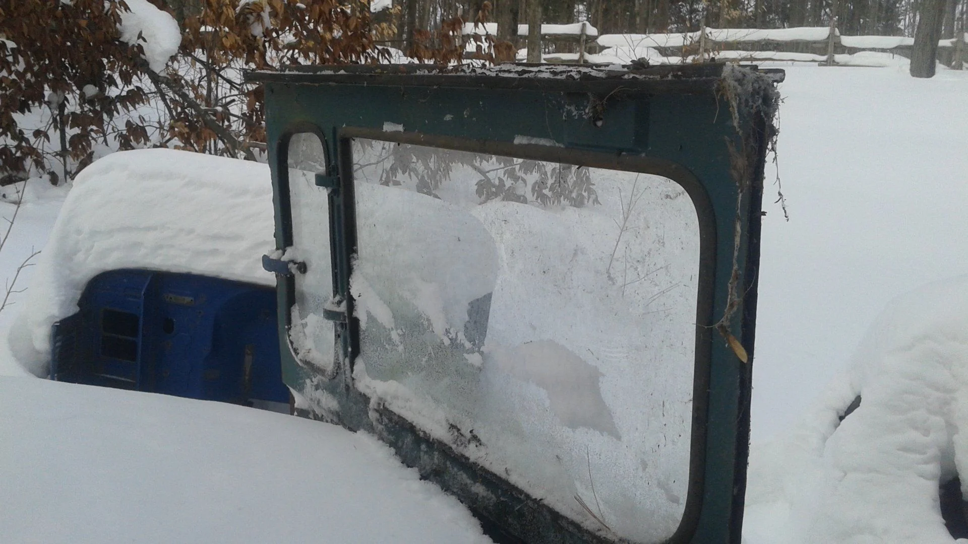

the yellow lines on the pic is the cutting line for the side panel
this is someting i will do with a rusty used top
Those tops are sooooo hard to find... I'd hate to see you cut yours up.

this is the part that would be removable in my plan

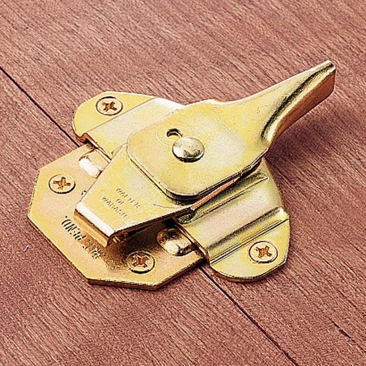

Perhaps you could conjure a tong & groove alignment on each side, on the inside, that the removable piece aligns back flush & square, and with a rubber seal, weather tight to the rest of the remaining-in-place top's side. And perhaps on the inside you could draw-tight the removable section with the remaining-in-place top's side with fasteners along the likes used underneath extendable dining room tables, where table leafs are added-in, and the table rejoined.
