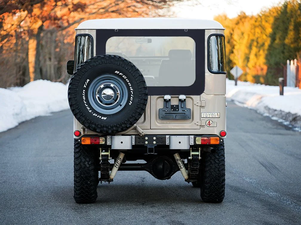

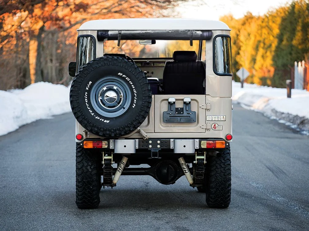

I Must Ask, cauz the concept has long been on my mind : a Good idea or Bad... and/or ... Why Not ???
The Haartz material would be attached to the hardtop up underneath the metal gutter of the fiberglass roof cap, between the roof cap and top of hardtop sides. When unrolled, it would bond to the metal of the hardtop, to each side of the window and below the window, via flexible magnetic strips sewn into the Haartz material. The high-quality, clear vinyl window material would be bonded to the fabric Haartz material along the same lines of fabrication as any professionally manufactured soft top. For further weather-proofing, a very small flange would be created for the inside bevel of the hardtop opening - hindering the potential ingress of moving water, vapor moisture, and unwanted airflow. For augmented security, a pair of nylon straps would be added on the inside bottom of the roll-up window, which would clip to the inside of the hardtop.
When each of the three windows are rolled up, I see this concept (with the OEM hardtop) creating 'almost' as much open air space as would an OEM styled soft top. To me, the concept would be significantly less expensive for the owner of an existing hardtop than that person obtaining the needed bows and actual soft top - for an OEM styled soft top. And the concept would of course maintain use and durability of an existing hardtop, albeit with the new functionality of a soft top - without significantly molesting the hard top with the roll-up window material. Hence, the side glass and ambulance doors/rear hatch could still be easily reinstalled.
To reveal to you what is envisioned in my mind, I created (via Photoshop) for this thread a four-image illustration of my roll-up window concept, shown here, from a '78 vehicle that was previously on eBay :

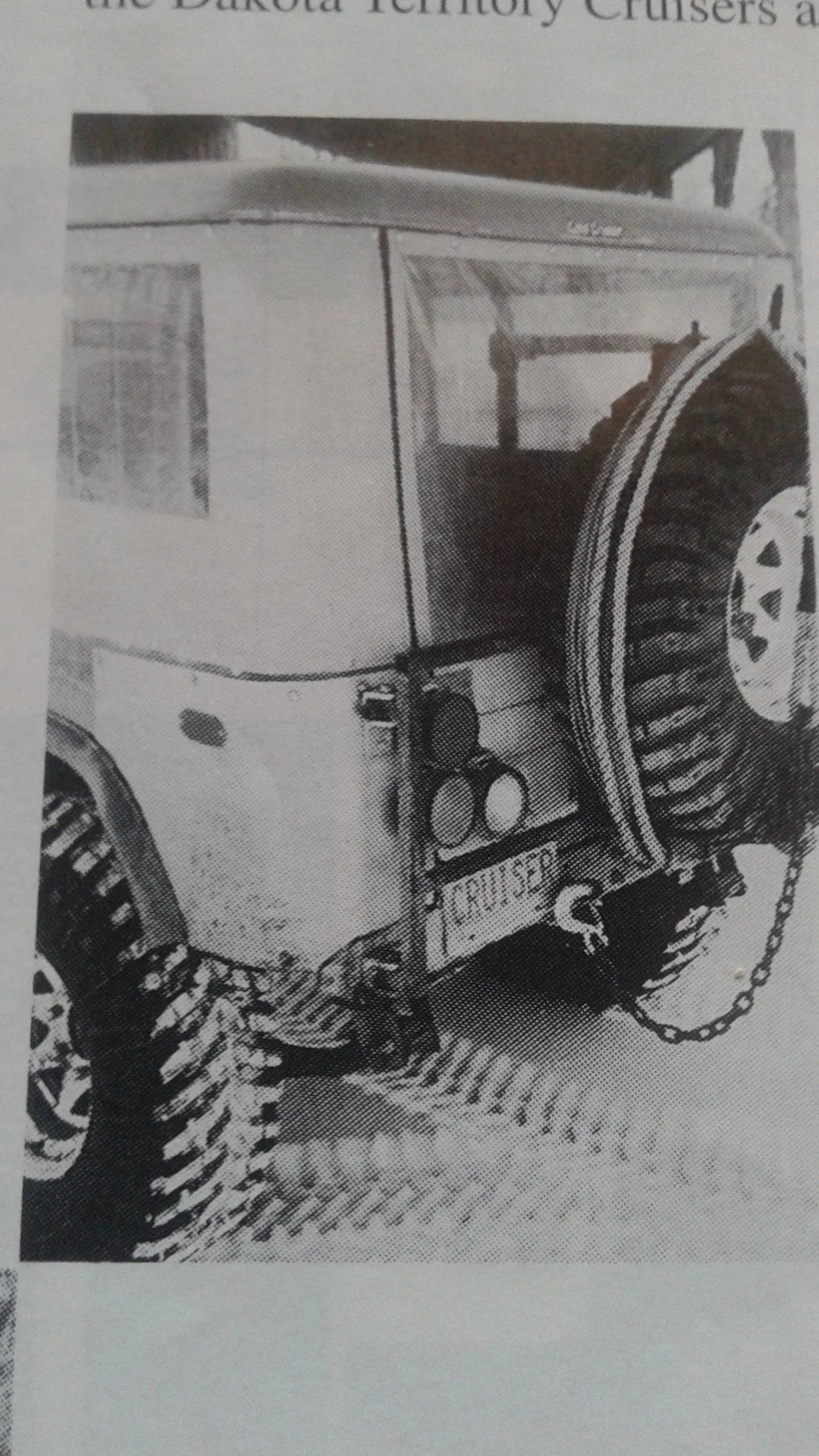

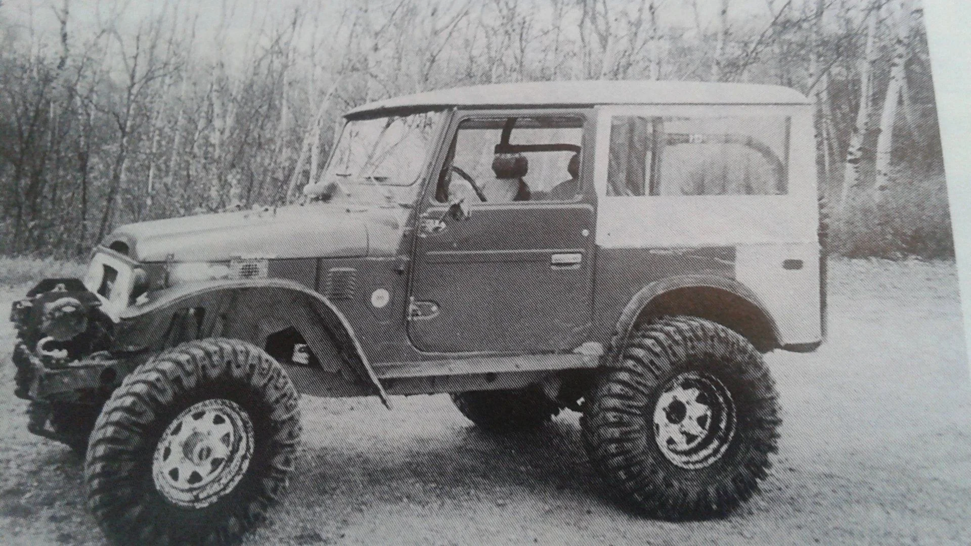

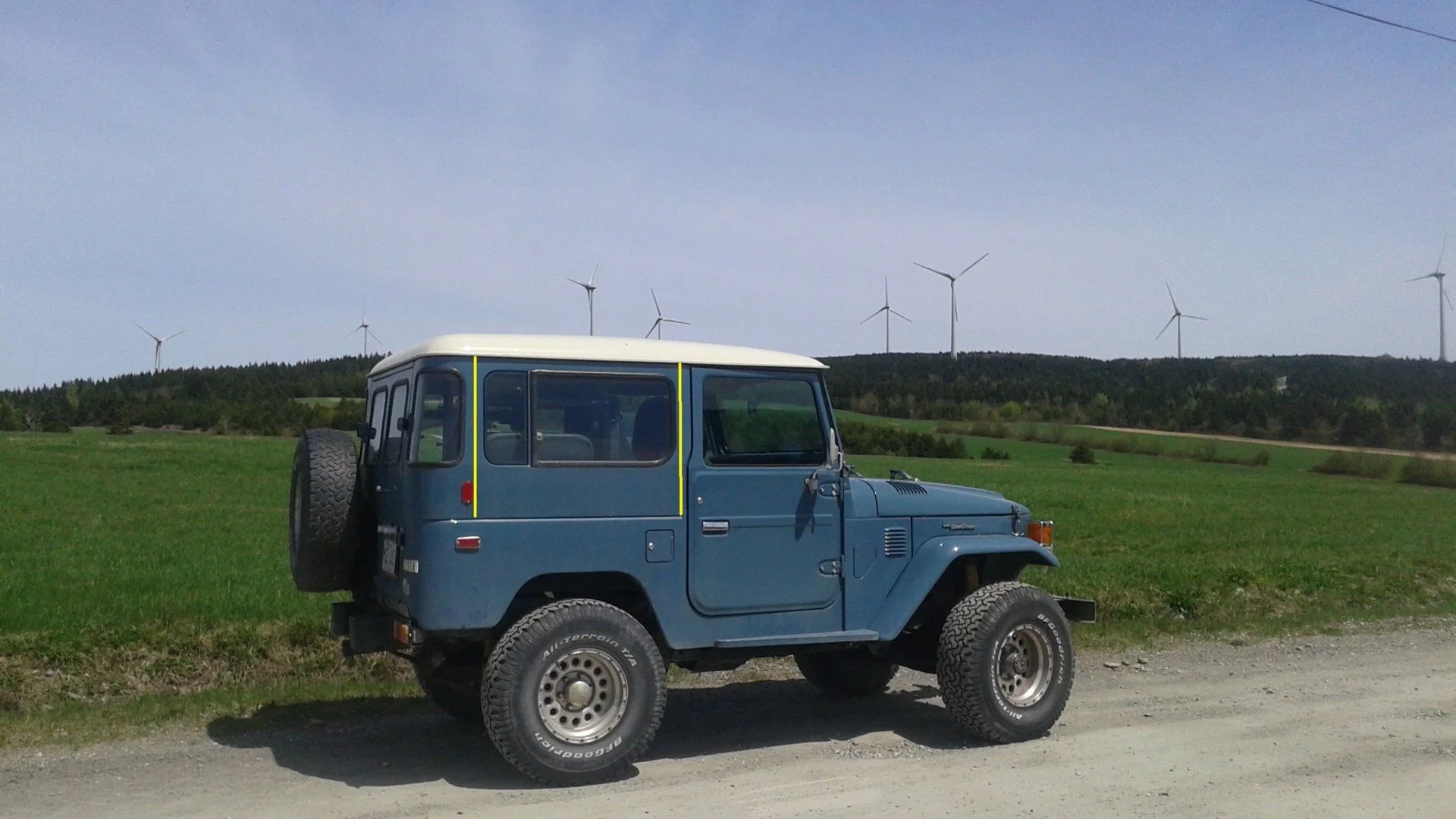

if i make one in the futur , i will keep the corner glass and make the side panel removable , so you can switch from hard panel to soft one , maybe a hinge on the side pannel so it can open up as a lid
the yellow lines on the pic is the cutting line for the side panel
this is someting i will do with a rusty used top
i like the idea of using the roof cap with soft sides and rear
i found those pics in an old toyota trail mag
I recently saw a color image of an OEM fiberglass roof cap used with soft top material on the three sides, just like your pic shown here, but a more modern pic. I don't know where it was that I recently saw this - I'm looking for it.

Hey Pete !!
What I have envisioned & in mind, for my concept, would be a roll up window that is most definitely weather-resistant : for cold, for moisture, and for air flow. It would be more weather resistant than an OEM styled soft top. And likely far more so than that of a Best Top. I have envisioned a specially fabricated rubber gasket / weather strip that would fit on the inside of the opening of the window and would augment seamlessly the roll up window, both on the sides and at the rear. For temperature control, I have envisioned the use of a second clear vinyl window, that adheres magnetically on all four of its sides to the inside of the rooftop wall. In essence, for cold weather environments, an optional system of the use of two transparent vinyl windows, with trapped non-moving or very slow moving air in between the two vinyl windows, which will naturally help further with the properties of insulation.
Jim :
If hinged, you're speaking of like on a Highlander or Piper Cub ? ... to serve in part as a small awning ?? ... I don't see how it could open to the inside - with roll bar, etc. As you know, things are pretty tight on the inside :
