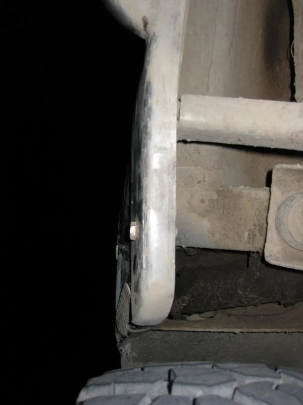

Mine are mounted with bushings at the frame end. Only because the guy I bought them from said it was a good idea and I went with it. It's bolted to the body too. I've beat the crap out of them for 5 or 6 years now and there's no rocker damage on my Cruiser.
Most I've seen aren't mounted with bushings though, so I don't think you really need them.

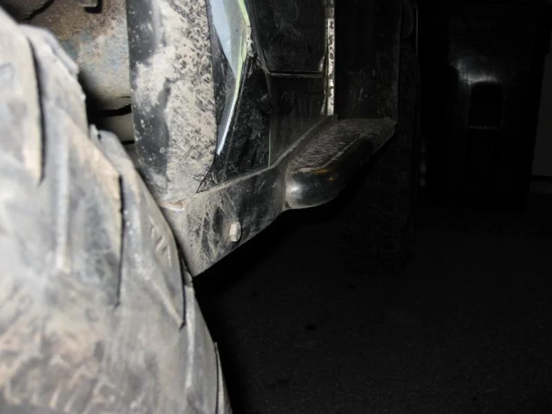

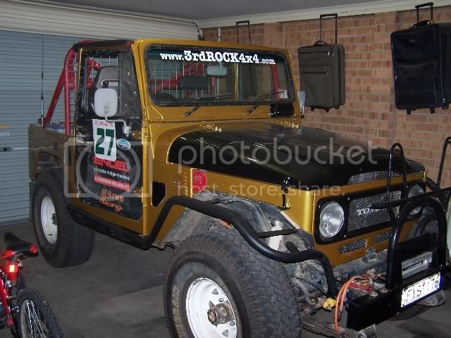

Best pic I can find side on, on the old paint job
Hard to tell in the pic but they tapper in to the back like the original running board.

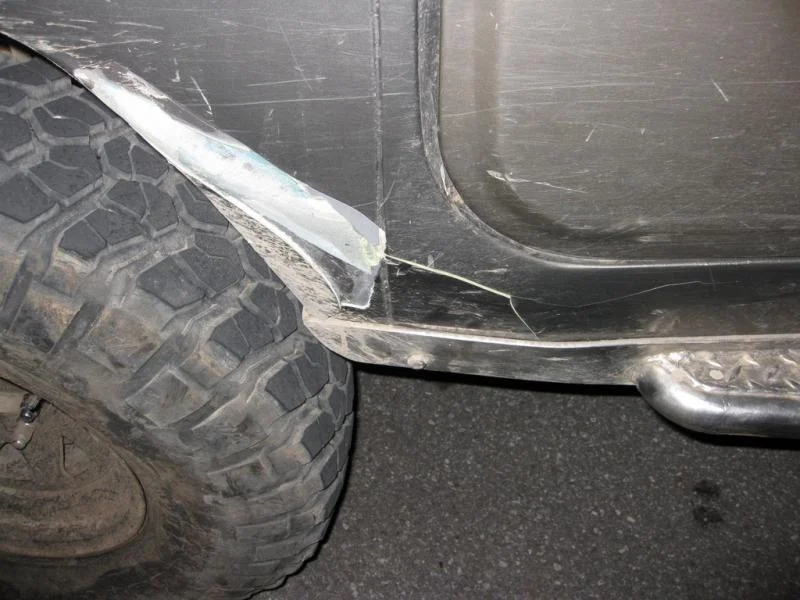

Biggest impact thay have delt with was at the Alpine Challenge
Result minor scratch to the paint work Daz was trying to avoid a tree

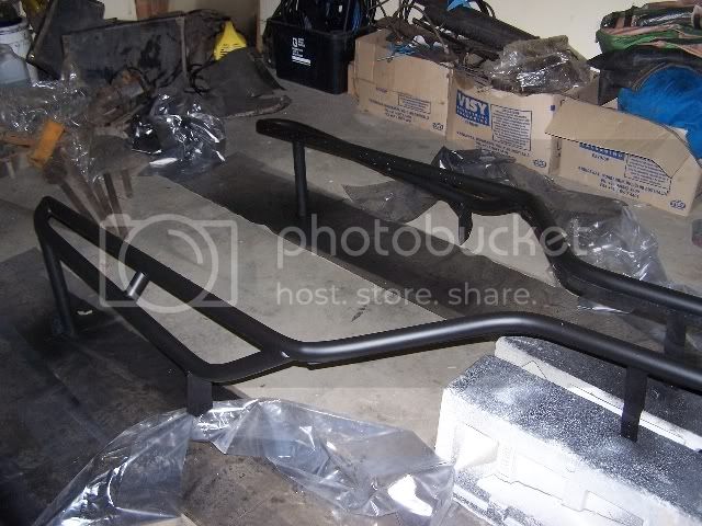

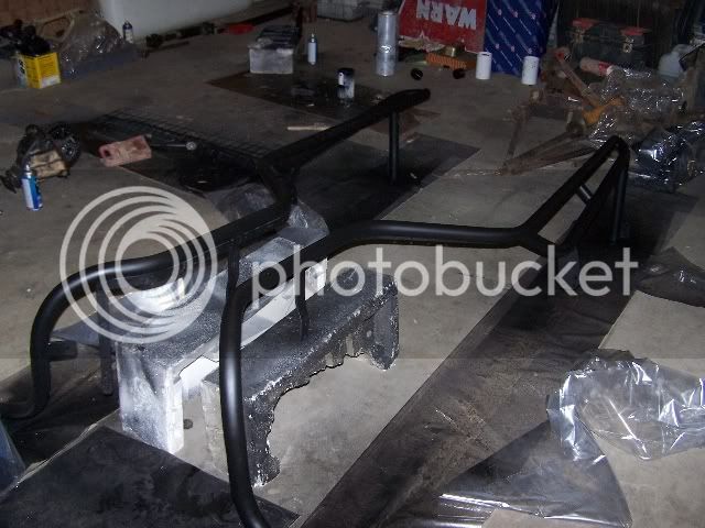

Well i've started,
I try to keep the original Runners size, i will cover it with a 3/16" check plate, Should look nice. I'm still undecided to how i'll attach it, to the frame of the body. I know some will say i should have gone with the tube all the way back, the rear section is weak, etc...But i think with a good support in the back where there are no tube it will be fine.

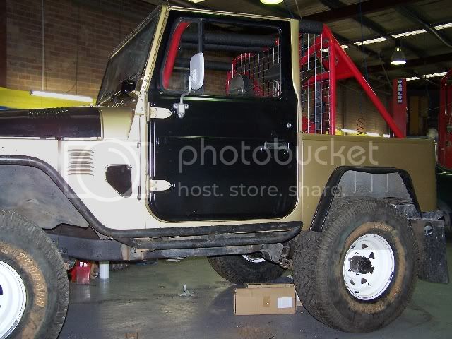

Finally installed
main.php
Brace to the body is missing and will be done soon.
main.php
Well, went wheeling today, and smack the sliders, nothing like testing your design and share experience. But i have to say i went hard at it :hillbilly:
And i didn't end up using the winch! :grinpimp:
